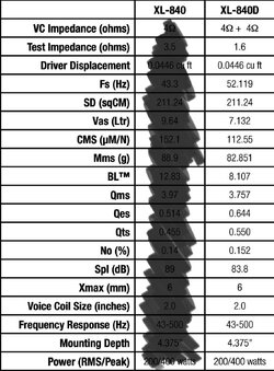

is there anyone who can help me with what size enclosure I need? The max size I have is 32” width 12” high and 14” depth
would they be better firing up, port back? This is the sub spec
It’s a convertible, 32” width 12” height 14” depth is the largest dimensions I have to work inside
EBP on those subs is about 80 which indicates that a ported box should be used. I don't like the fs being so high at 52hz, don't expect much below 40hz with those.
I would go with about .6 to .75cf per sub and tune them around 40-42hz.
