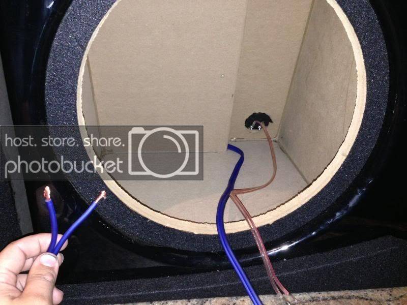

What's up everyone. I have 2 Sundown SA12's and I bought a temporary pre-fab box. It's only for a month or two so it's not that big of a deal lol. Anyway, the box came with 2 terminal cups with some really thin speaker wire attached to them.
My question being that I fished 12 gauge KnuKonceptz wire through the port.
Will this be a problem? Other than looking bad? Also, my subs are bridged down to 1 ohm, so I have to drill a hole in the inside box wall to feed the wire through and re-wire them up. Is that a problem? Is there anything else I can do?

I know. I really didn't want to buy a prefab but I didn't have a choice at the moment :/. The wire is connected to the cup with something I've never seen before. The connector is strange. The subs are wired to 1 ohm because of the amp. I have an AQ1200D. Is there a problem if I wire them through the port and just connect them directly to the amp?
It won't make any diff. And if you have to drill a hole, run your wire in and hook em up and then fill the hole around the wire with kaulking.
Any kind of caulk would do? Or do I need a specific one? So you're saying there won't be a problem wiring through the port right?

I really don't want to use the terminal cups because of what I've heard about them. Especially the melting stories lol. Basically I'd bridge them in the box and then run the speaker wire out the port and to the amp. Sound about right?

No no problem with that at all.
Yeah any kaulking will work. You can either drill a hole in it and run the wire through and kaulk it to keep air from pleading (make sure you let it dry for a while before you put your subs in. I let mine dry for 2 days just to be safe.)

Interesting. What do you suggest? Like I said, it's temporary until I can get a box built properly. I'm not too great with a saw so I won't be building it. Haha. Should I just run it through the port or do the bolts? I don't care about cosmetics at the moment since nobody will see it lol.

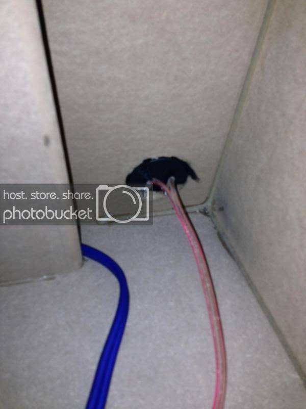

If you dont care about looks at all just run it through. Or drill the hole and run it through there instead of the port and it'd look a little bit better than through the port and if you just run it through the port it might make a bit of noise when you get some air moving from the wire hitting the box. I just drilled a hole in the bottom corner of my box a so the wire comes out underneath and you don't see the kaulk or hole.
I'd drill a hole cuz if you run it through the port you can sometimes hear the wire slapping the wood. If you drill a hole and kaulk it you don't have to worry bout that. And it takes less wire....

I'd probably just drill a hole in the back if that's the case. The good thing about working in a hardware store is an endless supply of supplies. haha. Now I need to go find some caulk to use.

Do it up!!!! You can just get a cheap little tiny tube of it for like $2 at Wal-Mart. You won't need much at all so don't buy a big tube to throw away 95% of the kaulking. Just about anything will work.
