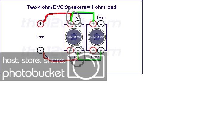

so it should really be like this right?
In the original it should like a splice, but this is just jammed into the terminal on the sub...
Thanks for the help guys
That is correct. Twist them together first, then jam the wires into the terminals on the sub. Inline splices should always be avoided. If you must do an inline splice. Split the ends of the wires into a "V". Twist each of the "V" halves of the two split wires together into one split "V", then twist the two haves together. Solder is always the best choice. If the wires are twisted togther well, then the solder will only add conductivity, not reduce it.

what type of crimp connector are you referring to? I don't want to do it wrong just getting some ideas. //content.invisioncic.com/y282845/emoticons/biggrin.gif.d71a5d36fcbab170f2364c9f2e3946cb.gif
It would depend on the connection, but if you simply want to splice two wires, a butt connector is the proper type. This is not doctorate level engineering here guy. This is $1.00 a pack assorted electrical connectors at Autozone stuff.
What I was trying to connect are 3 wires so the butt connector will not work that's why I ask since I never used one.
