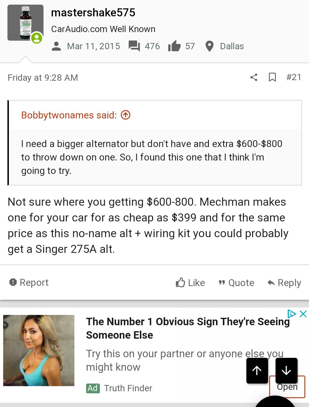

That's especially true with daily setups. If your not competing and just want to be loud then you'd be suprised at how little your actually truely pulling power wise
It's always the same story (cheap re-wound alt that runs hot, produces no where near the claimed amperage, and has awful idle output)
For a daily driver you can simply just turn the gain down and roll with stock alt + aftermarket battery and see where that takes you. If it rattles your entire car and the voltage doesn't look bad then just keep it the way it is.
If it's just for a daily setup then yeah not worth it.
I would do big 3 along with a good battery under the hood and then see if it's to your liking. If it's not loud enough and/or your noticing rapid voltage drops during your music then i'd do an alternator
Yeah sorry Bobby i'm not seeing the confusion. Pop even told you the same thing and you then started ranting about "$600-800 dollar alternators" and "my installer wants lithium, and this is too expensive" then you switched too "stock alt + big battery sounds like a good idea" and now it's "stock alt is pointless because I want to get everything out of my equipment".
You ignore the cheap options, then complain that it's too expensive, then claim stock alt + battery is the best bang for your buck, and now you want to drop the crazy money because you want to see all of it
Dude stop switching narratives and make up your mind. Funny that you play games then get made when people block you or call you out on being flaky. Accountability is key

You have huge headroom. All your amplifiers total over 300 amps which isn't even close to your stock alternator. Full tilt (maximum volume before voltage drop) you'll barely stress the amps
If you feel the need to block me, I understand. Like I said, I used to be around negative 250. And, I don't get MADE when people block me. It happens!
I'm not going to block you, I just want you to listen. Multiple good options have been given to you.
If you don't want to drop all the cash down all at once then do AGM with stock alt and see if your daily usage is stress via monitoring voltage. If your voltage drops too much or if your fine spending the money now to get closer to full tilt then multiple alternator companies that are specifically built for car audio have been presented to you.

You need a proper volt meter. Dimming can be voltage drop but it very well could be something else (weak connection or the factory PCM taking over). You new amp has more headroom + your going to have 2x the cone area so you should get louder off less power even on stock. D4S is afillated with excessive and mechman which are both solid choices
