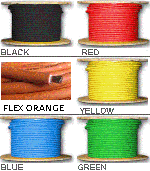

Welding Cable FTW. Cheaper than your overpriced car audio OFC, and better than CCA.
That being said, I just bought 100ft of CCA 1/0 lol. But i do have 100ft of 1/0 Welding cable sitting in the garage not being used. Wish it came in the colors i wanted.
https://weldingsupply.com/cgi-bin/einstein.pl?PNUM::1:UNDEF:OR:304-1170
