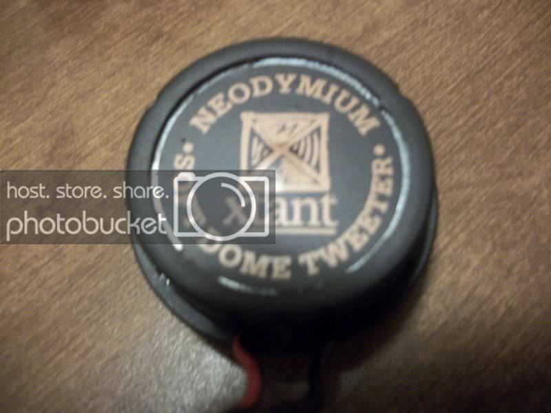

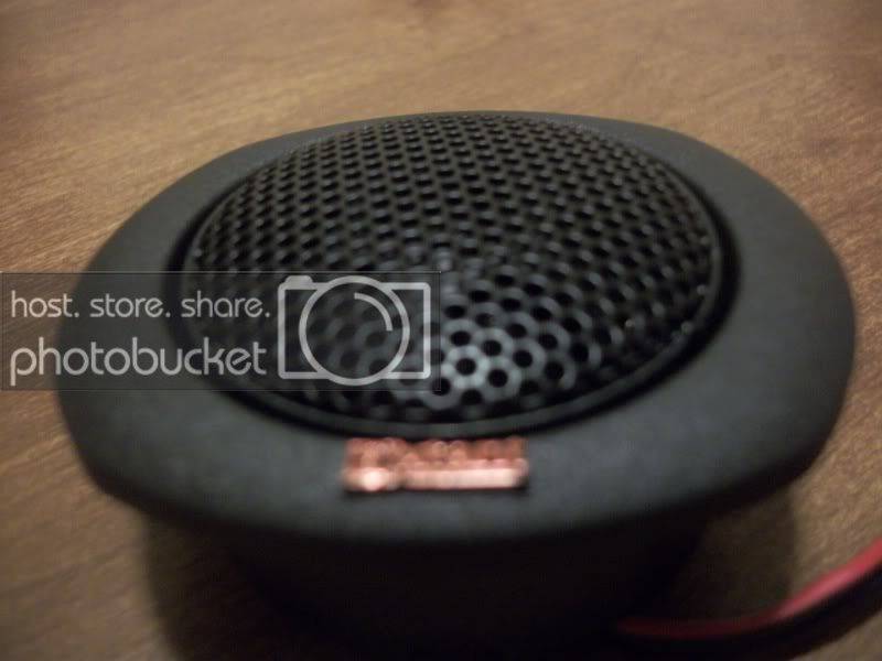

Front Stage: Morel made Xtant 28MM silk domes, Eclipse SC6500 mids, Eclipse SC6500 passive crossovers. All ran off the HU with the KTP-445.

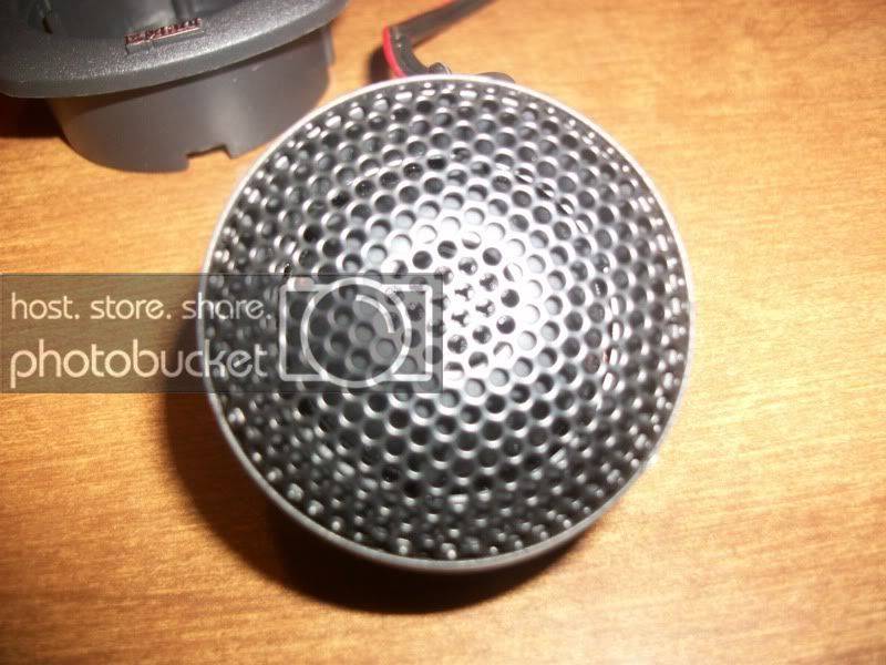

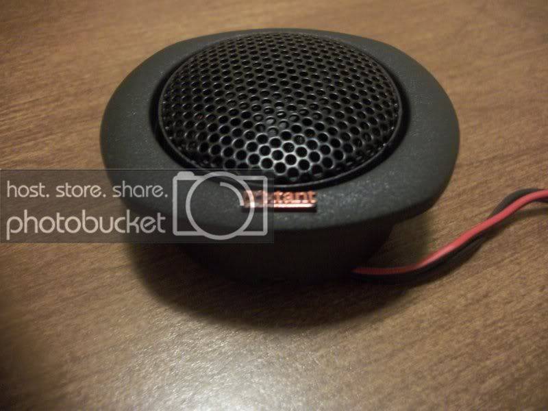

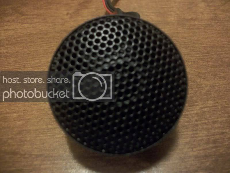

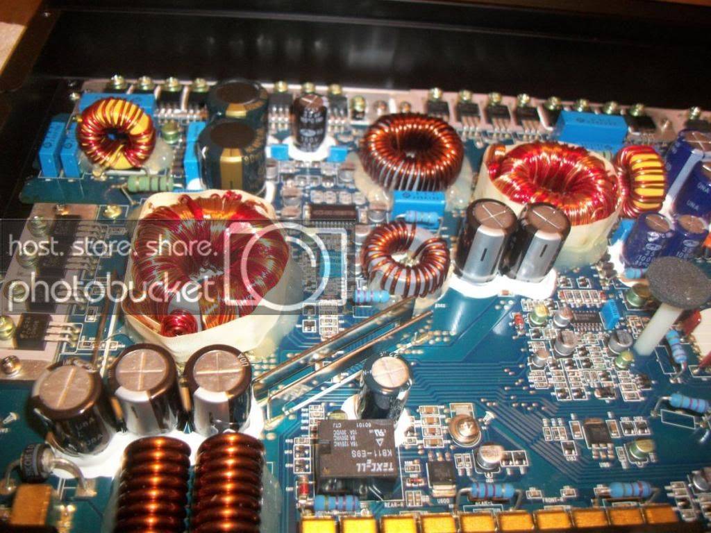

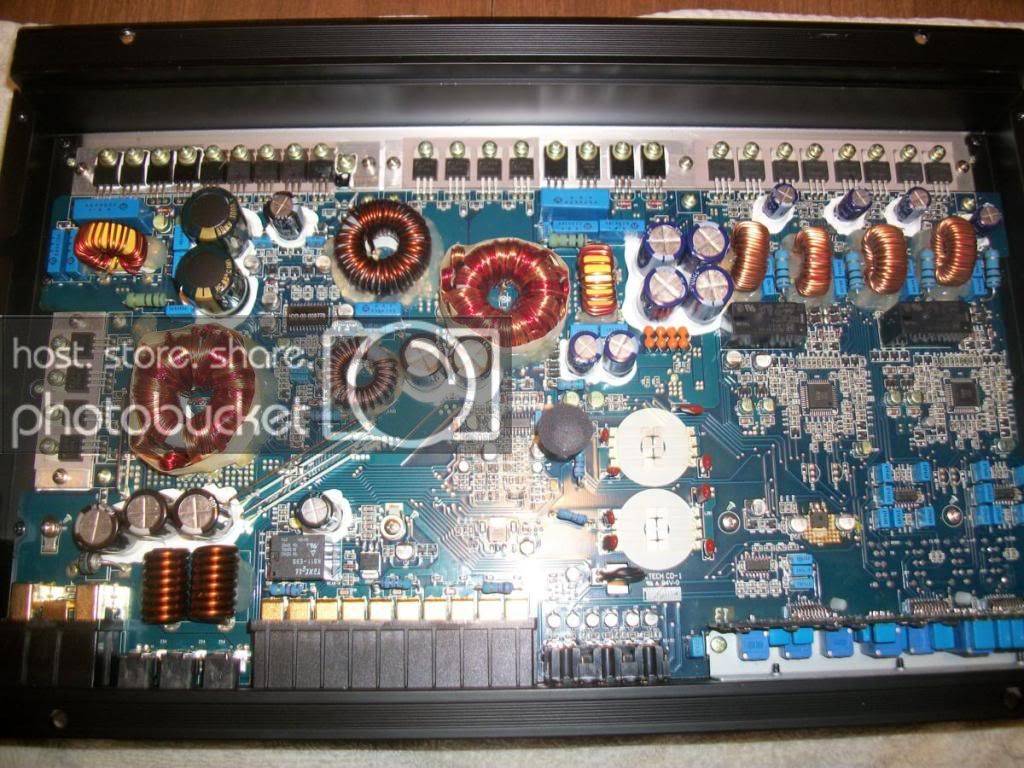

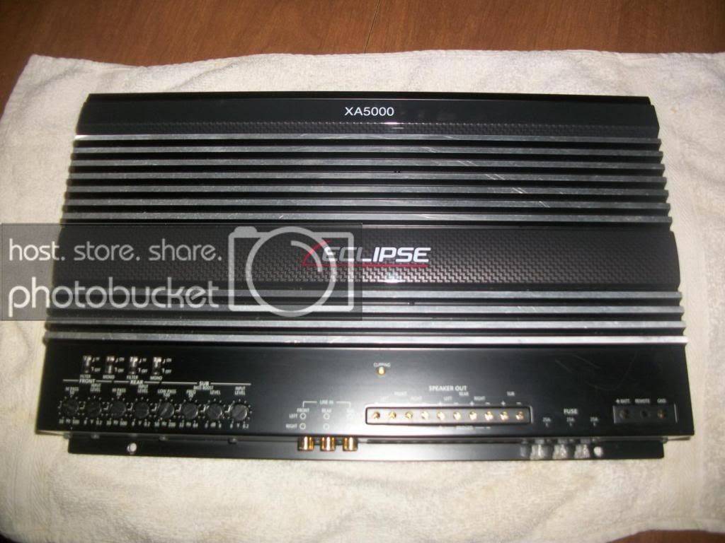

Lets start with some pics of the gear.

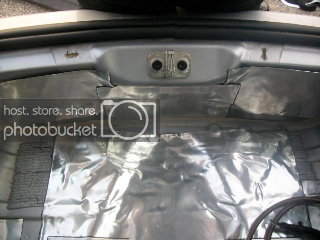

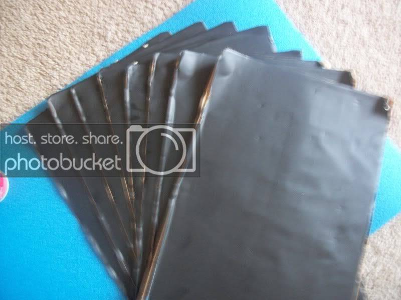

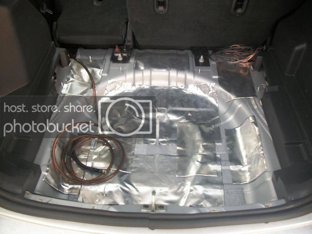

Here is some of the Damp that was laid in the hatch. This is under the spare tire and all the factory matting.

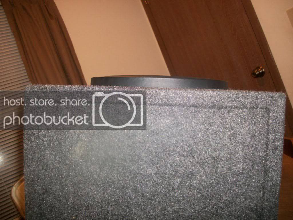

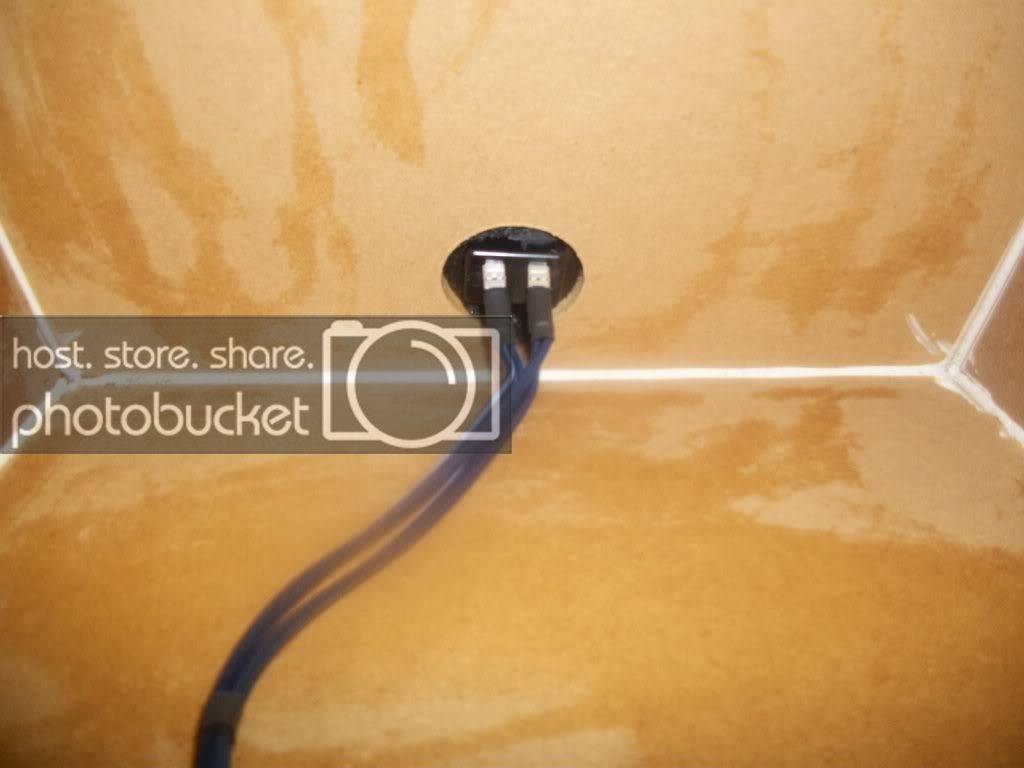

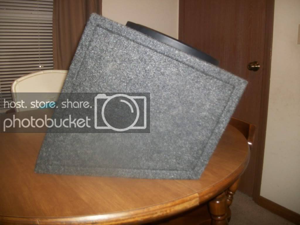

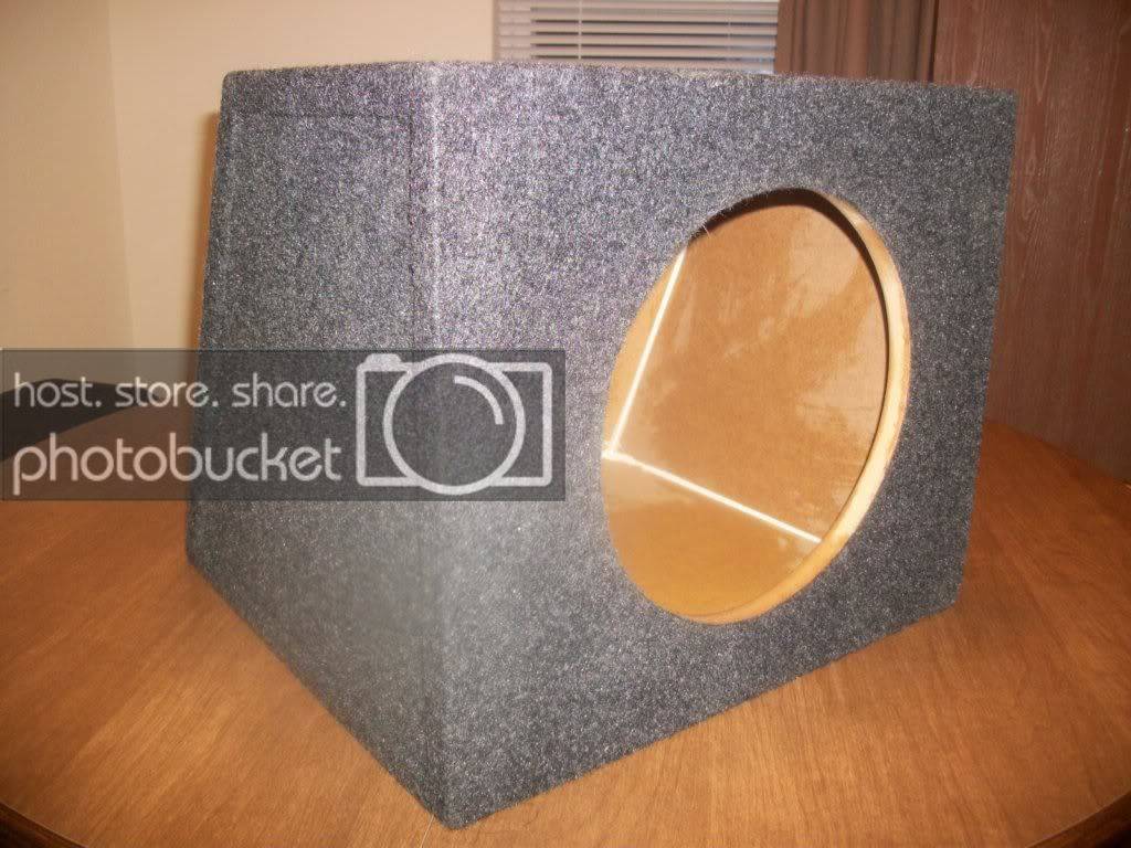

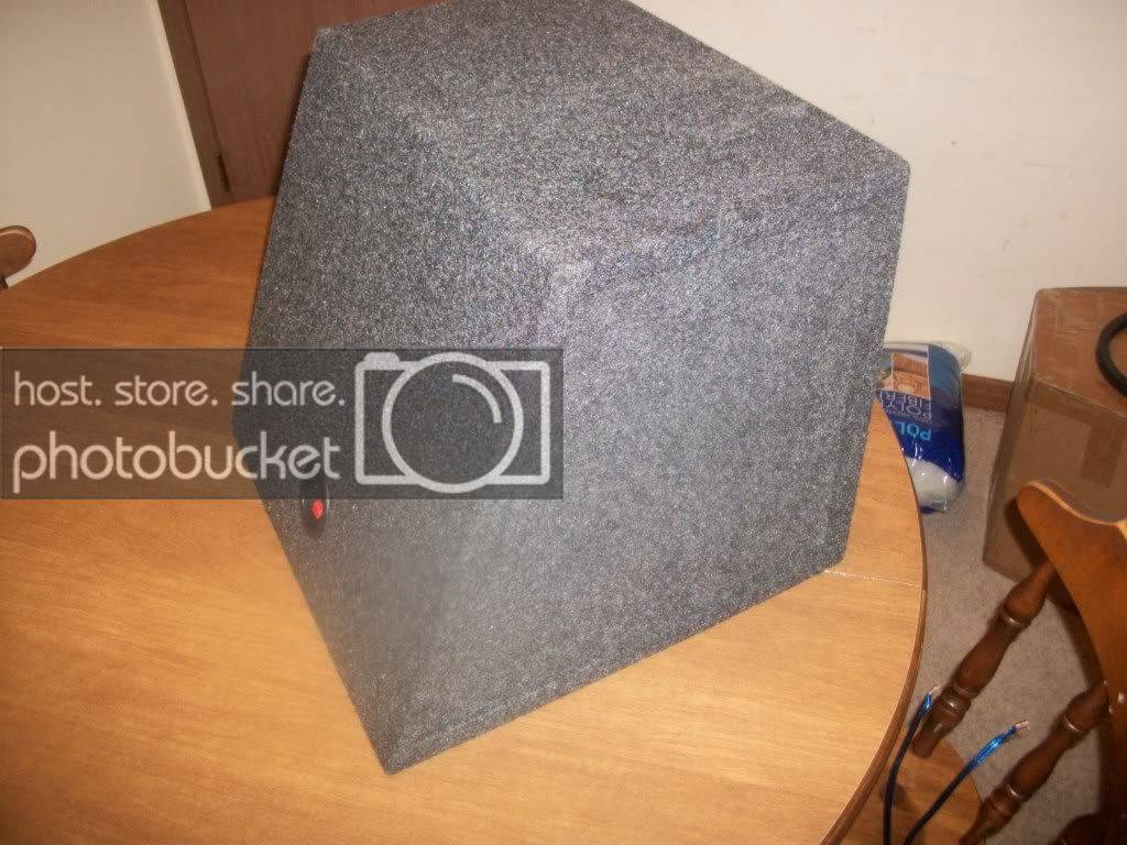

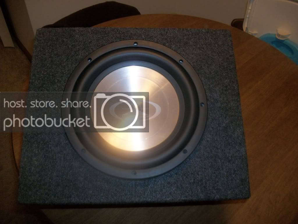

Here is the box and mounting the sub. The angle on the back fits my back seats so it slides right into place. Here is a quick test fit.

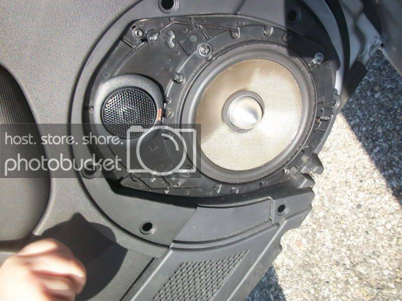

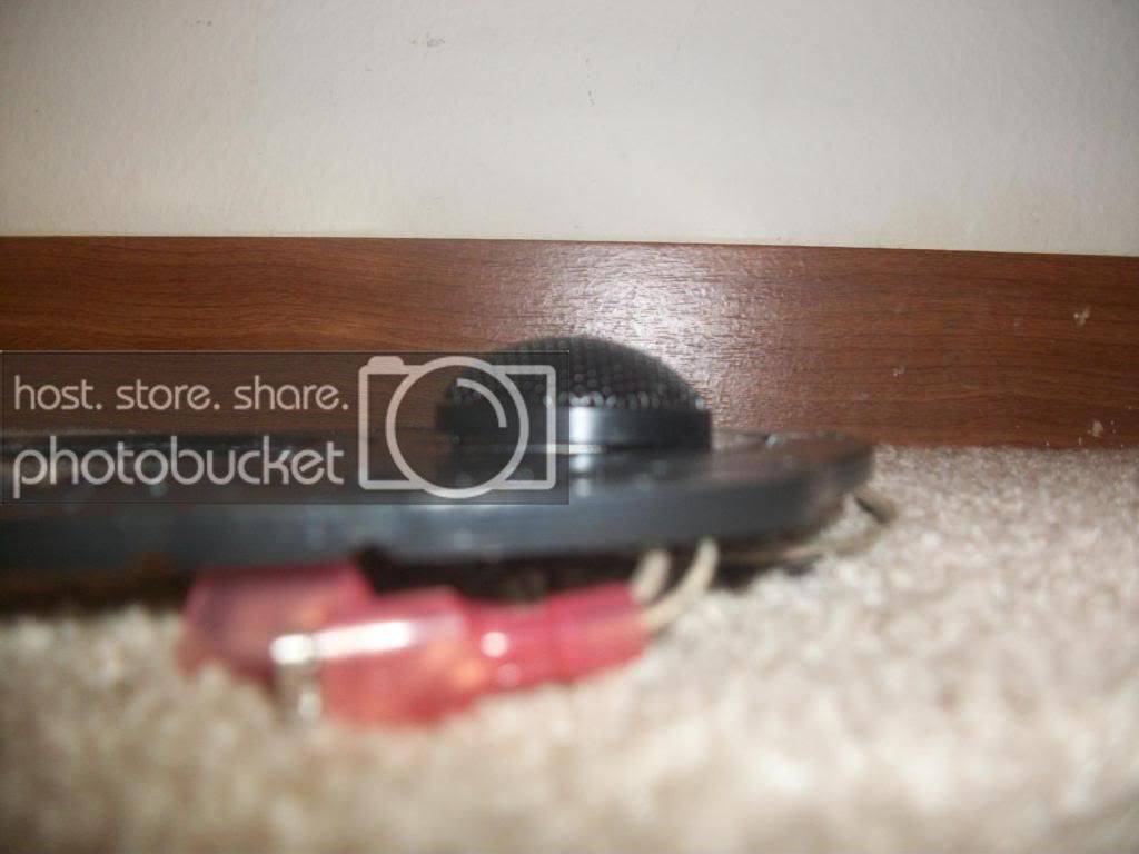

I had to use 6x9 to 6.5" adapters. The ones used here are Rockford Fosgate adapters. They are about 1/4" thick.
Here is a quick comparison on how thick the adapter is in comparison to a tweeter without the flush mount cup.

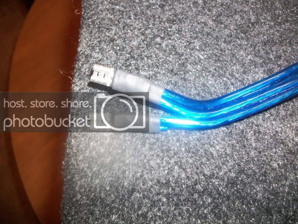

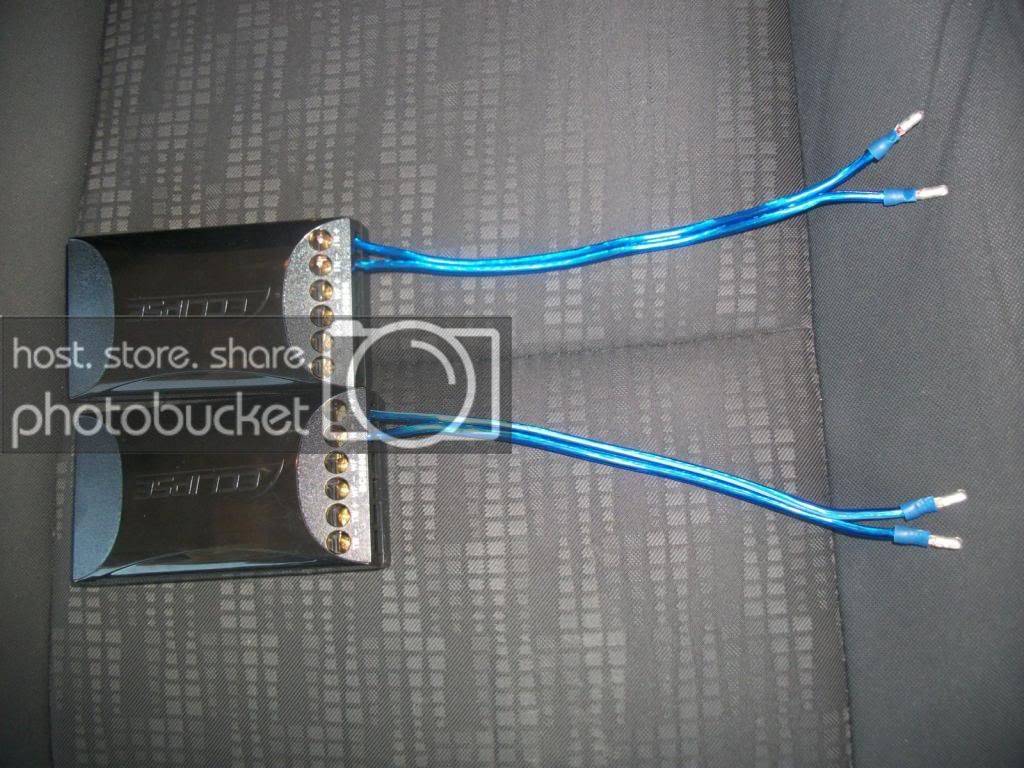

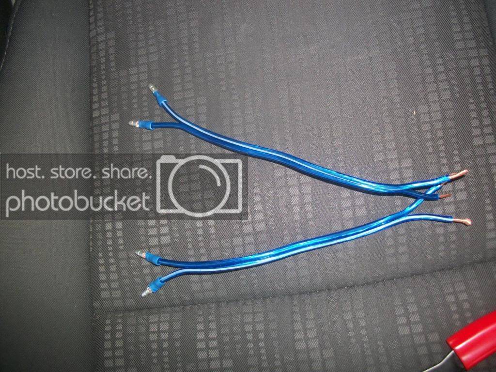

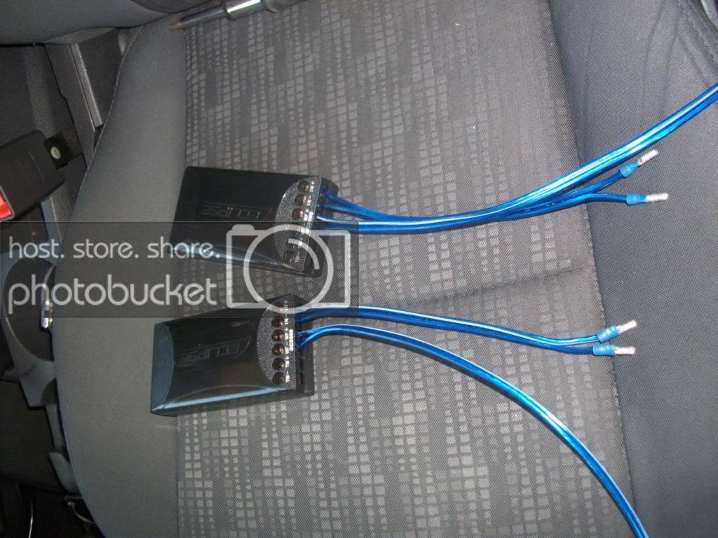

Here are the crossovers being wired up. They are mounted inside the doors behind the speakers. They are velcro'd in place.

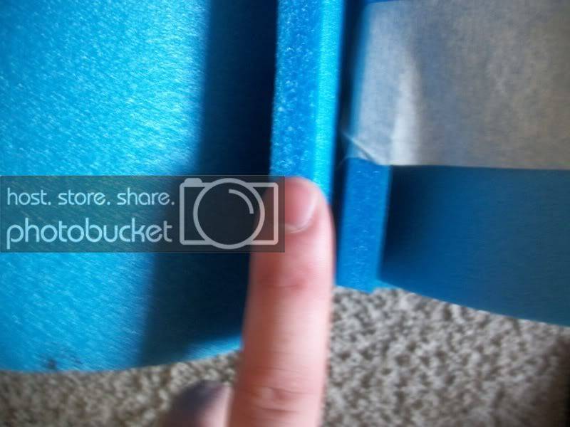

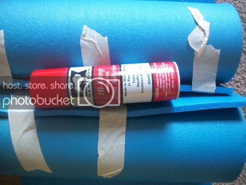

After that comes the majority of the work I have pictures of. The deadening and CCF in the hatch panels.

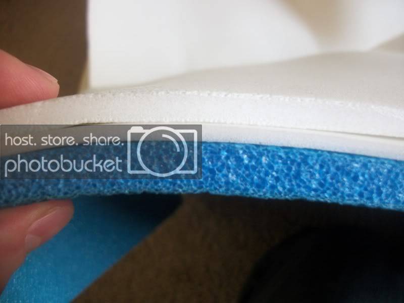

Everything was cleaned with alcohol wipes before the Damp Pro and the CCF was applied

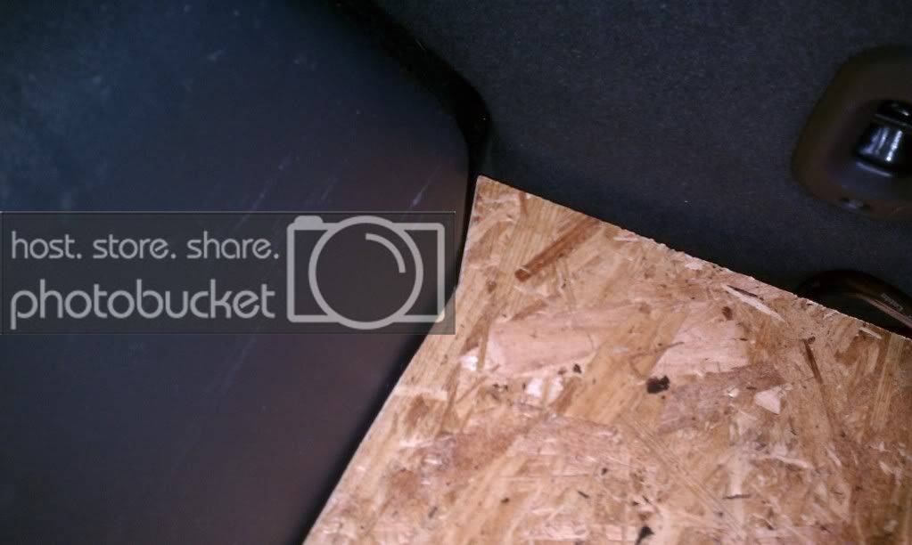

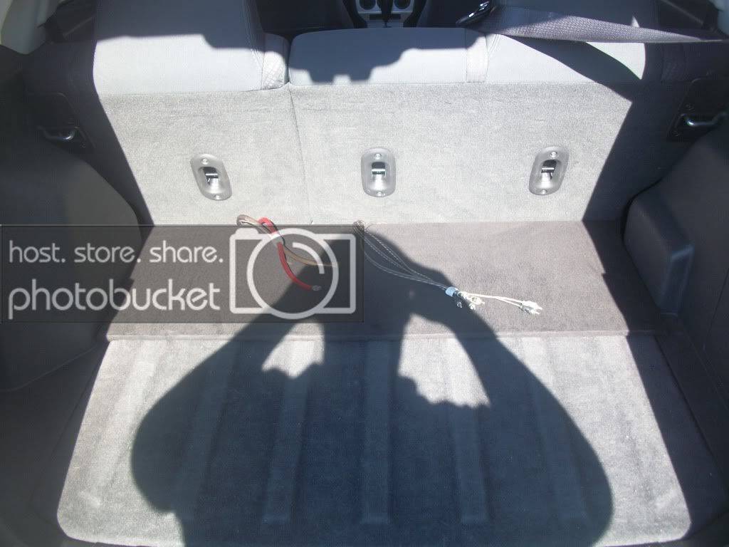

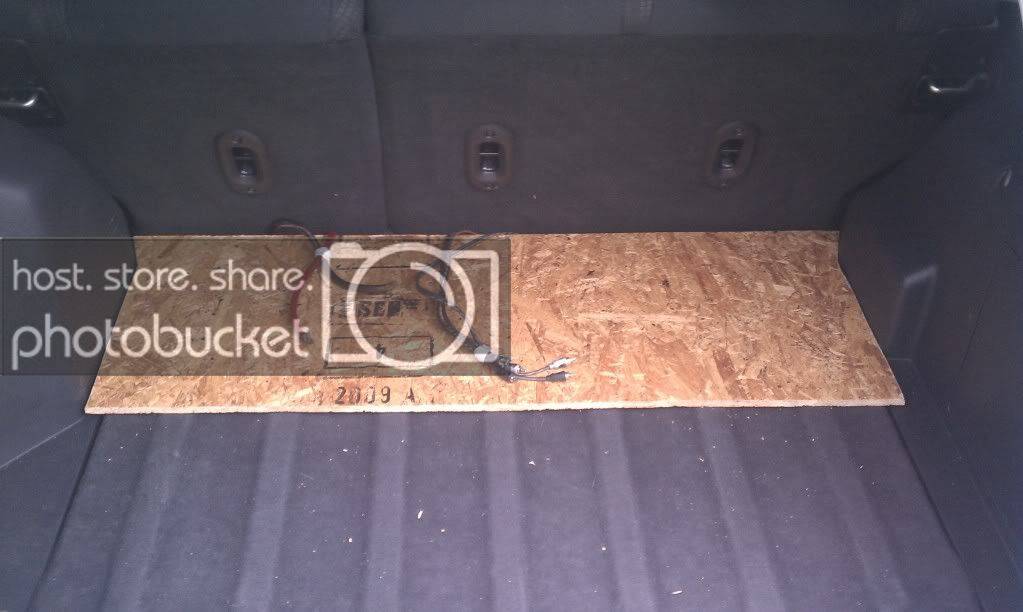

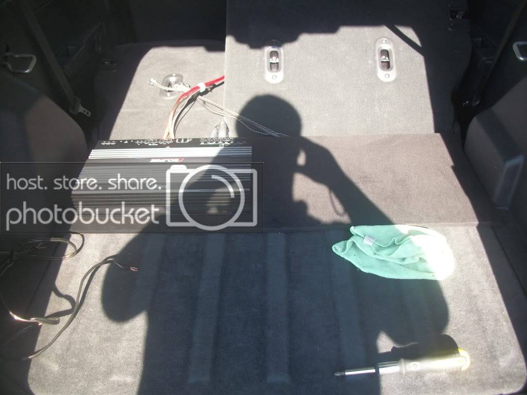

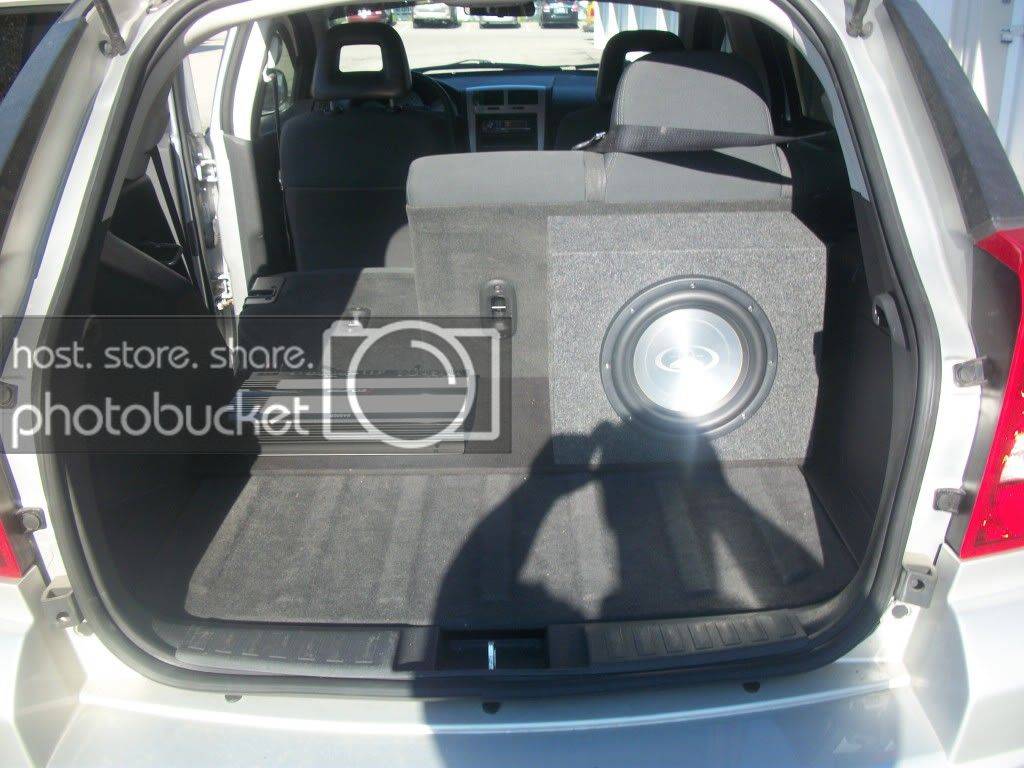

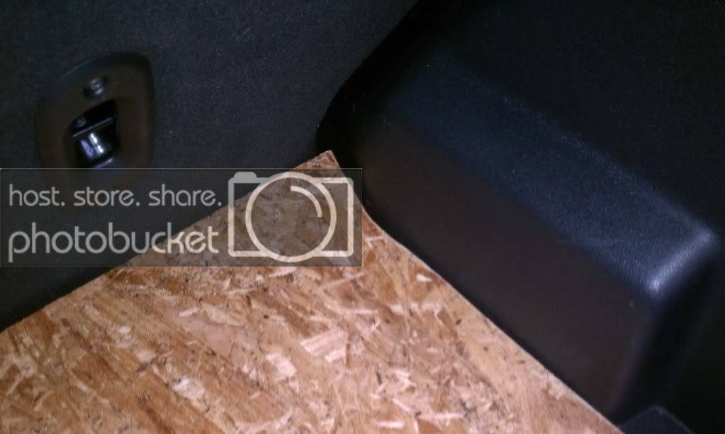

And then here is what I got done today. I was able to wrap the amp rack and get the sub and amp installed.
For the amp rack I just used the particle board I had laying around. No point in spending money on MDF when this will be fine for what its being used for. The corners are notched out to fit around the rear paneling.
It was wrapped in a black felt.
Amp in place
