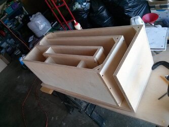

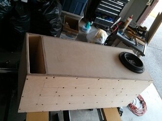

a single powerful 8 in a 1/4 wave transmission line enclosure. Buy the design and build it yourself. Buy an 8 that has a high FS of 35 to 40hz with 500 rms handling and about a 750 to 1000 rms amp.  No i'm not saying 8s are better for rock, you just have zero space for anything bigger in a proper enclosure.
