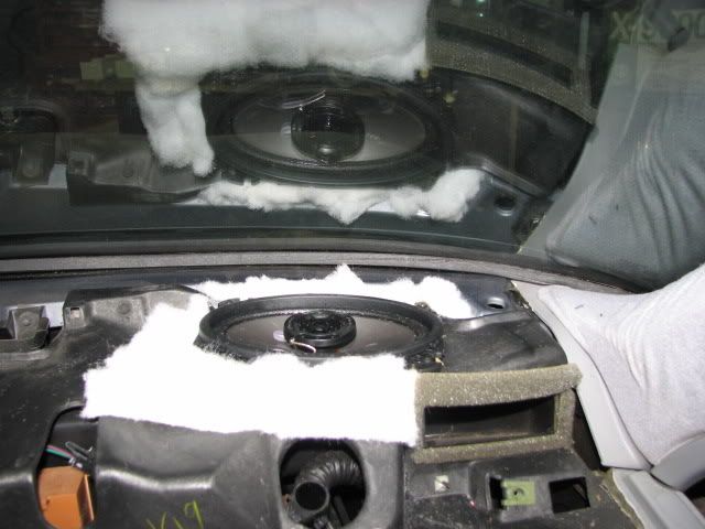

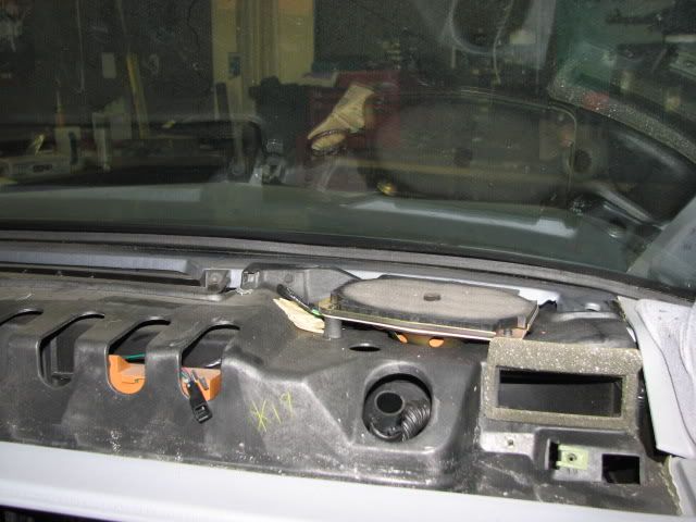

at that price it's whatever you find. i've used the Pioneer in an install before and they were fine once i sealed everything up.
stock
i stuffed polyfill all around the speaker and in the cavity, as much as possible.
you can see the use of weatherstripping foam along the top to seal against the dash grill

For the polyfill, do I pack that all around the speakers as much as possible, including all underneath them?
