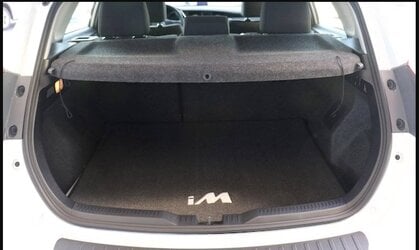

- Also Any mou
nting Ideas for a Toyota Corolla IM would be amazing.
