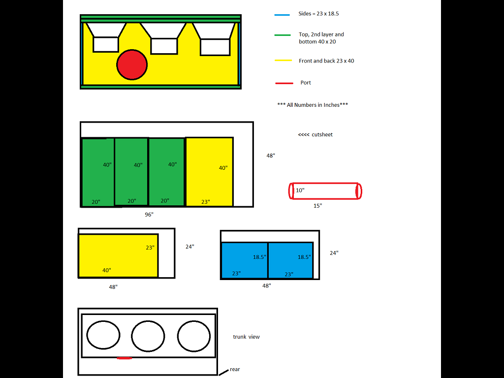

pm me your email, I got it in a picture file if you want it in that format, otherwise...
Here it is.
8 cubic feet net, tuned to 34.5 hz For the port, use the one i linked you in the earlier post, just cut that thing down to size and glue to the wood, make sure its sealed tight
24.5 H, 40 Width, 20 depth
pm me your email, I got it in a picture file if you want it in that, otherwise... 8 cubic feet net, tuned to 34.5 hz For the port, use the one i linked you in the earlier post, just cut that thing down to size and glue to the wood, make sure its sealed tight
but i dont want it to take up my whole trunk, i want space for the spare tire and small things i it to fit like this but a little less the size
