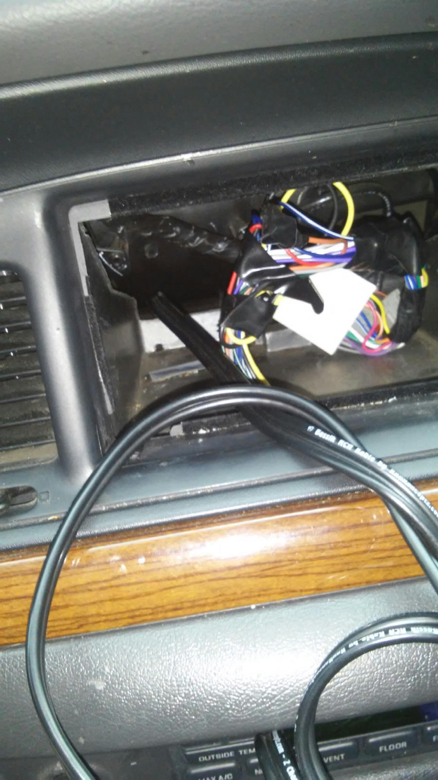

A large gauge wire pulling a lot of current through it generates a magnetic field. That can cause "noise" that might interfere with signals that are run through the existing vehicle wiring. This is especially true of the wires are in close proximity and running in parallel.
It means you will hear other electrical components through your speakers. For example, when using your blinkers you will hear a slight bass thump uniform with your turn signal's flash.
Perhaps, and your amp's power draw may cause electrical noise (from the magnetic field generated by the wire) that could possibly interfere with delicate circuits inside the vehicle such as computer sensors. At least in theory. Those circuits should be designed to handle *expected* electrical noise and transients, but Ford engineers may not have anticipated you running a large 0 gauge wire in close proximity.
I don't claim to know much about installing aftermarket amps, but I'm wondering if it might be best to run high-current the power and ground wires underneath the car instead of through the interior?
Only matters if you have sh*tty unshielded RCAs that are ran right next to your power wire. The rest does not apply at all. You should not have any noise when installed properly no matter what gauge wire or if the subs are wired parallel.
