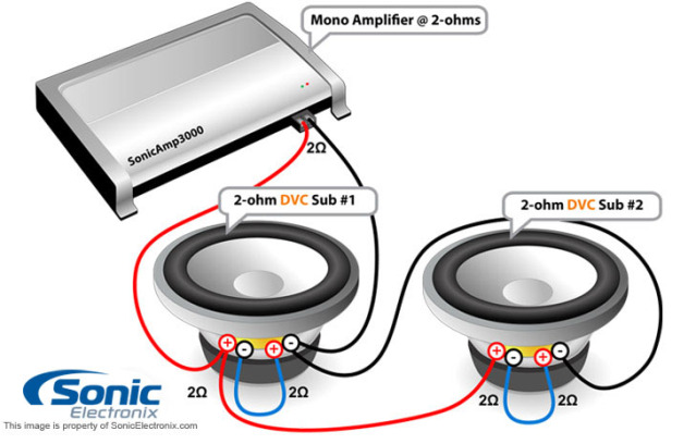

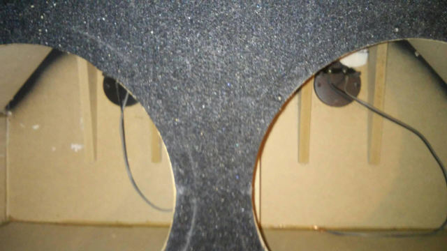

here is the temp box below im going to be using, this install is just to see if i know what im doing. now my question i plan on wiring like the pic below so will i be using the terminals at all and if so how will i go about doing this while still wiring the subs togather . fyi subs are dual voice coil
My amp has two postive and two negatives
Is it a mono? I'm not going back and checking. If it is, that's just so you can plug in more wires. For real. It all goes to the same exact location. If you were bridging woofers and stuff. I used mine to double up the run of wire to the sub box but it was a PITA so I went with the single run instead

its just for ease of wiring. Its basically still a single channel internally bridged its not a two channel. What ohm were your subs again?
there 2ohm

yeah its mono block
there also dual would that matter?
you have 2 ohms or .5 ohms load possible with your current subs. yes it does matter on how you wire them
.5 ohms is much more stressful on an electrical system, i'd advise against it unless you got some good battery, alt and big 3 support.
2 ohms is a lot less power but less stress on your electricals.
