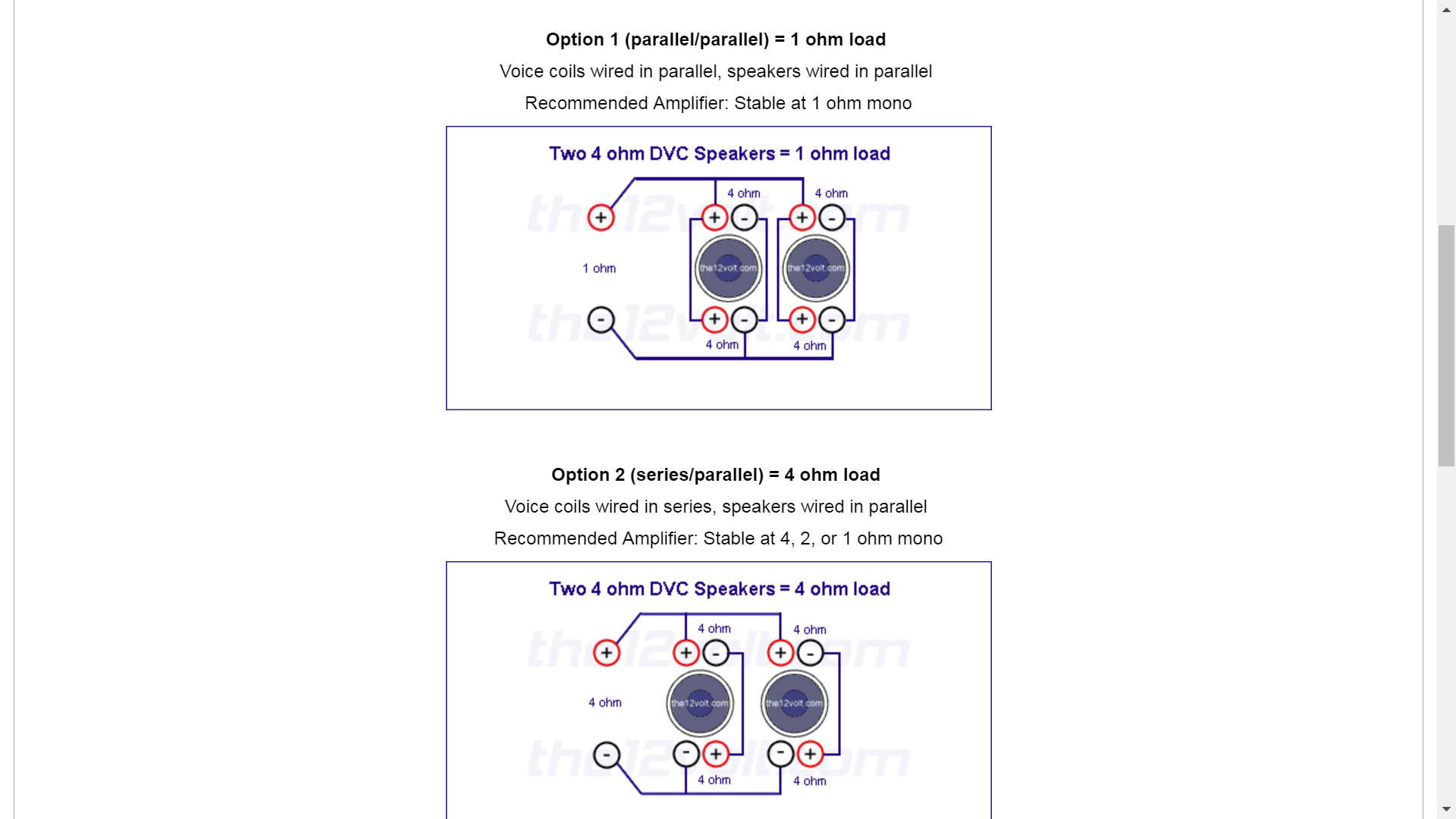

"You can wire two of these in parallel/parallel and get a 1 ohm load, but 1 ohm stable is a term used when buying amps." can you clarify this reviewers statement on those skars please. thank you in advance.
thats only for two dual 4 ohm subs.
this pic should explain better. These are your wiring options.
D2
D4
i don't see an option to run that wolfram at .5 ohm....but if it can, wouldn't that draw even more power from my cars electrical system? and correct me if I'm wrong, but the lower the ohm rating the better the bass? so i wanna shoot for either 1 ohm or .5 ohm?

lower ohms more power, more current draw please read post #50 i already explained all of this

ok i reread post #50 sorry, i always ask too many questions than necessary, one of my many flaws lol....so if i want 1 ohm my options are either the two skar dual 4ohm's if it becomes available, 2 of the HDC3's or one big death penalty....thank you guys again for all the help.
