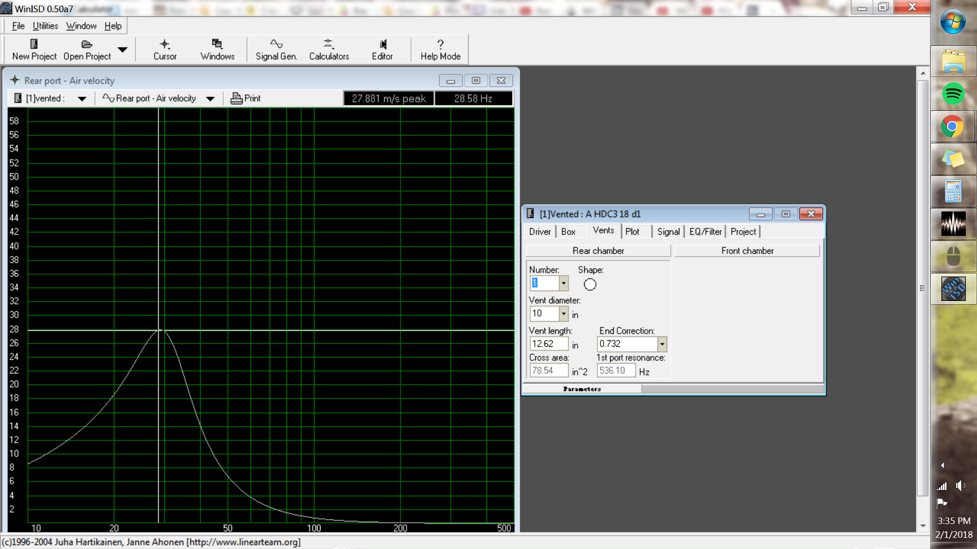

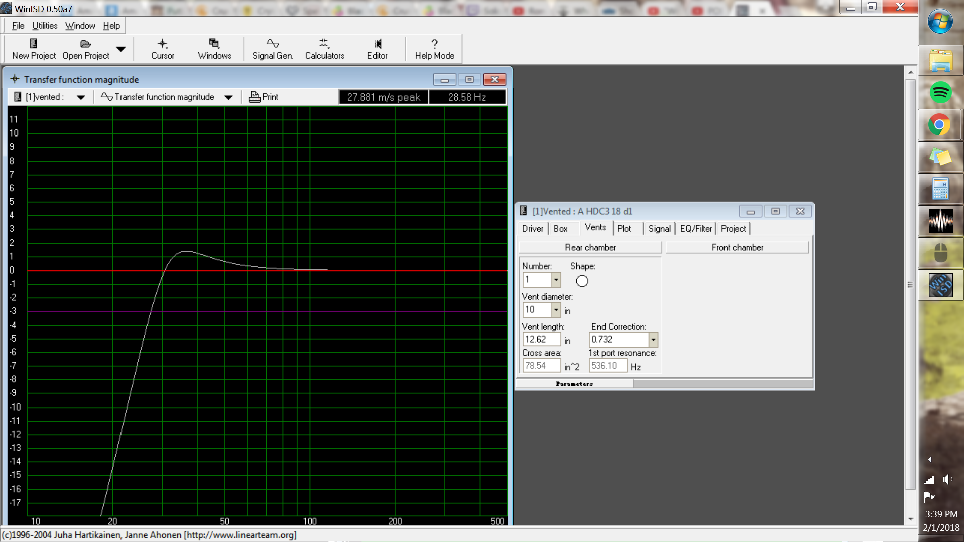

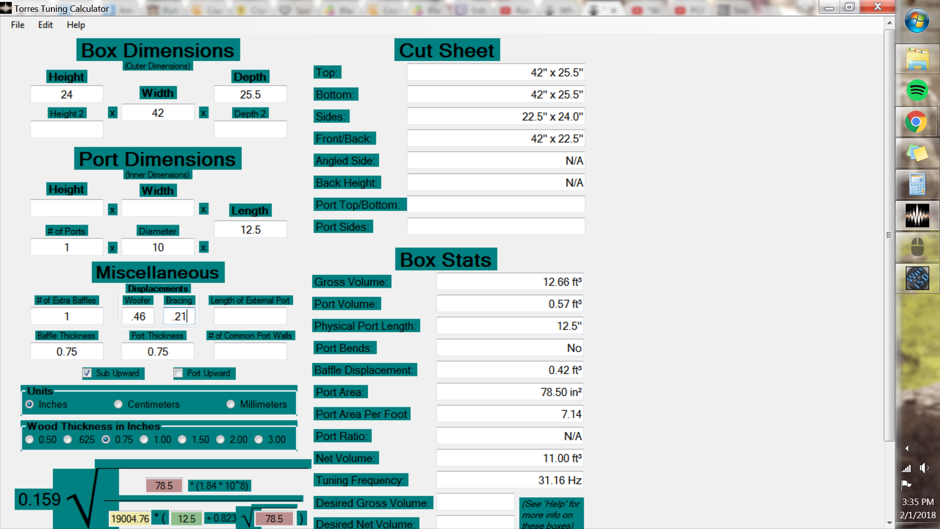

here's a sample blueprint and projected frequency response model and air velocity numbers.
ive only seen rectangle ports, hard to visualize a circular one. ill have to look up some pics. thank you for the info.
