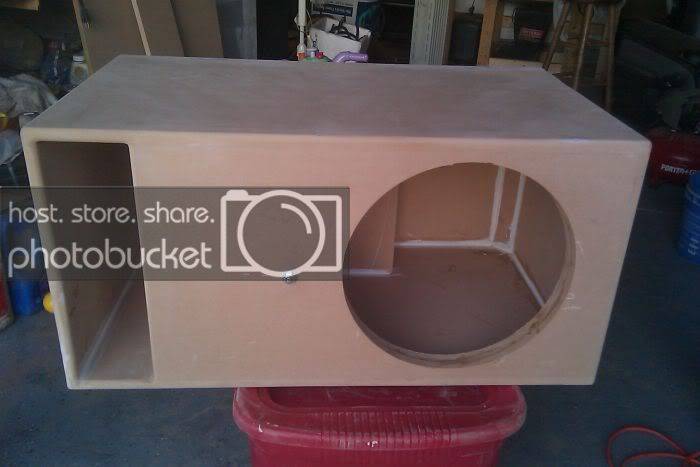

heres a link to his type-r box hes selling
Alpine type-R dual 12" ported sub box - eBay (item 230514125259 end time Sep-19-10 16:42:24 PDT)

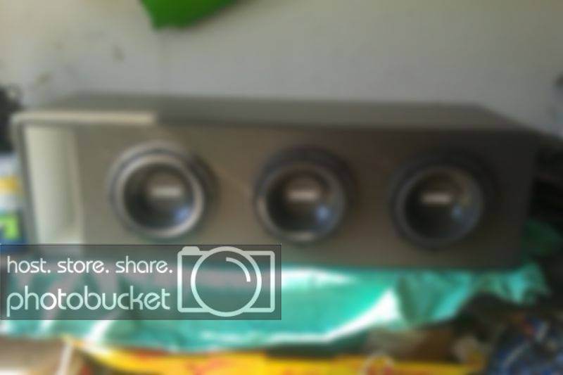

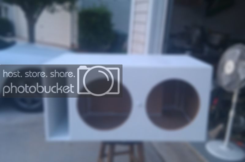

That box looks meh to me. I dont even see any sealant on the inside joints. Box looks nice but looks just like any other pre fab box. Sure maybe he builds them but I would suggest finding someone on here or what not and having them get you right,these are better sized ports. If you we're in nc i'd help u out, but i dont ship boxes. Here is a few of mine, im no pro by any means and many many guys on here have way more kills than I do, but I think I do a good job.
If somebody credible is willing to build me a box and ship it to either Canada, or to Blaine, Washington (my friend lives there) I may just go with them.
x2. Looks like a little sealant in there, but who knows.
