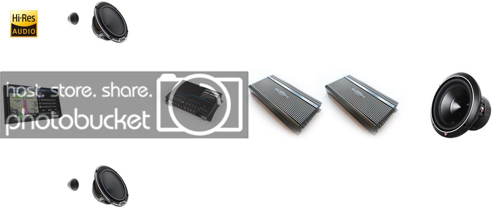

To break it down, this is the basic outline of what I am looking to do with the next system. 4 Channel amp for mids and highs, mono amp for the sub. DSP running active crossovers and a Hi Res Audio HU. A simple 3-way setup. Speakers are subject to change as well as Head Unit and DSP. Amps are set in stone "Barbara Ann and Mike."
Images are representative.
The AC DSP is not a fan favorite.
I suggest downloading different ones software to see what you like best. Helix, Hertz, Audison, JL, upcoming Dayton. Don’t sweat the HU
Every DSP has a full thread on DIYMA.
I watched a lot of videos for different DSP's. Viewed the different software interfaces. Compared prices and what not. I think my initial choice in the Audiocontrol DM-608 is the right one for me. The Helix DSP Pro MK2 is outstanding though. I didn't like the JL at all. The RF 3SIXTY.3 is cool as well. For simplicity and price... AC DM-608 is my choice.

Pretty certain you wont see much of a difference at all between that us acoustics mike vs your rockford prime with the amp dyno numbers showing the US acoustics mike only making 100 watts more than the prime while having WAAAAAAAAY worse efficiency 82% with the rockford and 67% with the us acoustics mike. If you have a dsp, it literally doesnt matter what head unit you get. If you do bluetooth, the excelons with APTX will actually sound pretty nice with bluetooth if you stream lossless or have a tidal subscription.

Since you don’t listen to people that do this. Make sure AC added left and right independent EQ in the last update. It is pointless without it.

yeah its not the same case as the example you put up, its a legitimate reason that really holds back your SQ potential by far (i=Independant right and left EQ AKA the ability to EQ each individual driver rather than just lumping everything together which is what the audiocontrol does). Yes you can just settle for mediocre thats fine but if you are actually looking for a top tier sounding system, that aspect is extremely important. Not one of those nutthugging brands sort of thing. There's a whole other forum dedicated to sound quality and there's been a full thread of every DSP possible and there's a major consensus of which ones are king when it comes to price, reliability, software, overall tuning capabilities, specs and hardware.
Hertz H8 is the same price range as the AC. It uses the bit software but updated. I’ll probsbly get the Dayton when it comes out.
The Helix mk2 is also cheaper. Get it from overseas
I looked at the H8... looks cool but I don't want to use high level inputs and I don't see an option for low level inputs. The least expensive I could find the Helix is $750 (eBay). Is that good? Is there any literature on the Dayton?
