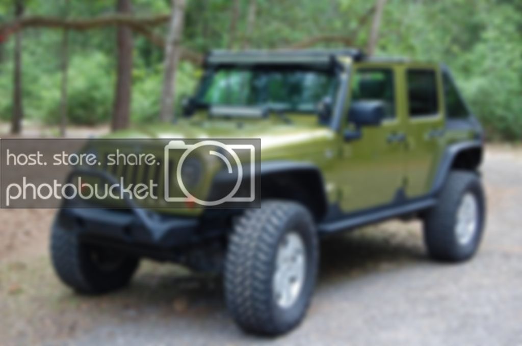

Here are a few shots of the Heap.

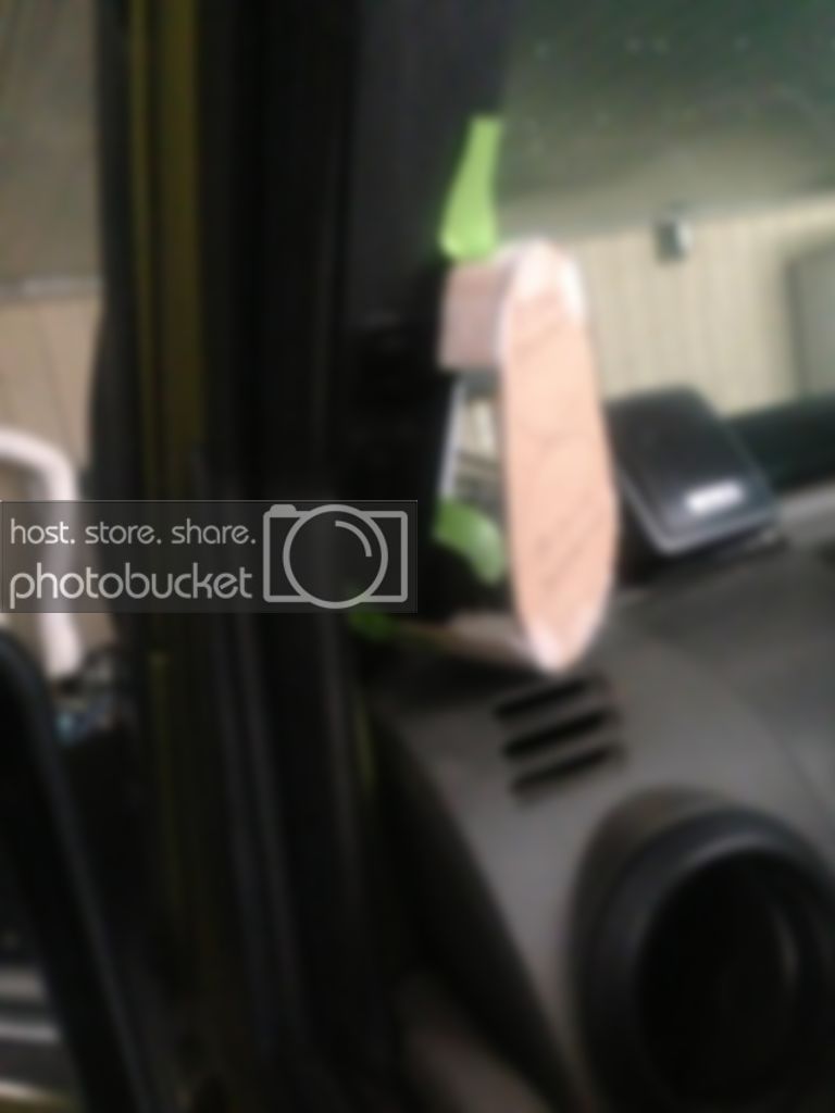

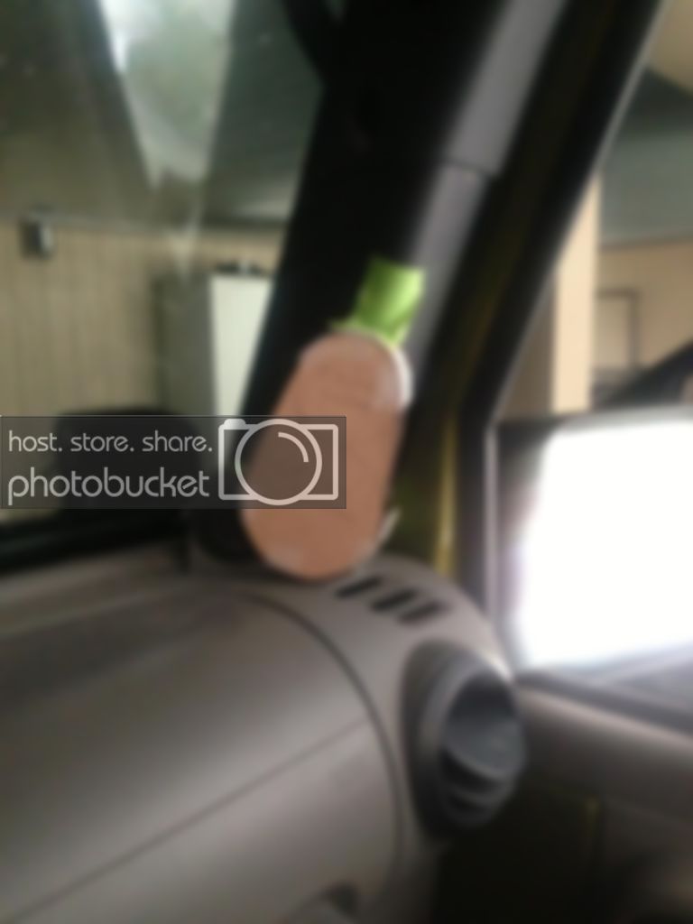

Well, I've started tearing down and mocking up. I am going to do the mid/tweet's in an A-pilar pod. A quick mock up looks like I have a decent amount of room for drivers from 2 to 3 inches. 4 gets a little to obtrusive.

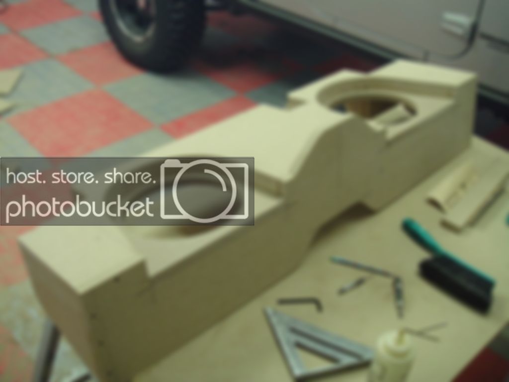

I am probably going to ditch the stock dash woofer location and build a kick panel pod. With a little judicious cutting I can fit almost 5 inches of depth and I can run the enclosure up along the fire wall behind the dash for some extra interior volume.

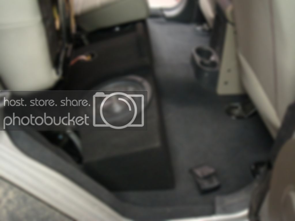

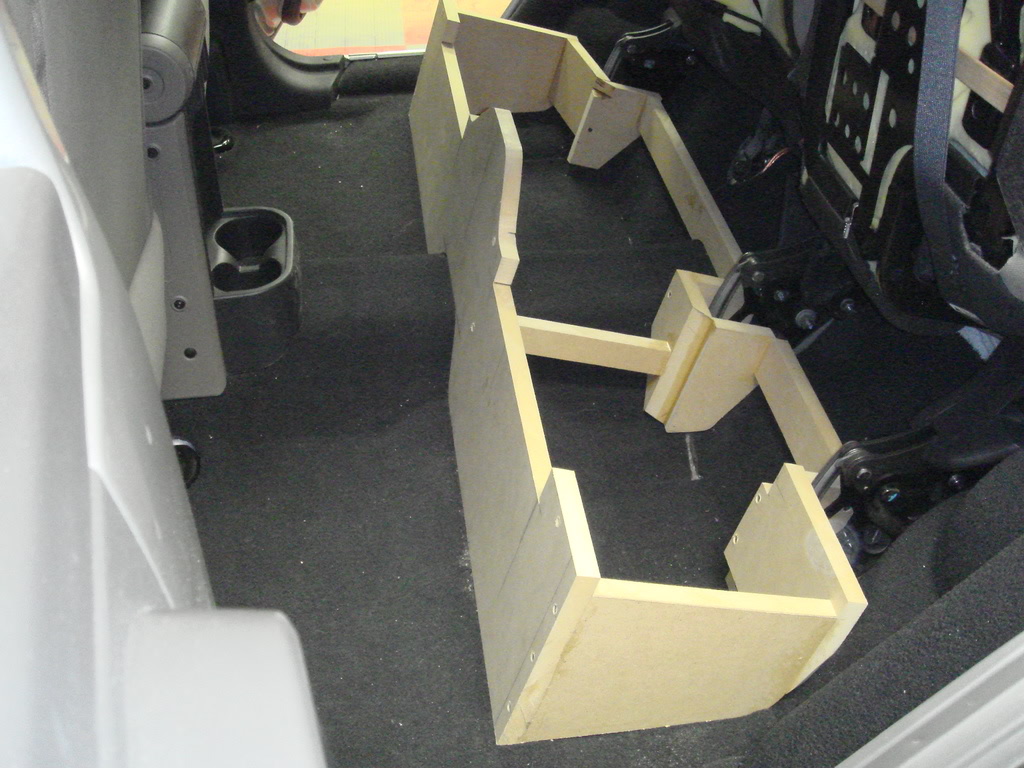

I am probably going to trash the under front seat 10 inch sub idea, and build under the rear seats for a pair of 12's that handle small enclosures. Like this...(not mine, pulled from a Jeep forum..)
