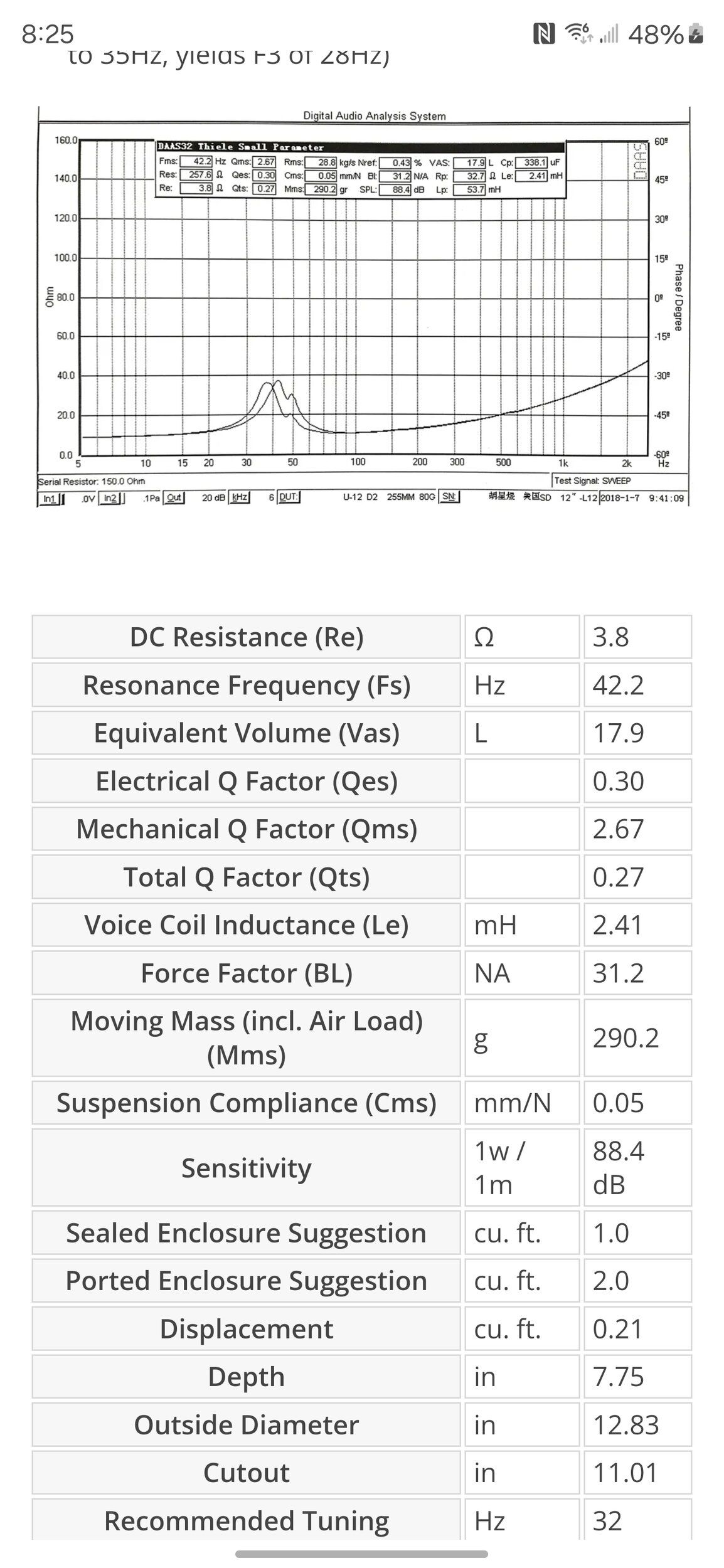

Sundown 12 88.4db 1w1m
Audiopipe 12 88db at what 2.83v or 1w1m? We don't know if it's 2.83v the the 1w1m rating would be 85db which would make the sundown u12v1 more efficient
Either way it's a toss up and I would rather have a sundown than an audiopipe

Well I posted kippel results for the sundown audiopipe who knows which spec it is. If it's 1w1m then they are essentially the same if it's 2.83v then the audiopipe is less efficient.
