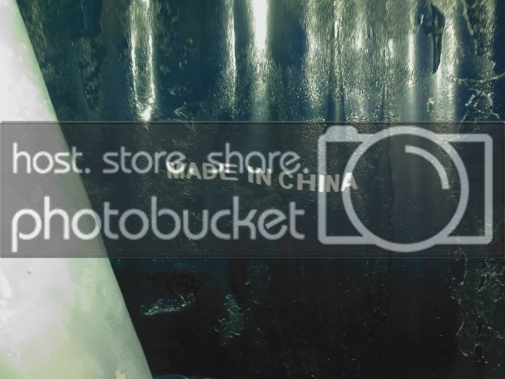

What causes batteries to explode? I ripped out my batteries yesterday and found that 2 HC2400s were exploded/melted. We checked the voltage and they were sitting at 13.5v, which is just fine, and my alternator is charging just fine. Ive seen batteries bulged out before, but never like this. Anyone ever see the Kinetiks explode/melt before? Ive heard from one other person that it was either like an 800 or 1200 that melted. Anyone have any idea to why these batteries randomly melt?

pics of them installed?
every battery I have seen with bulging of that magnitude has been an installation issue(not saying yours was, but give us pics to prove it wasn't)

And can you reupload the first pic?
