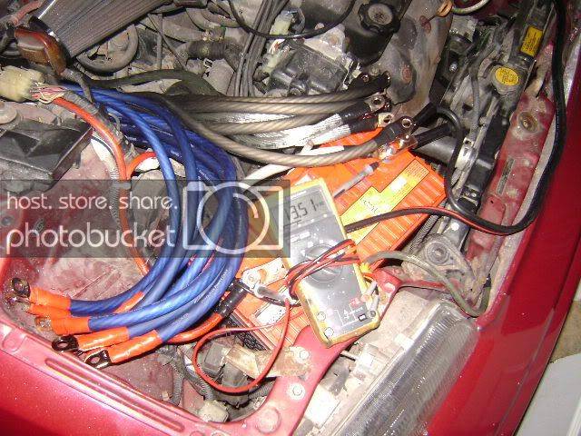

They work especially well when you need multiple cables hooked up to a battery.
For instance:
You would never be able to connect all those wires without a bus bar...
