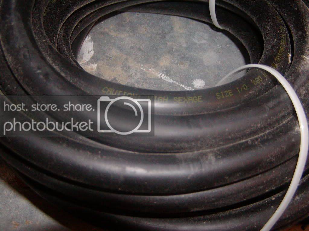

Check out 'coppercableman' on eBay. He sells really nice wire. You can even pick the jacket color and what's printed on it. We got 'Caution: High Sexage" //content.invisioncic.com/y282845/emoticons/biggrin.gif.d71a5d36fcbab170f2364c9f2e3946cb.gif
