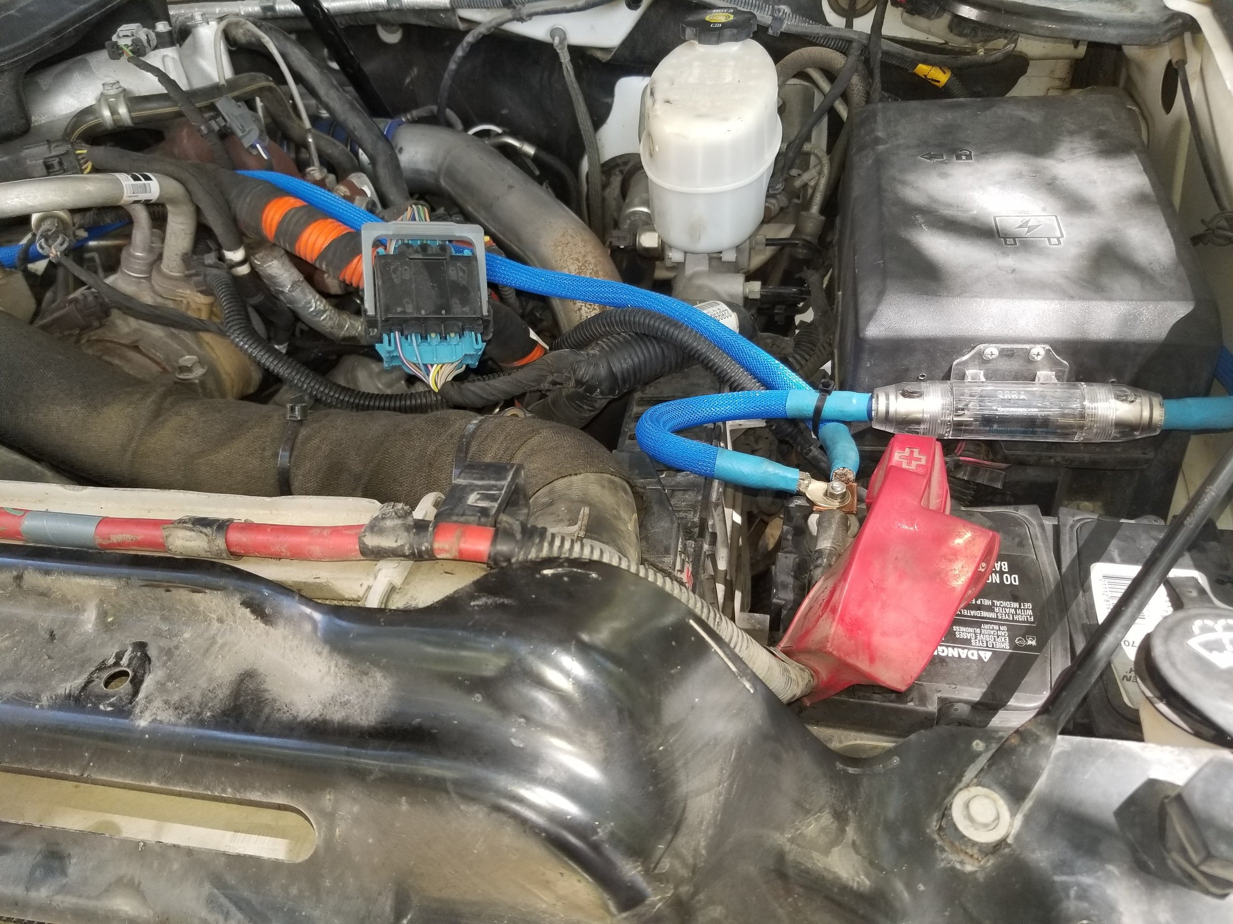

In general you usually want a fuse with in 18inch of the power source. The shorter the better as to limit the unprotected length of wire between the power source and fuse.
Wire loom and techflex help protect the wire which is why it is all over factory wire harnesses even in places where it's really not needed
Okay thanks I was just seeing if I could actually put the fuse holder inside my car but I returned the fuse holder that I had it was actually too large I got a smaller one so it shouldn't be too hard to mount under the hood somewhere.
This is an older pick of mine with a rather large anl fuse holder. The unfused length is as short as I could possibly make it.
It's note very service friendly though as it makes opening the fuse box a pain but it is secure
Yeah that's a really short wire from the fuse to the battery post
I think I get the point now I think with the smaller fuse holder I have coming from Amazon it shouldn't be an issue. Part of the problem is it's at 1/0 wires so huge.

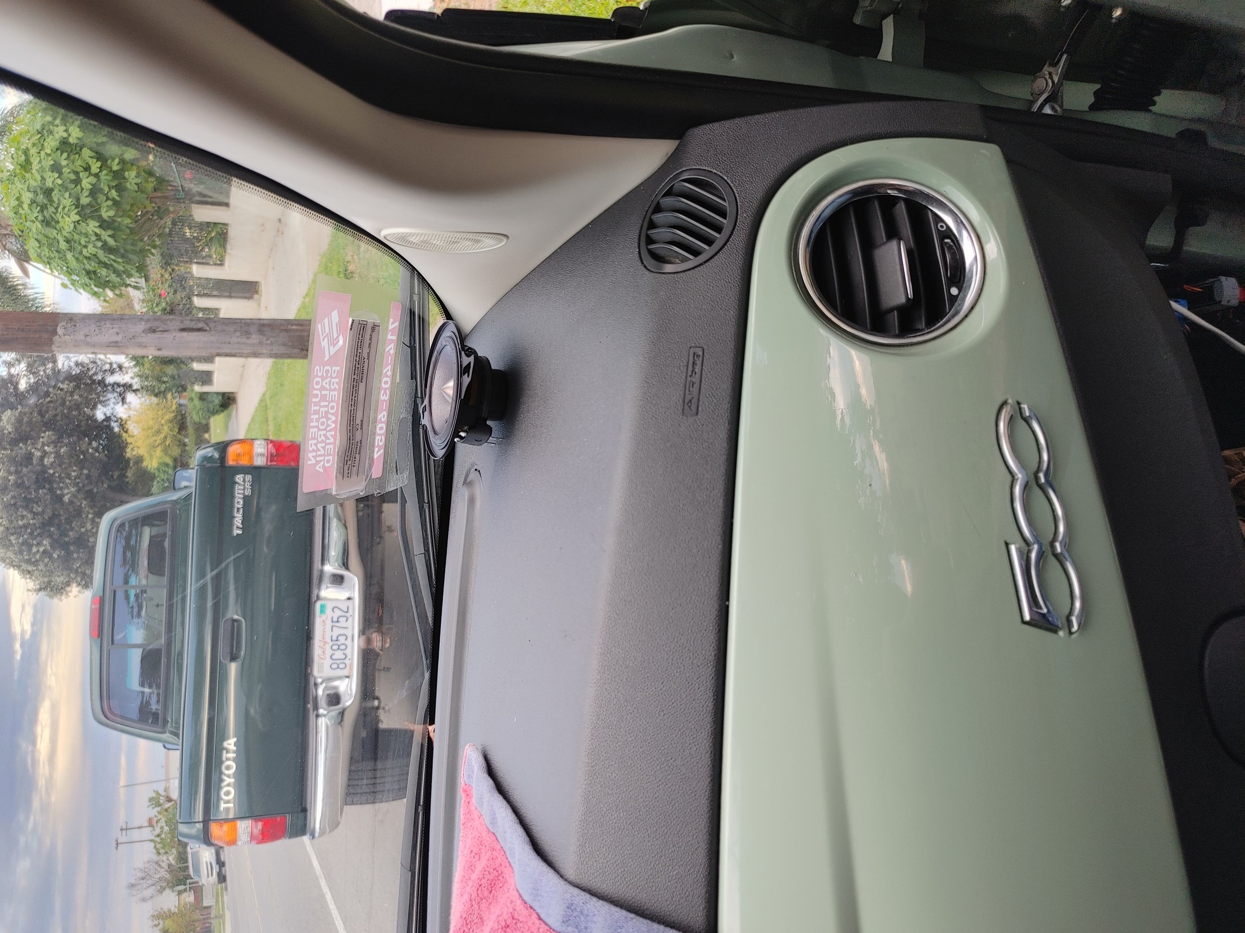

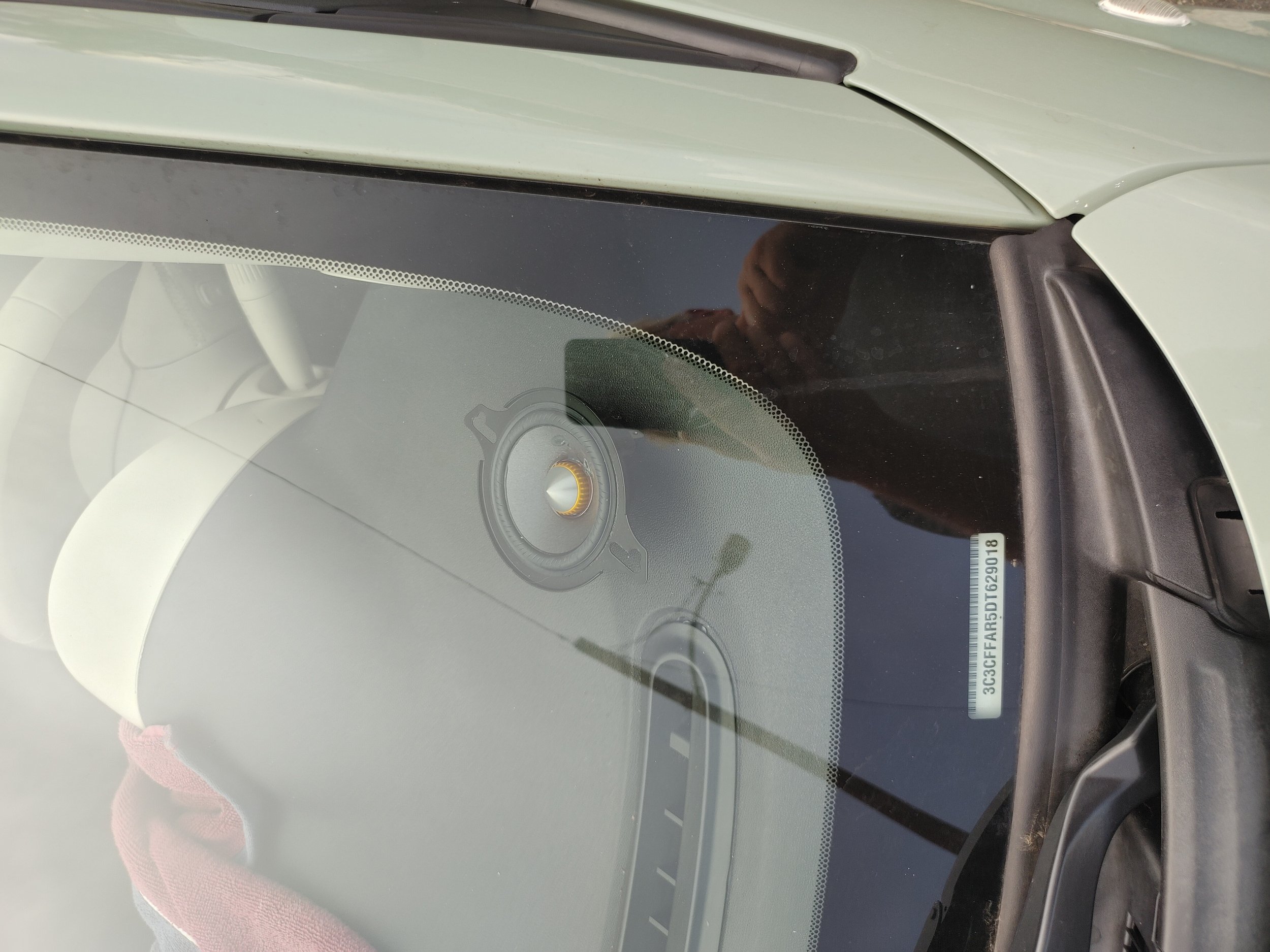

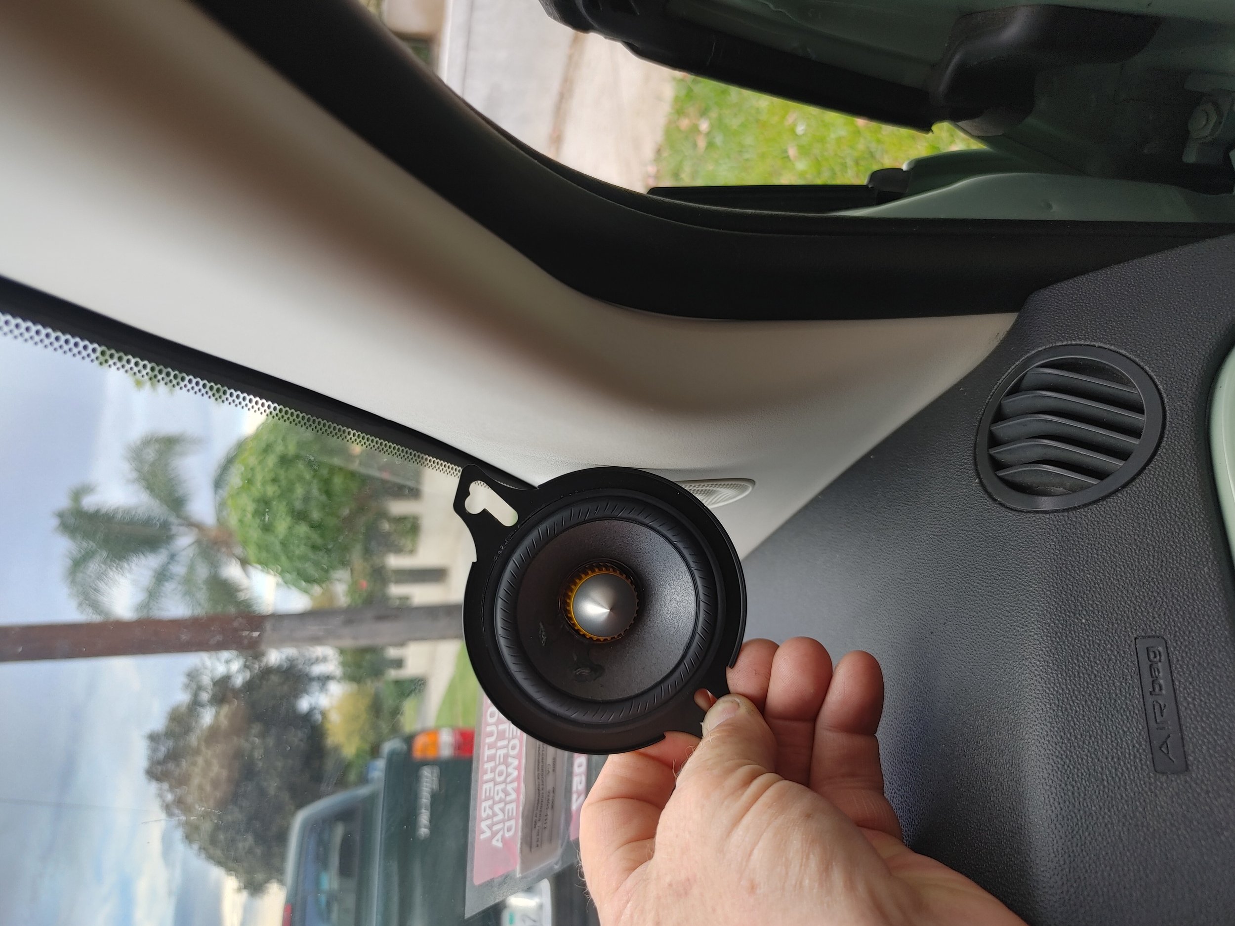

Been trying to lay out the mid-ranges on my dash it's a very weird dash in my car. It's curved and it stays curved the whole way except for in the very back corner of the a-pillar comes down and ends it goes flat for about a four four and a half inch square maybe 5 in it goes completely flat.
In order to get the speaker to sit in there you would have to either pull the dash or you'd have to pull the windshield out to build the drill the hole to put the speaker in I am unwilling to pull the dash out I've watched the video on it it's way too much work. I do know a glass guy automotive guy to pull my windshield out for me but I don't feel confident getting it done in one day and I park my car outside so I could not leave my car outside with the windshield out that's not looking like a good option.
I guess if I could get the holes in the dash and then have my buddy pop the glass back in all in one day I'd probably be okay. The most likely probably the easiest thing to do is order those aluminum pods from the guy in Germany simplest way drill holes in the a pillar and mount them I'm not too fond of the look of those pods and really rather have this mid-range and a dash and then put one pod to hold the Tweeter.
Called a couple local shops to see how much they would charge me to fabricate the a-pillar to accept the mid-range and Twitter and the guy said well it all depends on the angle how much angle there is anywhere from $700 to like 2,500 sounds expensive I can get the pods with the mounting brackets for 320 bucks.
Comments and feedback are welcome what you think my best option is obviously money is an object if money was no object I would just go pay whatever it takes to have my a-pillars molded to fit.
