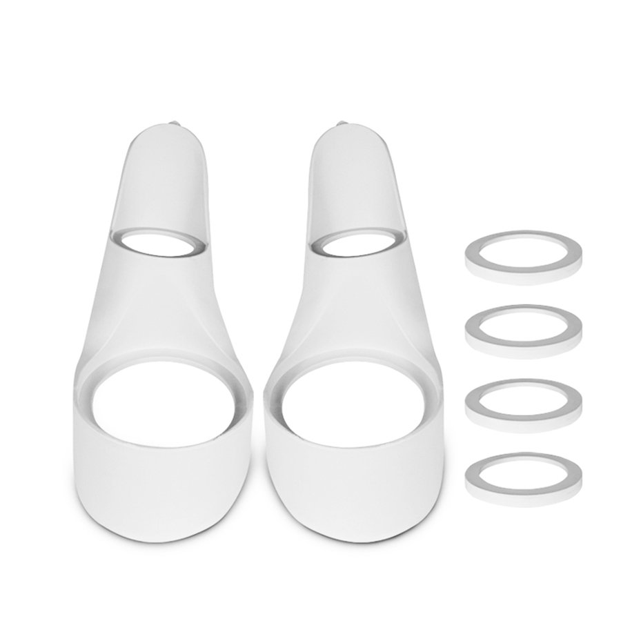

Already made for 1 inch tweeter and 3.5 inch midrange, maybe could make it mold into my A pillars. Loads of them on Ebay.
Possibly but I think your mid has a fairly unique mounting flange just consider you need to fit the grill to cover the 2 mounting tabs.

Yes my mid has a weird flange sticking way out but I could cut it off with some cutters and just keep the complete circle to 3.5 in and it would still have a mounting point so the guy in Germany that was going to make the pods for me told me I need to cut that flange off. Those a pillars on eBay are $25 for two of them I guess I could order them get them here and see if I can make them work if not I have to do the whole popsicle stick hot glue.

They look pretty good and they're dirt cheap on eBay and the guy sold like 200 of them I think it says you have to have a minimum size or with of your a-pillar to make it work I may order a couple and just try it.

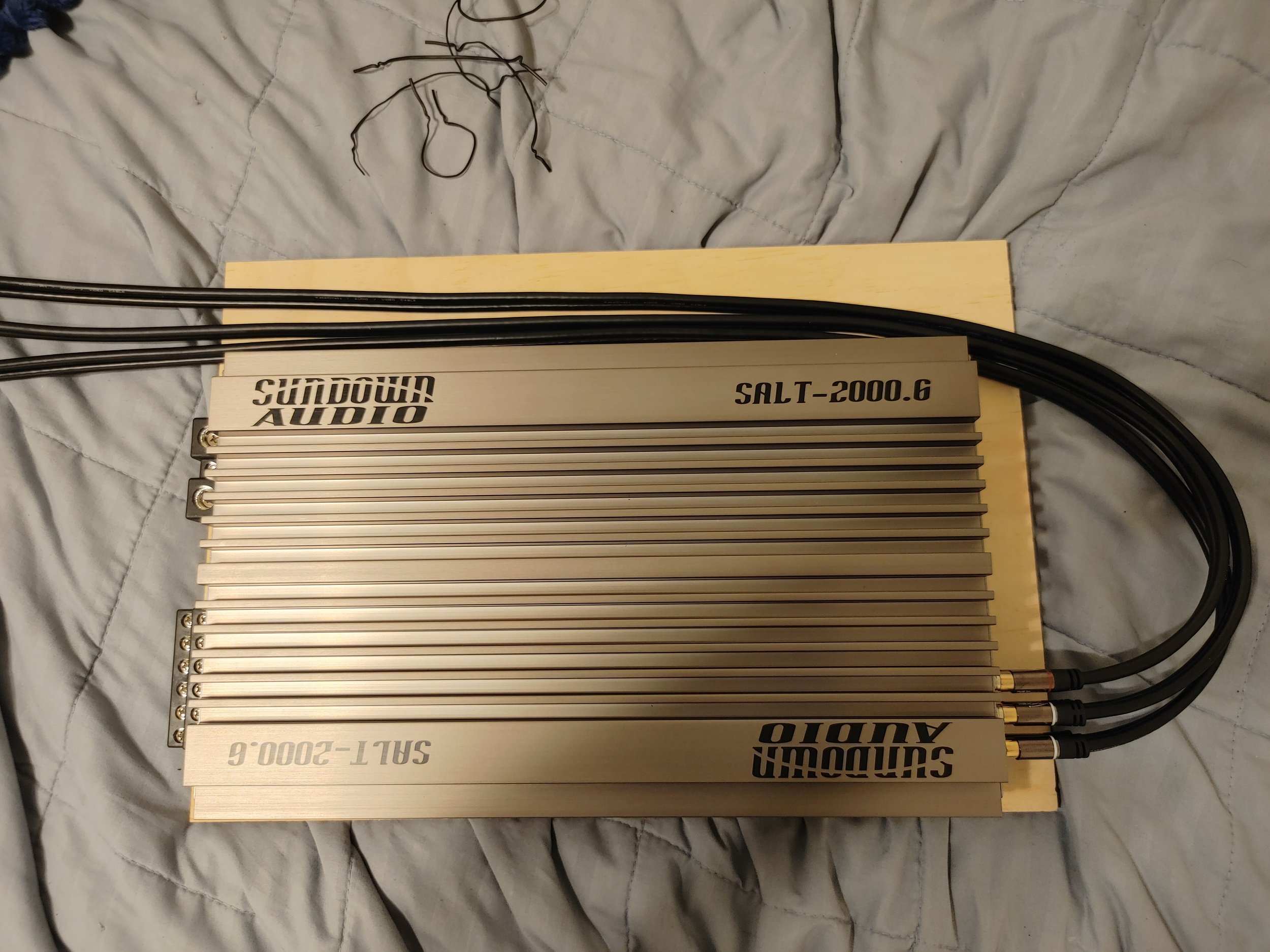

Trying to figure out my layout for the amp and the wires I seen a lot of guys I guess drill holes and put zip ties to hold everything down probably when I'll end up doing.
Also see a lot of guys have a power block mounted with the wire coming in from the battery and then another one coming out so you could hook up multiple things I guess do I need to do that or can I just run it directly from the battery to the fuse and then run the wire from the fuse straight into my amp.

I didn't realize he's rcas were going to stick so far out the back of the amp which now that could become an issue of hitting and not enough room under my seat. Think I'll just drill some holes in this piece of wood and zip tie the wires down but I'm going to sand the piece of wood down and clear coat it with some clear coat.
I use these or the Xscorpian ones. TSpec have decent ones also. Its always nice to have an extra space on the power Block for future needs. Same with a Distro Solid ground block
