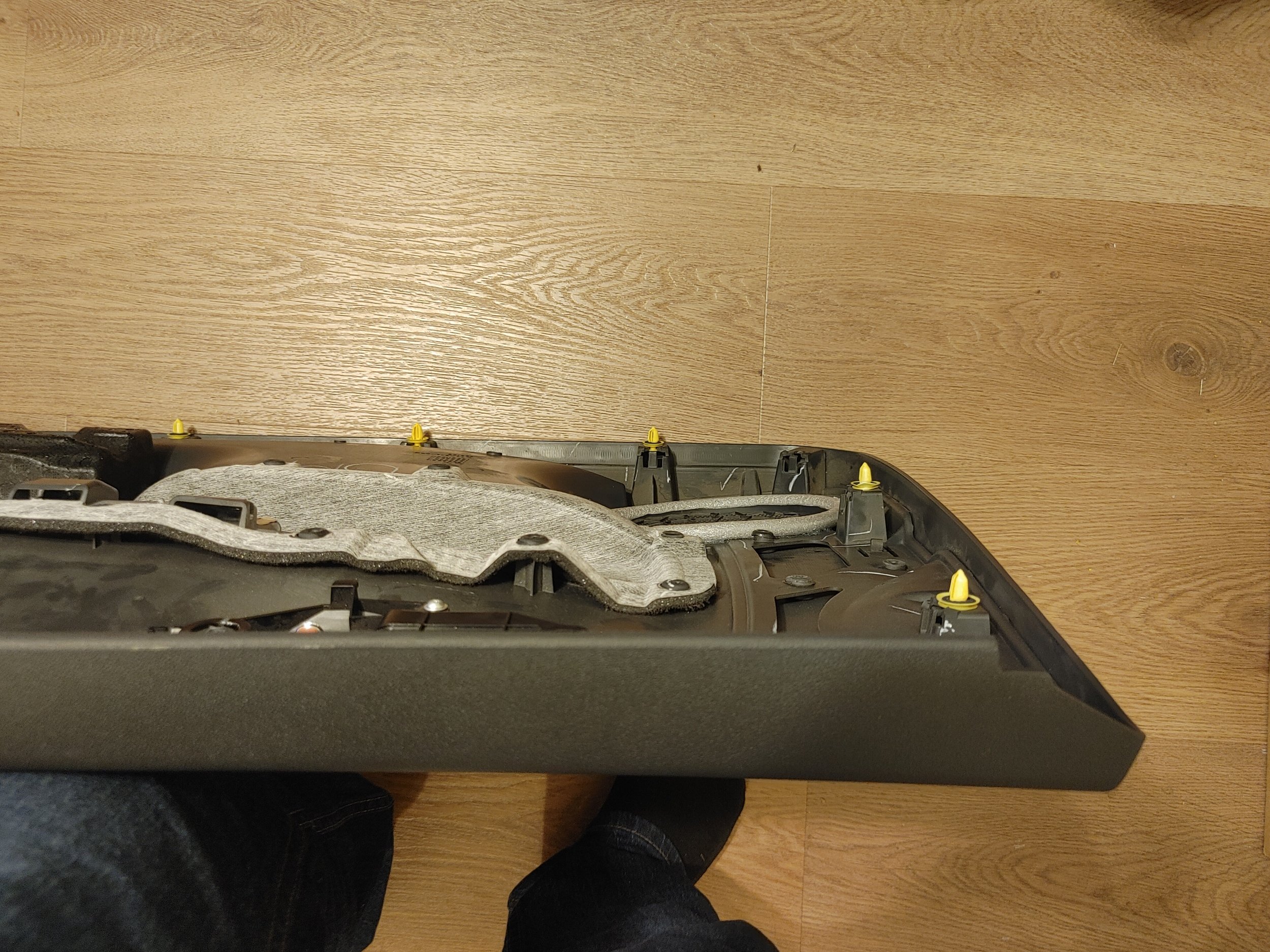

If you look at the panel the back of my door panel this is me looking down on it if you look in the lower right corner you'll see the speaker grill I put some foam around that so it'll hit the foam around the speaker and cause a seal but if you notice in the photo the speaker grill inside the panel is at a angle it's not straight so the foam on the back of the door is going to touch in one spot quite a bit before it touches in another spot.

Better view i flipped the photo.

Id take a Yard stick or flat piece wood across that door panel and measure both side of depth to see what you have, then measure on the door to see what you can do or have to cut/or remove
Yeah i need to see how far that door panel speaker grill is from the speaker in the door, and you see its not a even space probally a good 1/4 inch or more on that angle, more like 3/8 of a inch, why cant things be simple.

Well just measured back of door panel, that speaker grill is 1/2 inch off from one end to the other, more than i thought. So maybe no foam on the high side and 1/2 of foam on the low side. Cant figure why they angled it ???????? So to make sure i get a good seal im going to have to play the height a little, but thats not what is keeping the panel from going on. Im going to check all the holes where the tabs go in and make sure there is no foam or tape around them stoping the tabs from pushing in.

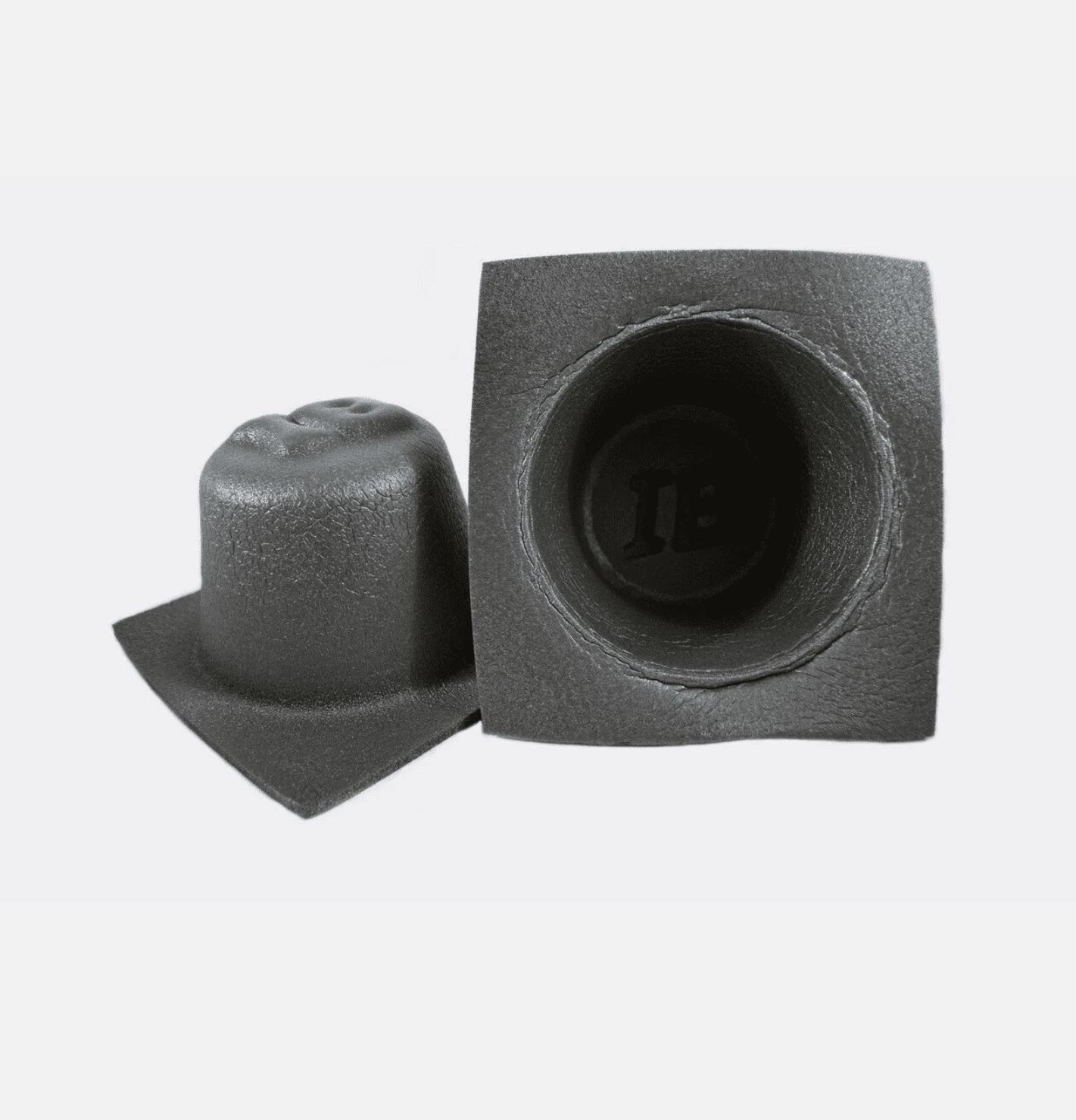

I like using foam baffles. I have had the current baffles ~4 years. As far as frequency attenuation, I hear no discernible difference sans baffles.
I put those in my F250 and they seem to be fine.
Really at the end of the day though being in a vehicle is an extremely harsh environment and you should not expect the lifespan you'd get out of a set of bookshelf speakers out of anything mounted in a car door unless you live someplace extremely dry.
