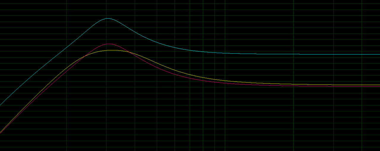

Here I did a 3 ft3 net for that 9512 tuned at 32hz... it's about as big as I'd go (realistically I COULD go bigger but 3ft3 is pretty big for a single 12 and it's 4.4ft3 gross) and it's got good output man... but as you see below those JL10w6's (yellow) on your power in your enclosure (if it's actually 3ft3 net?) look a bit louder to me.
So once again here it is... to noticeably increase... increase cone area significantly, add pretty much a doubling of power or .... both if you want to get louder for real.
Almost doubling power, redoing my enclosure and adding 2 more batteries and alt/wire took me to 147ish daily from 144 with 2 12's. And it was a HUGE difference with the lower tune... went from a 32hz tune to 30hz with the added power.
There's no magic solution man... The 12 looks to be less to me
Here I added those 13w7's above on a T2500...
Those lines are 2db increments so that's what... 7-8db
I compare a pair of Sa X15's in 8.75 ft3 net tuned to 30hz on 5K with the 10W6's on 1200 in 3ft3 net tuned to 30hz below.
Looks like over 10db difference to me... lol...

Waste of time man... it's only gonna be about the same. the added power will only fractionally increase the output, that'll put a 12 about where you are...  2 10's (the JL's on the added power might gain... but not much). Learn Winisd or BB6, do your diligence when researching new equipment and either buy an SUV or eat the cost for upgrades to your electrical and amps.

You realize that sound is measured and felt differently than can be expressed to a layman... it's measured on a logarithmic scale and in a perfect world doubling cone and power will net 6db. So that +10db increase above is HUGE.

I had to see and surprisingly the Type X (SWX1042D) on a 2K amp does show some gain ...(pink)... I like that X15 output tho... lol
Maybe 2db or so around 30hz but I'd take that with a grain of salt as your enclosure is in question... 3ft3 NET with 40-50in2 of port for that 2K looks like what I'd do and that's gonna be big externally. So the output you see above will be dependent on your enclosures ability to deal with the added power... so IDK really
