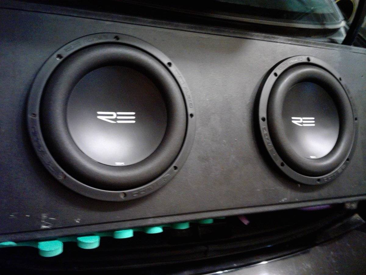

Ever looked into re audios? I currently am running 2 10's the re sxx they are 1200watts rms and budget friendly bought the pair 4ohms for 389.99 from caraudio savings.  Have them at 2000watts rms and just one xsd3400 battery. On the freeway where it will maintain voltage its loud and deep. Even at idle and window cracked  u can feel the air pressure. Now granted they are under powered as I  still have a stock alternator. But even so at idle in driveway and a decent volume where the voltage nvr goes below 12 they shale the house walls and garage door. Have them in a custom box of about 1.35 cubes net per woofer.. port is a lil small. I think 12 square inches per sub. Gonna build another at 16 square per sub and see if it hits harder. Tuned to 35 herts. I think in the right box what u have now can do the trick. Box is 3.7cubes gross.
