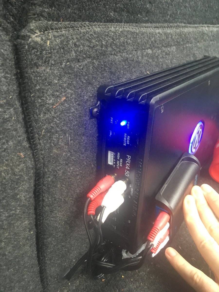

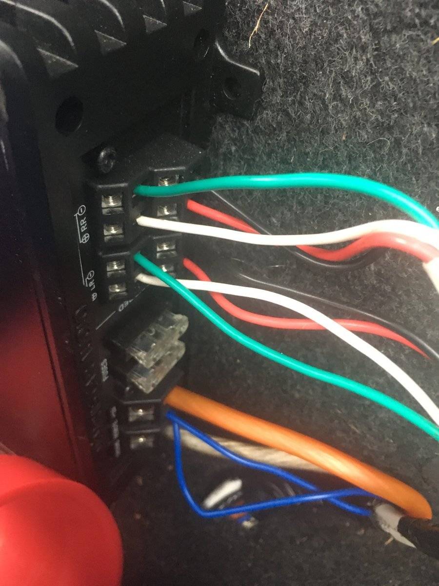

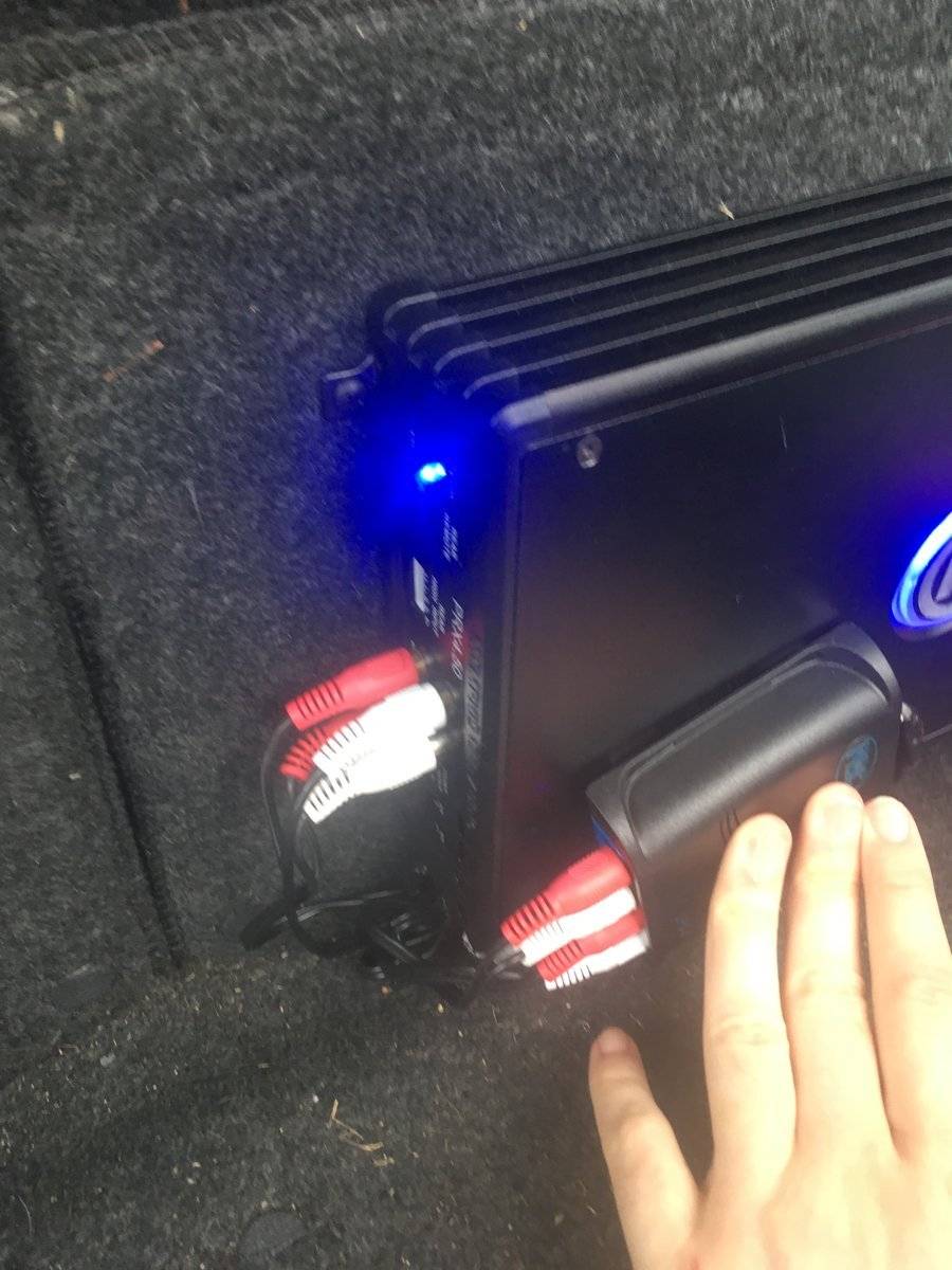

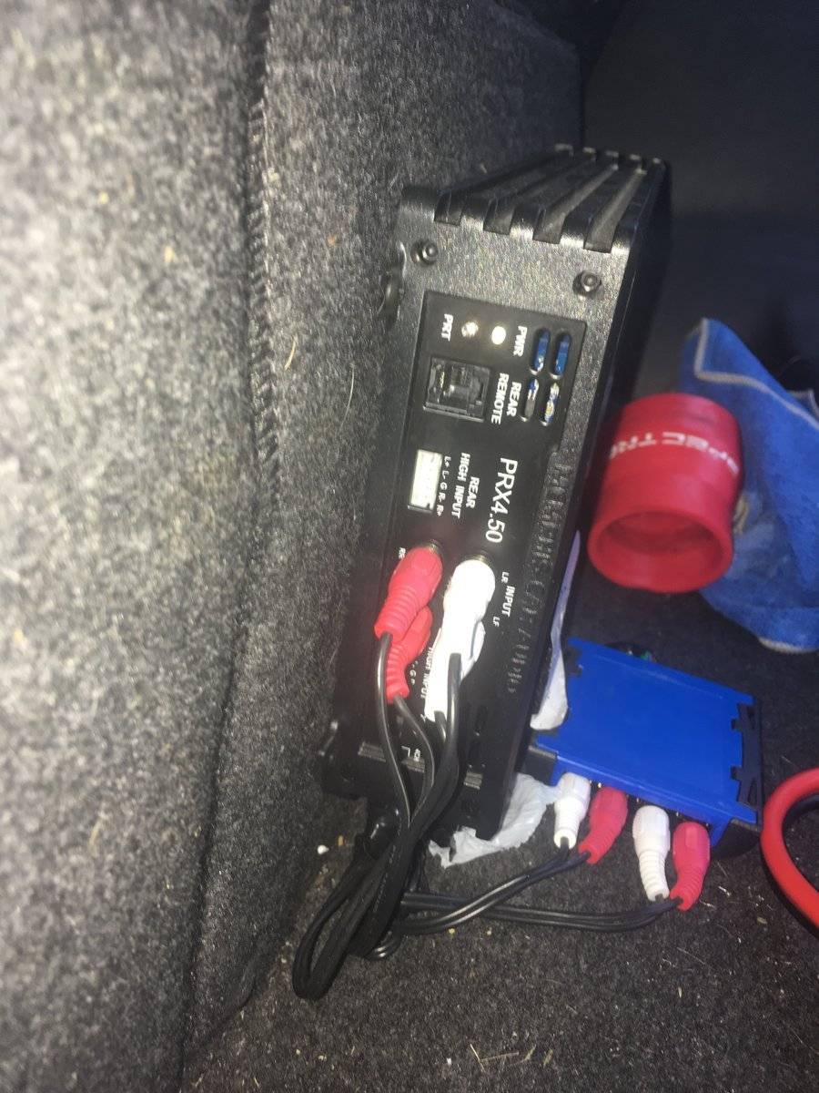

I don’t know where the high pass switch is located. I’m the only one that cranks it up lol I’ll send some pics. Sorry for not responding I was at work I turned loudness off now I can max out on low amp gain. Set it on the head unit the video is when loudness was on 2
