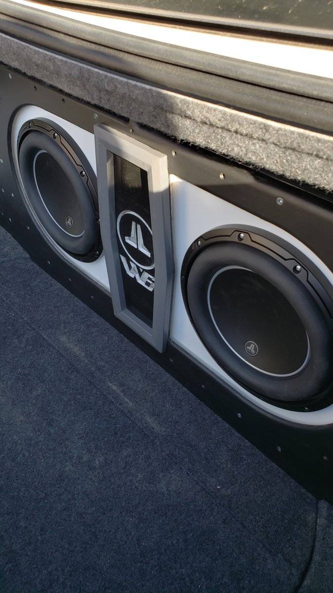

I have a weird design with my box since my car is all wheel drive. The back half of the box that sits on the trunk is a step design. I'll post a picture but it's with a beauty panel on.
Yup 2012 acura TL. Car is a pain to get loud as my back seats dont fold down and only have a ski pass. Was thinking of doing a bandpass box through the ski pass but limited on trunk space.
that's  a nice setup. I don't  understand the rave with the 13w7 JL. I see them all the time for like 2 for 800$ 1 for 400$. I just don't  get it. Isn't  sundown and many others way better for that price and put out double of those JL subs?
