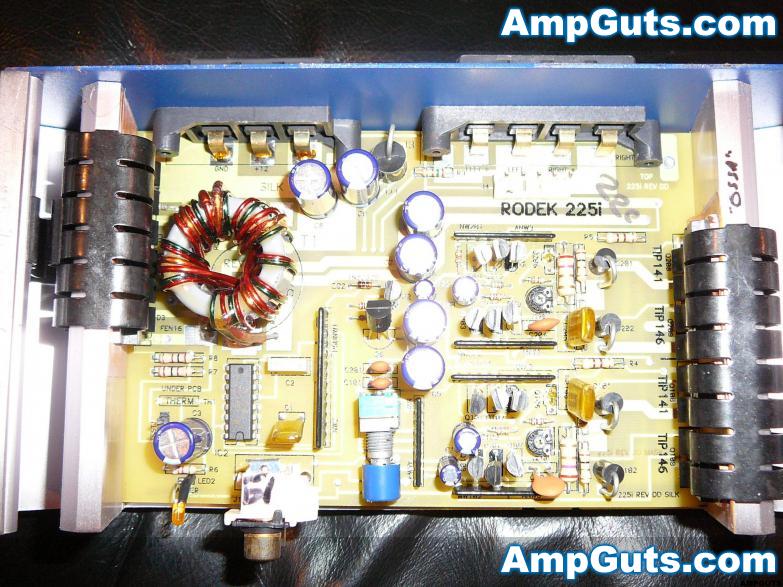

Ampguts posted a picture of the inside of my 225i. It's a very clean amp inside and out. Cool looking board!

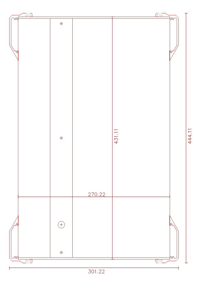

So if you've been following this build, you know that the plan is to have black frames made for the amps out of black acrylic. Well, I heard back from the acrylic shop today that it would be very expensive to work off of the tracing of the amp I provided them because the shape is so complex around the corners. They would essentially have to do this cutting by hand. It would be time consuming and inevitably have some flaws. The estimate was over $300 for the two pieces. So in desperation, I contacted Stephen Mantz over at Zed Audio. Stephen was very cool and came through for me BIG TIME. He provided me with .dxf and autocad drawings of the amplifier shape which the shop can import into their computer to have the pieces machine cut. I can't thank Stephen Mantz enough for providing these. It sounds like he had to do some work to draw them, too, so it took some time on his end. You really would not get this kind of service with any of the "made-in-asia" manufacturers. Major props to Zed Audio here. Just awesome...
Here are links to the drawings I put up on my server in case anyone now or in the future may find them handy for their builds. According to Stephen, these would need to be printed 1:1 and then could be used as templates.
http://www.theamericannight.com/images/DEUCE-OUTLINE.dwg
http://www.theamericannight.com/images/DEUCE-OUTLINE.dxf
Lastly, here is a .jpg which I am providing just as an example so people know what they are getting in these files:
The acrylic shop just called and notified me they were successfully able to import Stephen's drawings into the CNC machine. The amp frames will be ready today! Look forward to picking them up this afternoon and sharing a picture of them here.

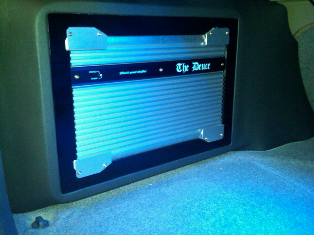

Finally was able to pick up the acrylic frames from the shop yesterday. They look sweeeeeeeeeeet! Thanks again to Stephen Mantz for making the auto cad drawing which the shop was able to import into their CNC machine. Here's a photo of the black acrylic frame on the amp. It's made from 1/4" black acrylic.
