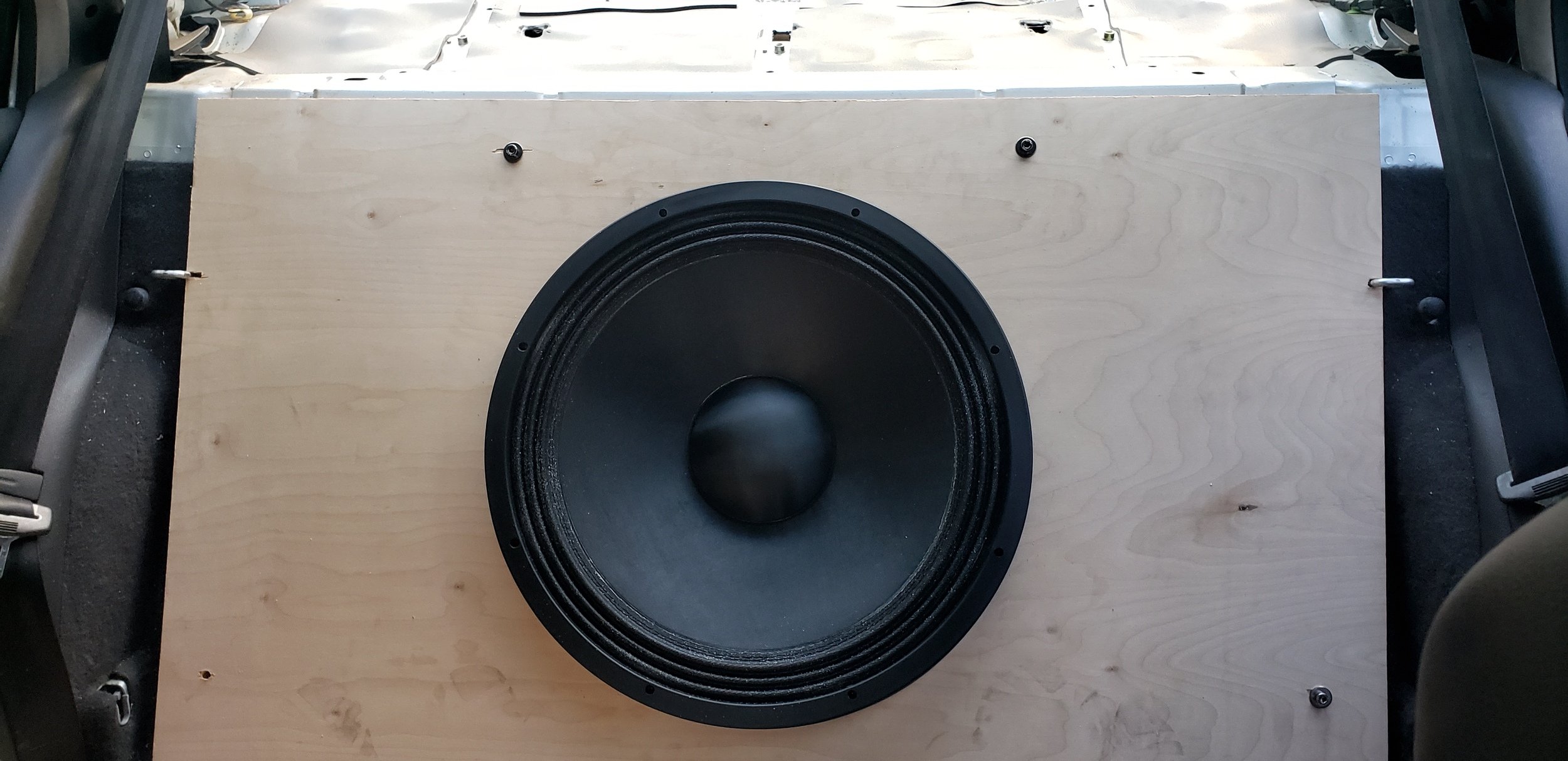

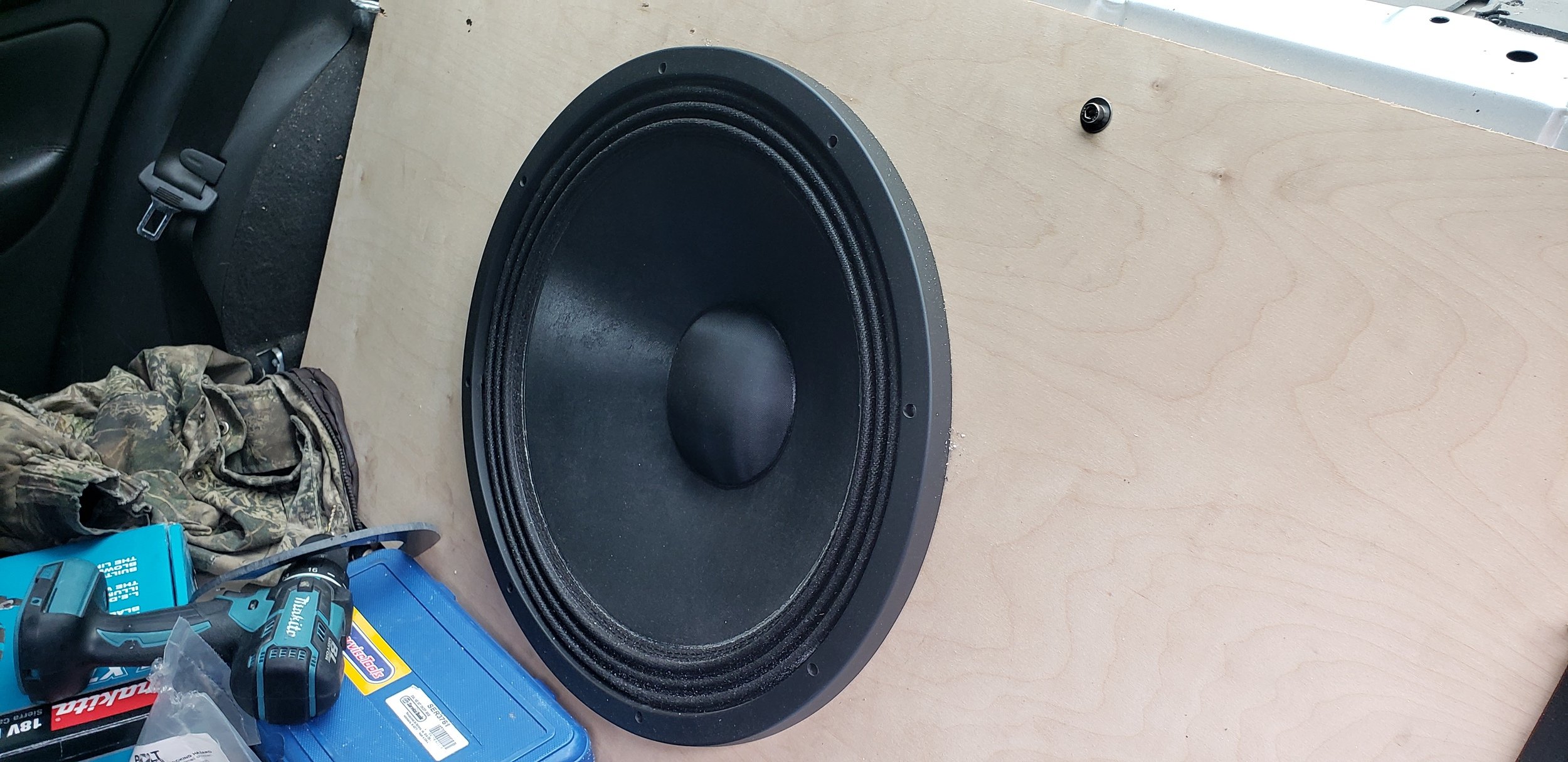

Lol, comments like that are the reason my jetta no longer has back seats and looks like this:
It will fit, you just have to make a little room here and there...
Matt
I'm a bass head through and through. I have a MK4 jetta with a single 18 I currently. In the works is a new baffle to run a pair of 18's IB while I sort out finances and can finish the final enclosure for the back seat area.
