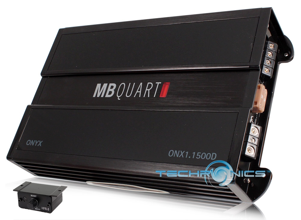

look at a mb quartz 1500 or a audiopipe ap 1500 thats pretty much all you'll get on that budget ,if you up your budget a bit ,you'll get a better amp that will last longer and have a better efficiency for your sub

MB Quart ONX1.1500D ONYX Series 1500 Watts RMS Class D Monoblock Car Amplifier
