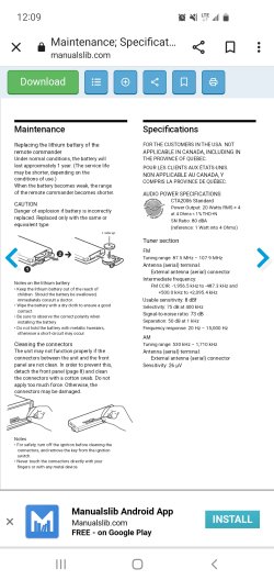

I don't know the car audio radio standards, but the radio has a Signal to noise ratio of 73db, which it seems awfull to me. In HiFi it starts to be okay when it is over 95db. Are SNR in car audio this low?
By the way, in the item description of that radio says it has crossovers built-in. Isn't this way with all the decent radios?

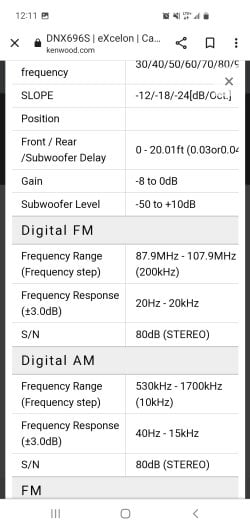

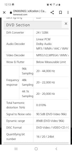

What radio are you referring to? That sounds like the am or fm signal to noise ratio. Cd should be over 90 unless its a terrible deck.
The radio is a Sony DSX-A410BT. It is supposed to be a good one.
Maybe you are right and those 73db SNR refers to the FM. Can you check it, or tell me how to find it out, please?
Looks like your am/fm is 73 and your overall is 80db.
