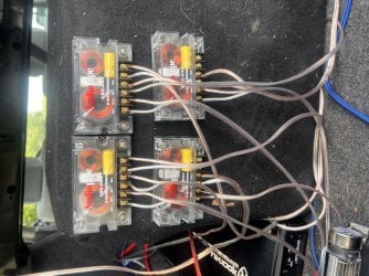

System was fine. Have 4 components 2 tweeters hooked up to 4 passive cross overs, 2 of the crossovers only had components on them. Just wired the second pair of tweeters to those crossovers. Now when I turn the car on extremely loud buzzing humming noise comes out the the components. I then disconnected the tweeters I just wired still have the noise, if anyone can help I’d really appreciate it

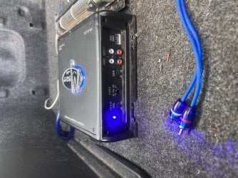

With the sytstem off, disconnect the rear RCAs then turn it on. If no noise, check if amp has option to use front RCAs as main feed. Test it.
So with the car running now rca connected to the amp. I connected the rear the red one to the amp nothing happened. I then only connected the white one witch I believe to be front that’s when the noise happened. Is there any why I could take a video of the noice and send it on here ?
Others have posted video but I have not. So I do not know if it is as easy as posting a picture. Go to Attach Files, it will link you to your phone's storage. From there choose video if it is available.
Usually Red is Right and White is Left. Would you post a picture of the the RCAs connected?

This video was the first time it went into protection.
  • IMG_3836.mov
    29.2 MB
