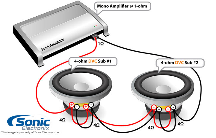

Two 4 ohm DC lvl 2 to 1 ohm stable
And these are d4's? Wired parallel/parallel?
D4, wired just like this.
How can I get it to 1 then? Amp says that it's only putting out 700 at 2 ohm
Add another 12 and it will get you closer, just can go under 1......
What amp you running? I also wonder if your dmm is calibrated. Do you have access to another one for testing?
Add another 12 and it will get you closer, just can go under 1......What amp you running? I also wonder if your dmm is calibrated. Do you have access to another one for testing?
Amp is a DC 1.2k. The dmm also works, I have a couple of them. I've also wired everything so that all I need to do is put the top on the box and call it finished. But when I play music (setting gains) the subs barely play. I tested the terminals where the speaker wire go and it's hitting 20 ohms.
How did you set the gains? Should be around 37-38v ac.
Ok I touched the leads together on the dmm again and it read about .8, so disregarding everything the ohm load is now somewhere around 1. But when I start playing music, it shoots up to ~25 ohms and just fluctuates. Is that normal?
With the right gain setting you should have no more than 35v ac to the subs@ 1 ohm
