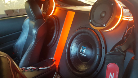

Still in the process of fabricating the trim panels and figuring out where a bit more deadening is needed. There's a resonance frequency in the car itself around 40hz goes crazy at loud volumes and I can hear it buzzing/flapping/ripping itself to pieces... been a pain trying to find it. Got plenty of deadening already but chasing problem spots never ends sometimes. Cable management is still outstanding for the most part, stay tuned for the "clean" look.

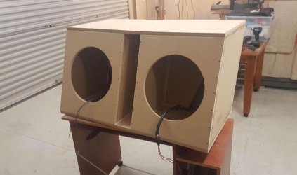

- How did I fit this in such a small car? Angle grinder go brrrrt.
- Who built this? I did all of it myself with assistance from a friend, from design to construction to installation.
- Is the artwork made with AI? Partially, and partially hand edited with Photoshop. Took me 5 days to make it and be happy.
- What does it meter? No idea, because I'm not metering it until it's at full power but I'm guessing low/mid 50's

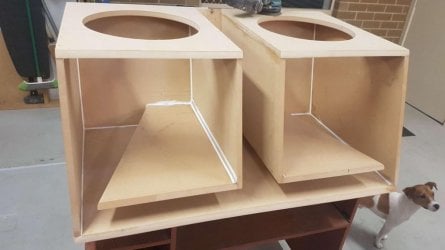

- What are box specs? 7.45^3 total before displacement, around 3.25 per sub after displacement. Port tuned to 32Hz with two peaks at around 29 and 36, smashes lows down to about 26.

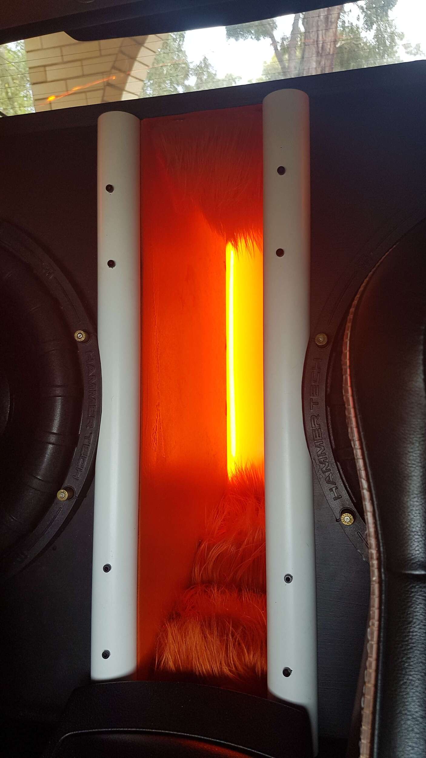

Unfortunately, my port velocity is a little high on frequencies below about 30Hz, so I helped the situation quite a bit by adding some fuzz. The mounting holes on the sub gasket also plugged up with some 9mm casings my buddy fired at the range... they fit perfectly!

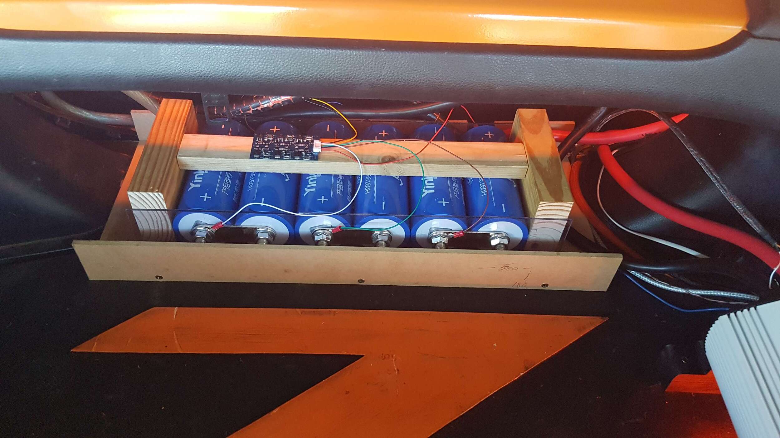

YinLong finally arrived after a 2 month wait!
First half of the battery box is built and in the back with the cells all hooked up. It's not pretty yet and there's zero cable management. Just had to test it out first before I pull it down again and make it look nice :D
I will make a lid/cover and add some nice handles with some lighting and maybe kick them up on a 45° angle or something... paint it all, etc.
Here's a pic of the current test fit:
I can finally really give it the juice, tomorrow will be spent doing a full re-tune but even on the current amp configuration, it already sounds a LOT better.

Have also done a little port work and installed some round-offs which I have yet to paint. I also added some fur on the short walls of the port to try and slow down some of my air movement. In combination they've both helped quite a good deal with the velocity issues I was experiencing to the point where I only hear chuffing at 24-25Hz, at the worst spot in the curve.
