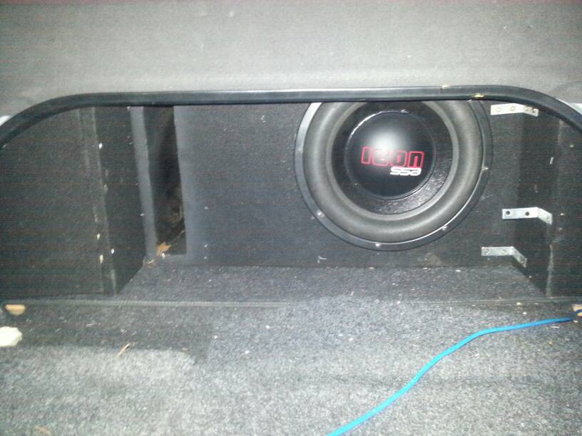

Mine. 90% sealed off. All of the back deck covered in deadener anda bunch of expanding foam between the metal and the plastic back deck cover. You cant see it but that back deck is now chemically bonded to the metal. So no air escaping that wall.
