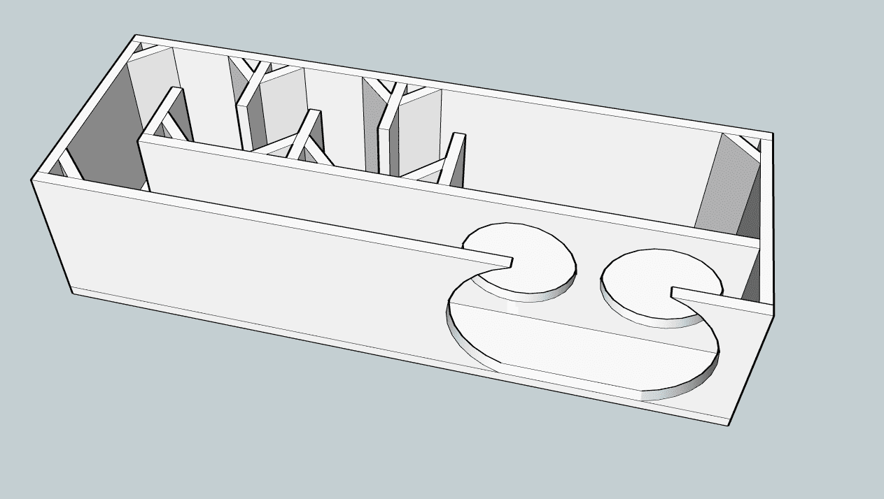

Other plans have been made for the other enclosure so I started building this tonight. It's a transmission line tuned to 35hz with a .85ft^3 compression chamber and it's kind of self loading. It models up well and should fit in the trunk just fine.
Design:
Should sound nice, get loud enough, and get down low with ease:

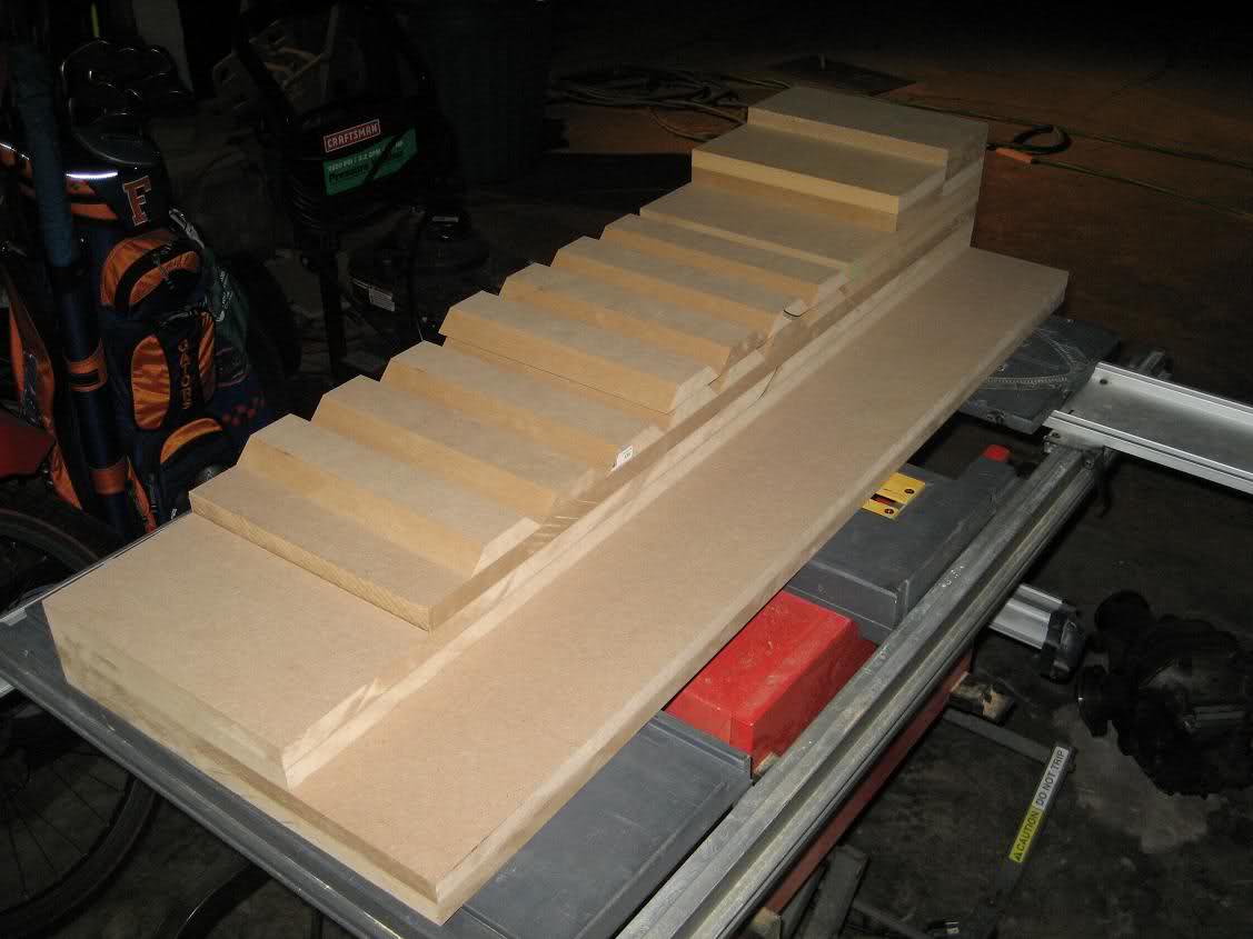

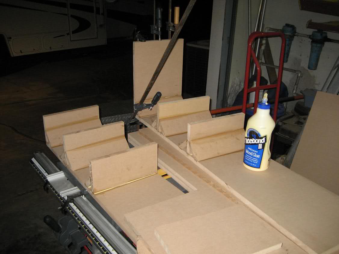

This one requires much less wood than the horn:

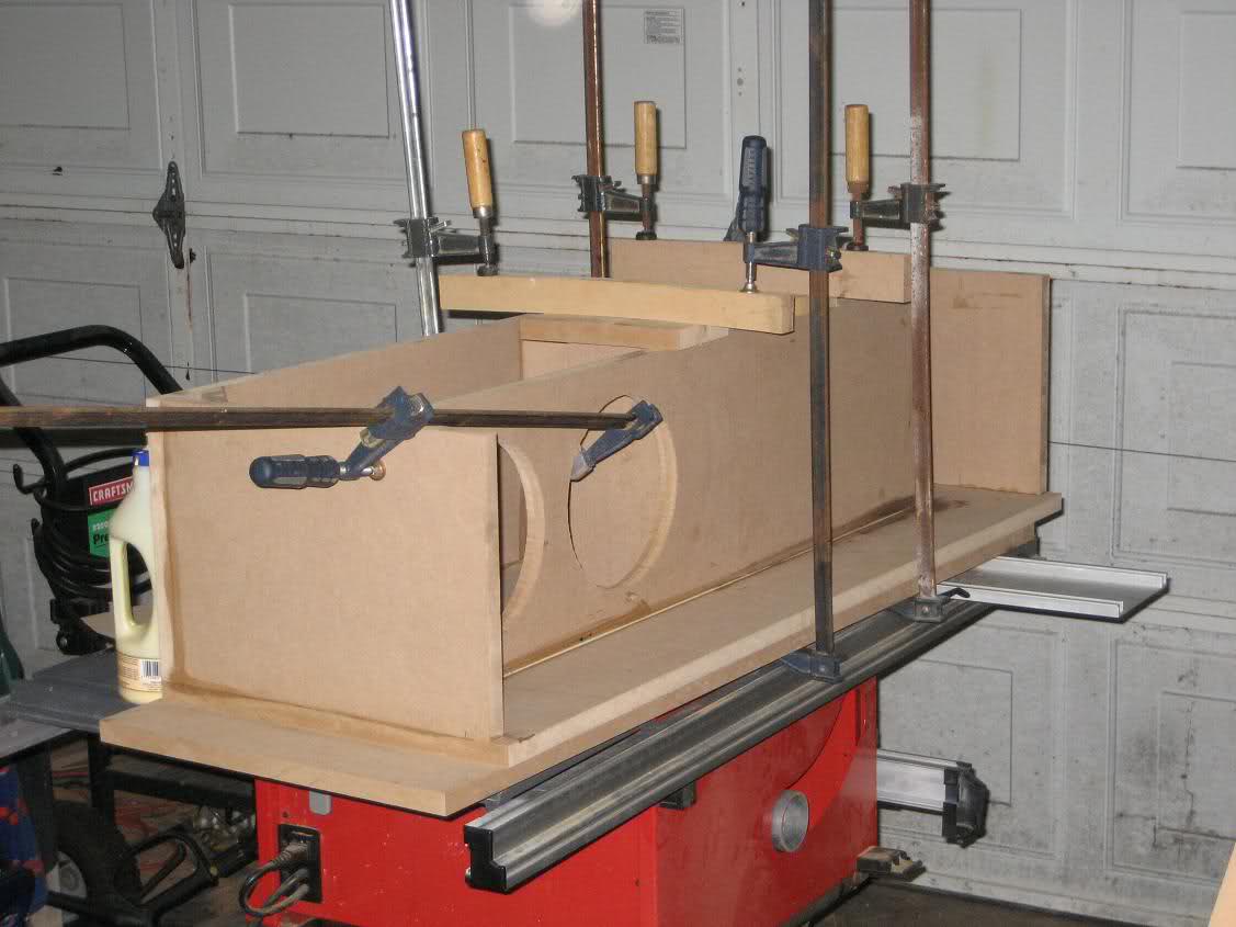

Once this dries, I'll route the mounting baffle out and then it should all slap together:

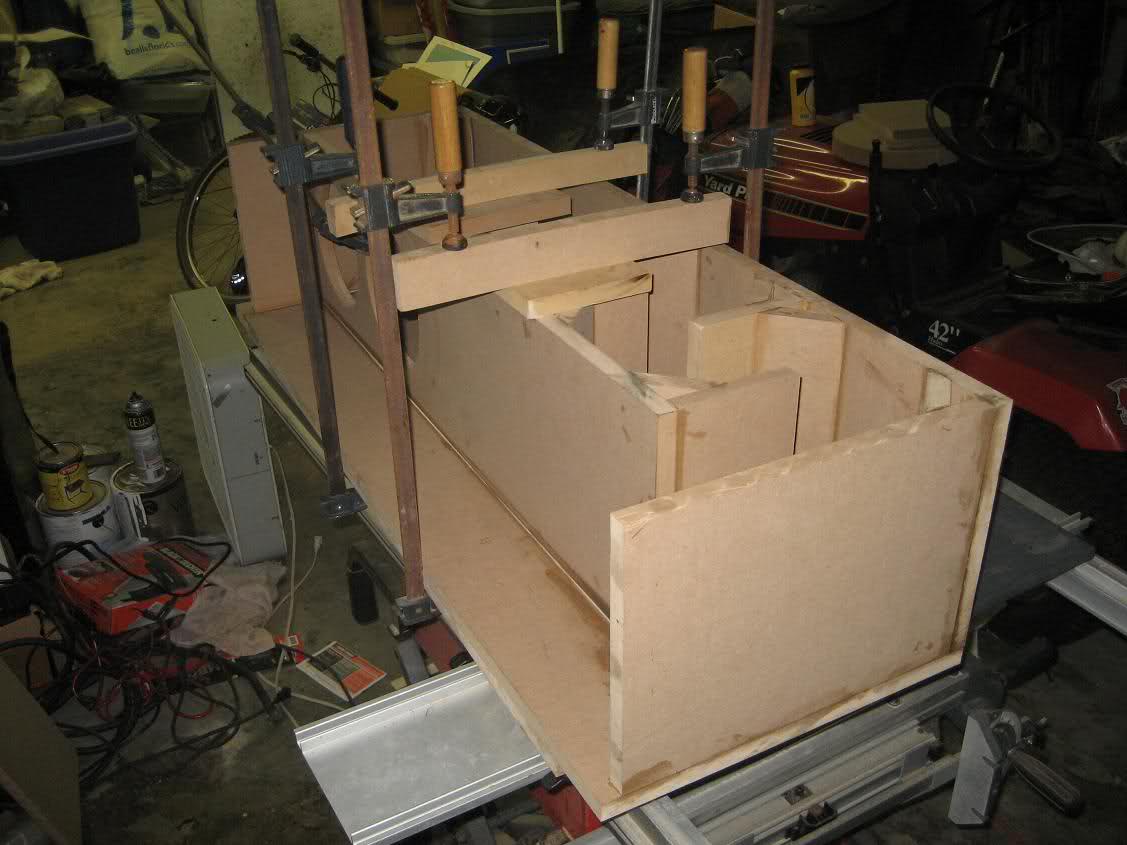

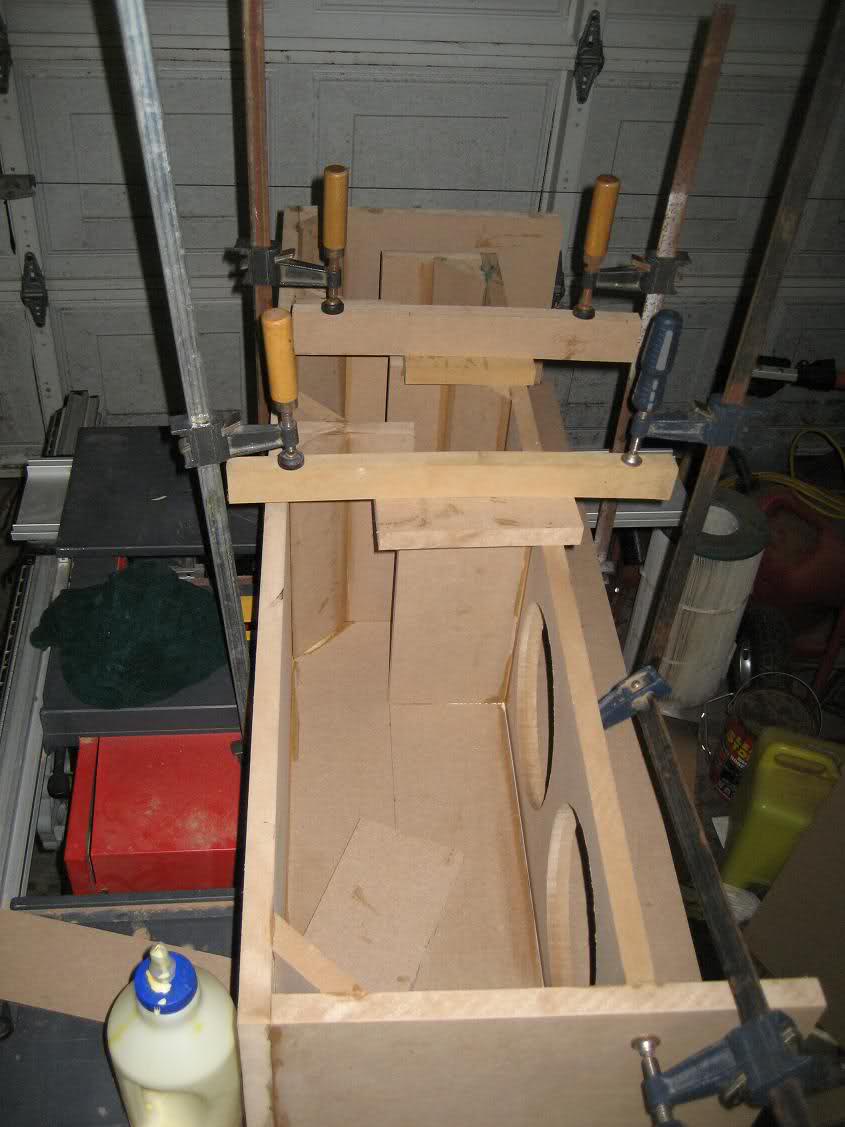

Hopefully I'll have it drying tonight and can route the outer baffle and get it installed. At the very least I should have it in my room to get a listen.
Baffle is currently being clamped and once it's dry, I'll put the front panel on and then I only have to get the top secure. I'll finish routing the front tomorrow and probably do some rounding over as well.
Haha, yea, it should fit. And no, I don't use any screws. They are only an annoyance to me when finishing so I just clamp and glue. I'm ok waiting the 20-30 minutes for the glue to set. My cuts are usually square enough that I don't need screws to try to force it sealed. The only time I use them is if I'm in a rush and the person I'm doing it for doesn't care.

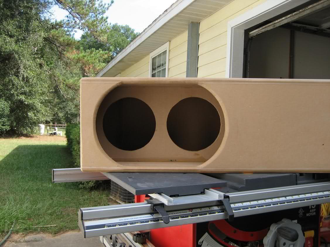

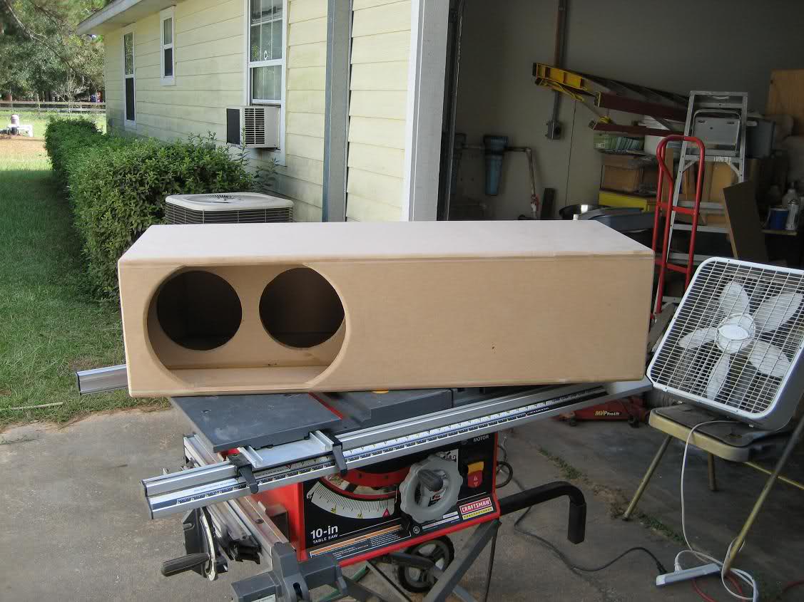

Thanks. I just finished some routing, sanding, and rounding and I took some pics.

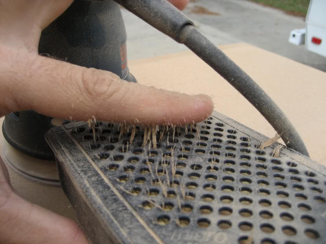

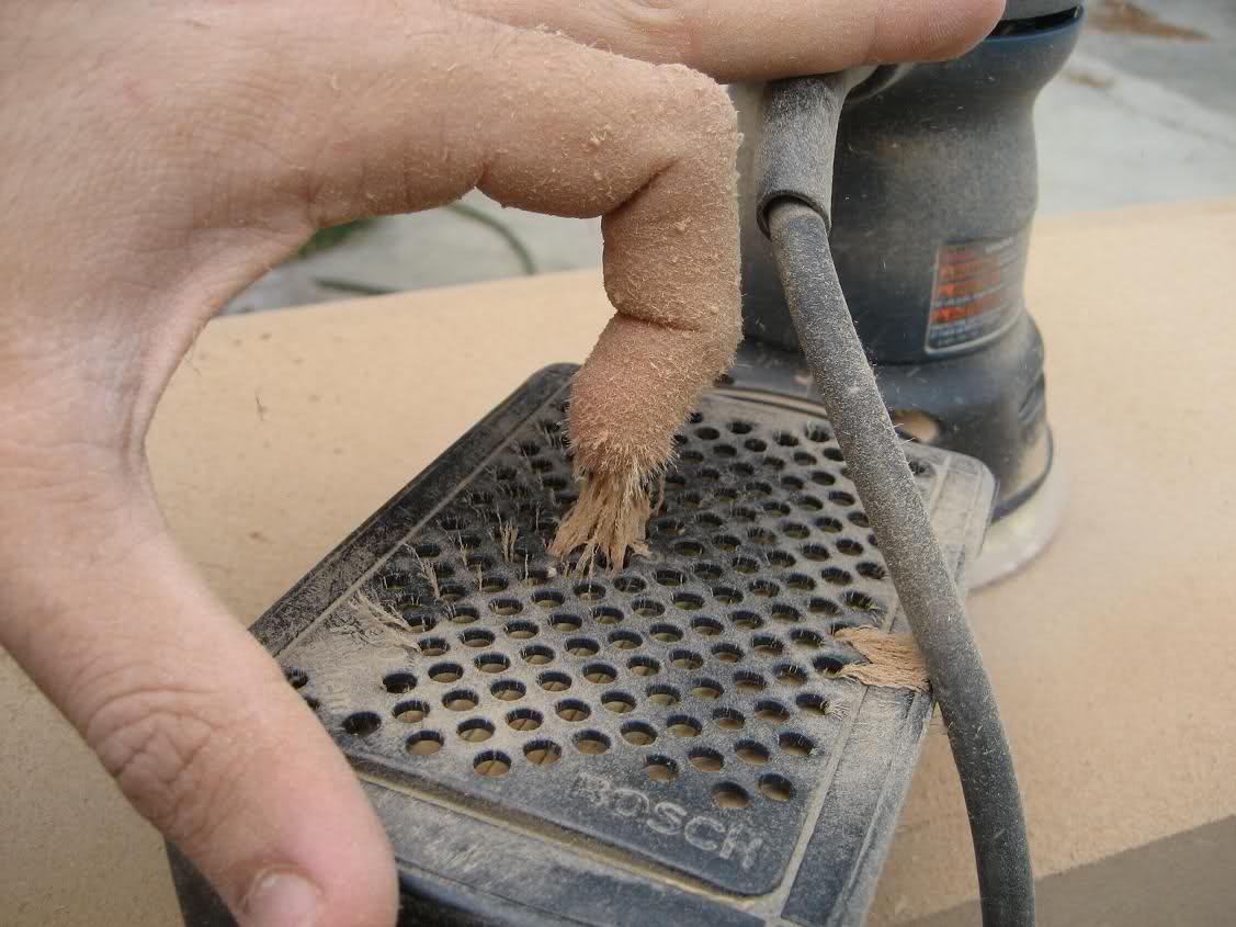

I found I need to change my filter as it came loose inside letting out a ton of dust. I also found that when it's on, it attracts to my finger like hair does with static. Pretty ****ing cool looking and feeling:

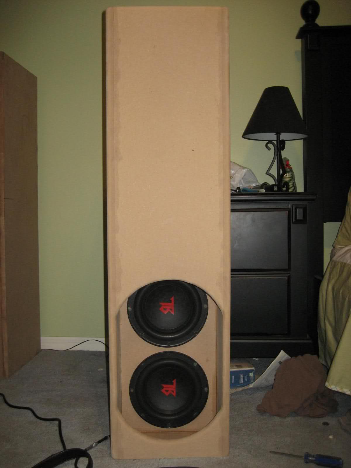

Front baffle routed:

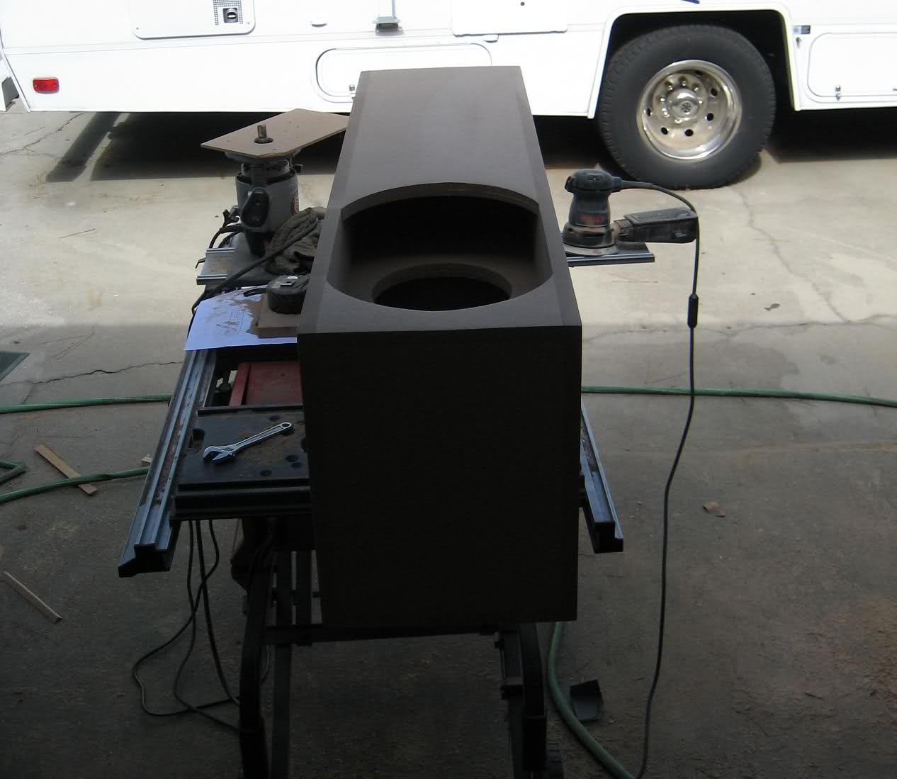

I am about to head back out and smooth out the round over by hand and then take them for a test ride!

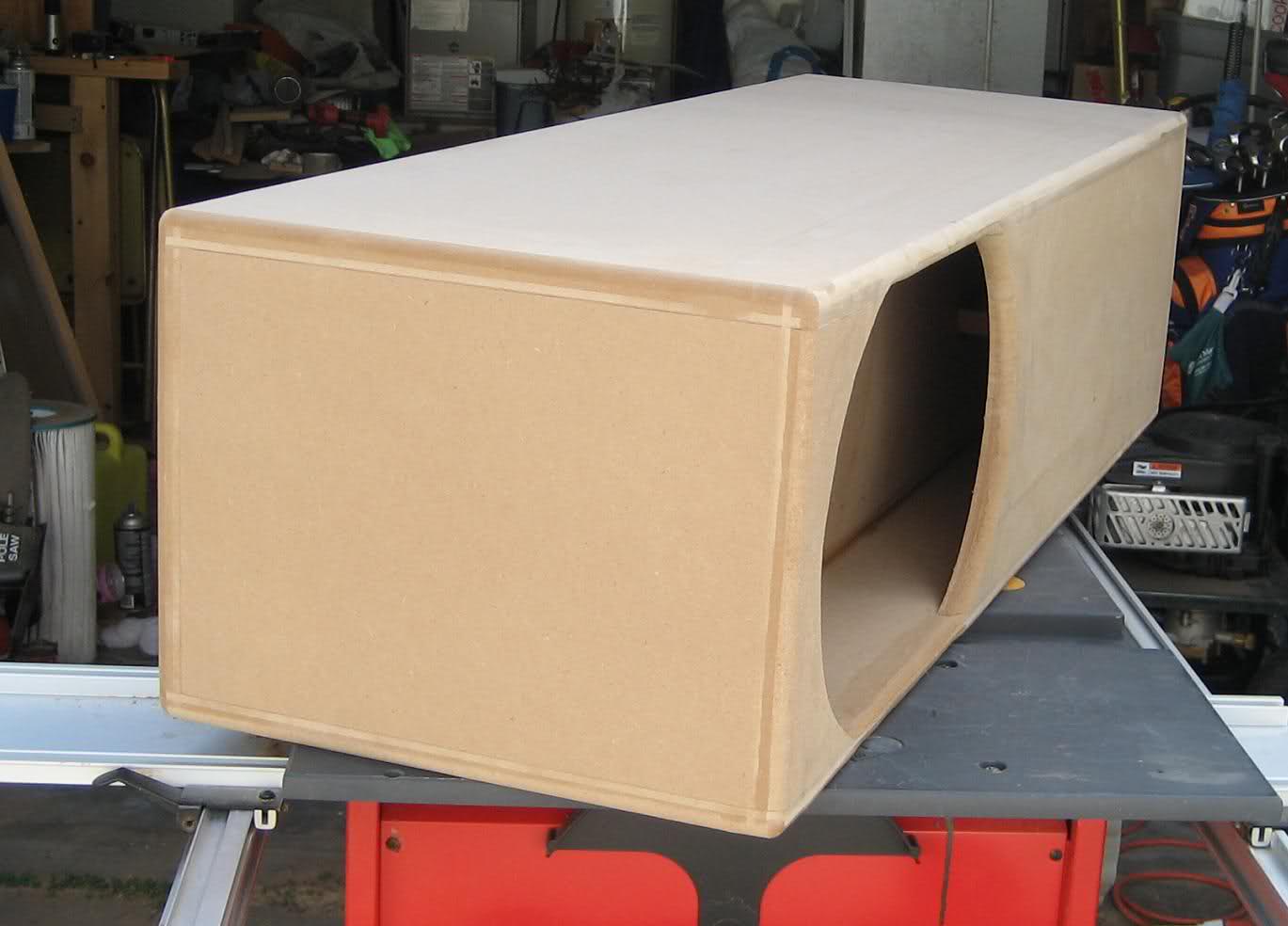

Got everything sanded down and pretty and have it running in my room right now. It sounds very similar to how it models and so I'm pretty **** happy. It's noticeably not as efficient as the horn but it sounds a little cleaner (that could be due to the air leaks I had before taking them out and I don't have those problems with this one). The low end extension seems more pronounced too but that makes sense with hoffman's iron law. I gained space, low end efficiency, but lost over all efficiency.

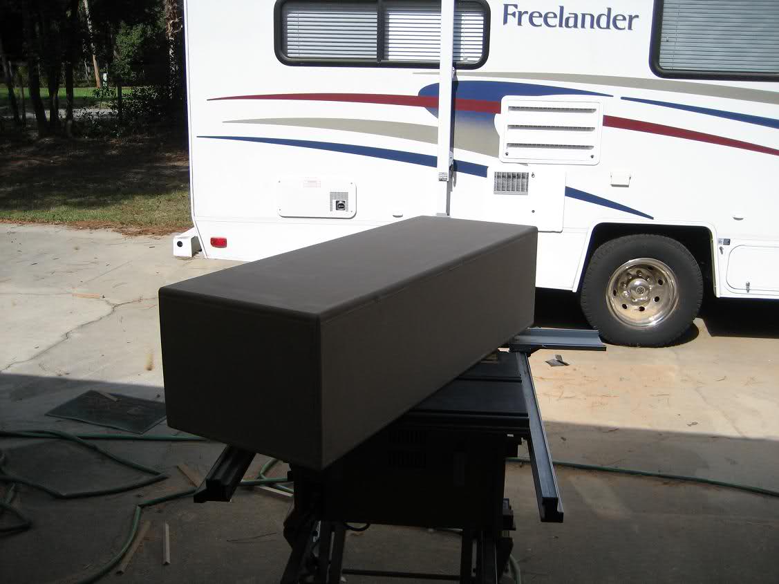

Here it is setup in my room and ready to go in the car:
All I need to do now is run my power cable and I can get the amp and sub in the car and see how it sounds there. After listening to a few songs, I'm VERY impressed with this. It's still plenty loud, plays plenty low, and sounds extremely clean and seems to be pretty **** flat from about 25-120hz or so! It sounds better, gets louder, and plays lower than my IDQ 12 and I would say in my room that they're as loud, if not louder, than my AV12 too.
Box is nice, but im confused. Looks like you have 3 diff boxes there. One is painted black, but not rounded over or anything, and one is rounded over but not painted black, and the other looks like birch?
