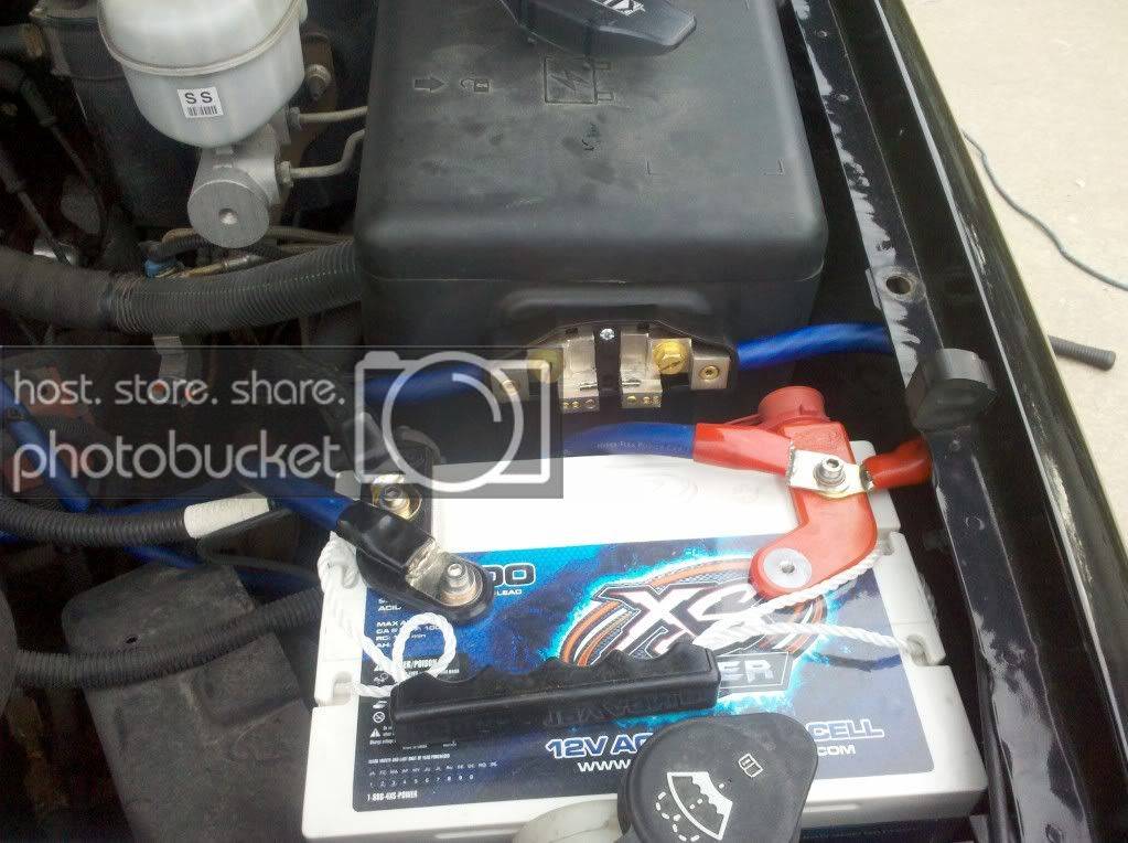

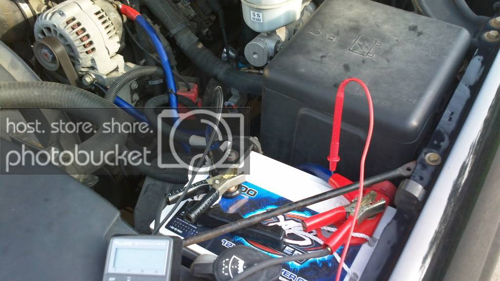

Big 3 is done:

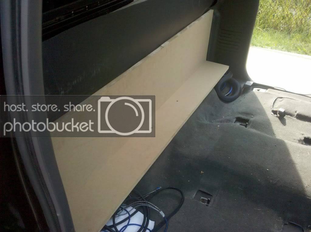

Amp rack is started:

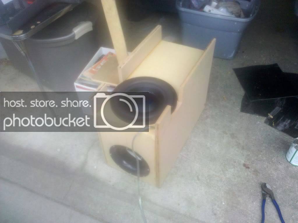

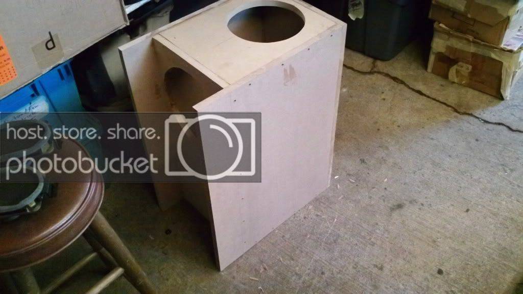

And I built the (first) enclosure a couple days ago:

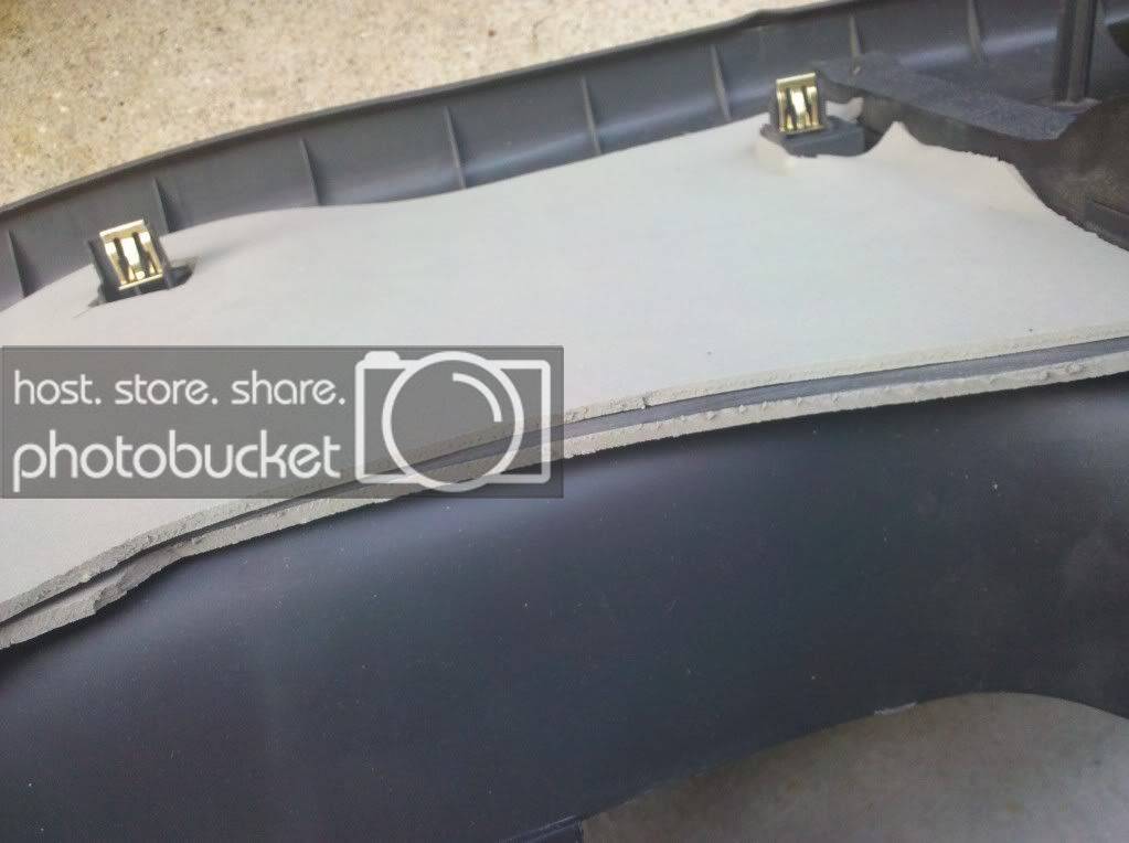

Forgot to mention that I put 2 layers of CCF and MLV on my b-pillars. One small piece inside the pillar behind where the rear speaker usually is, and then then put another layer on the b-pillar plastic panel itself.
This made a HUGE difference in ambient road noise. This is what I'm pleased about the most so far, as that area was a big contributor to overall cabin noise.

Here's what I did to help combat road noise that comes from the B-pillar since I can't really get inside the pillar.
It's a layer of MLV with a layer of CCF on both sides. This way it not only absorbs noise coming through the pillar, but the additional layer on the inside helps reduce panel rattling.

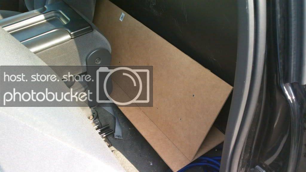

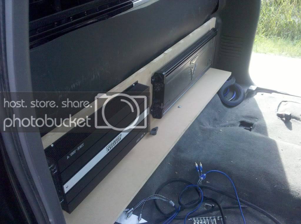

Also, after getting this mammoth enclosure in the truck, I realized my old amp rack had to go, so I whipped up a new one that's actually easier to put in and I think will look just as nice when finished:

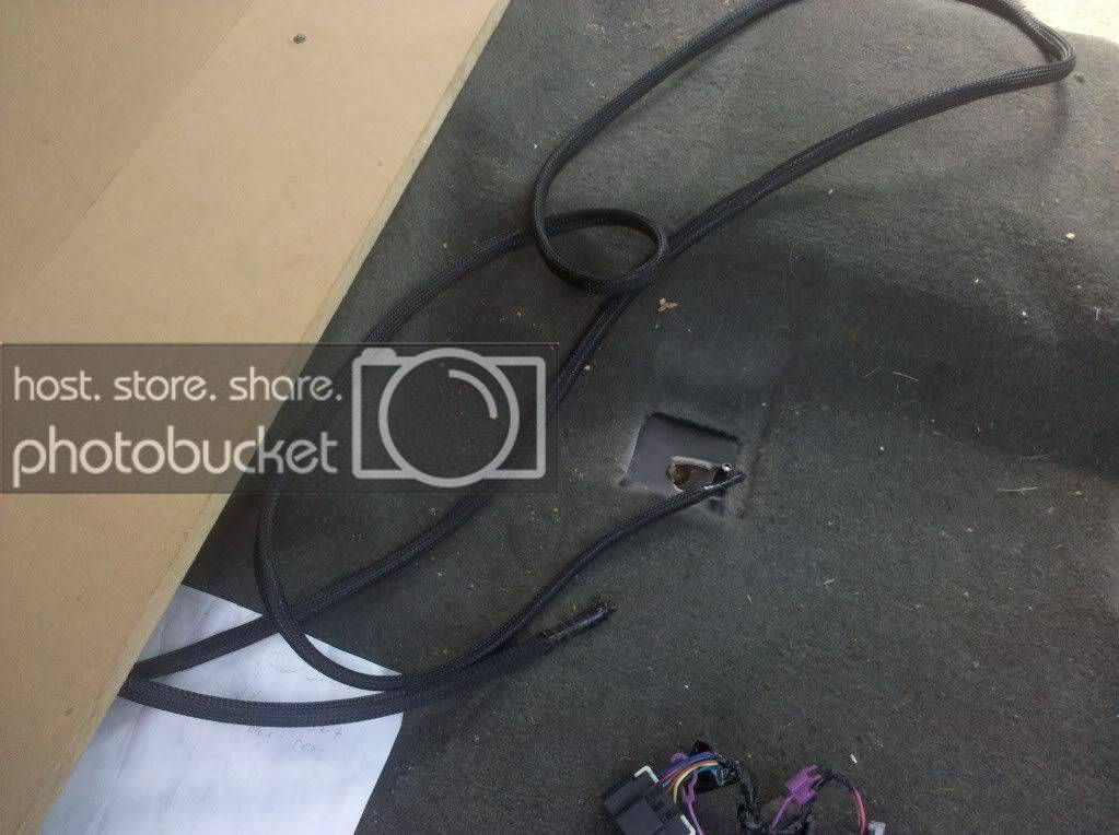

I also got all the wiring ran for the front stage speakers, all covered in tech flex:
Amps installed:
I still have to get my 2nd batt (and maybe 3rd depending on the sizes I can fit), so the layout may change a little, but I'm pretty sure it's good where it's at.
Enclosure wired up and ready to drop in:
I didn't finish it because I wanted to make sure I was happy with the performance before I carpet/vinyl/paint it (haven't decided what yet).
Wired up at the front batt:

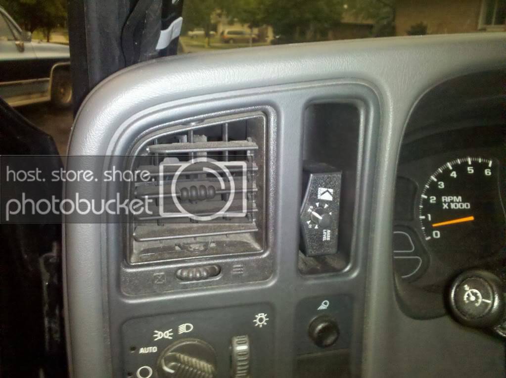

I also found a nice cubby for my bass knob. //content.invisioncic.com/y282845/emoticons/smile.gif.1ebc41e1811405b213edfc4622c41e27.gif

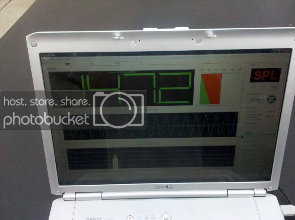

And, well, it wouldn't be me if I didn't do some SPL testing. //content.invisioncic.com/y282845/emoticons/biggrin.gif.d71a5d36fcbab170f2364c9f2e3946cb.gif
As of right now its done a 139.8 sealed on the dash, and as expected it gained a CRAPTON outlaw:
Check out that peak frequency...35 hz! Little low for my liking (and my music choices), so I swapped in a shorter port which bumped it up to 40ish hz. Lost a little on the score, but I think it sounds better. Regardless, I may build another enclosure because quite honestly this thing is beastly huge and a little tall for my liking.
