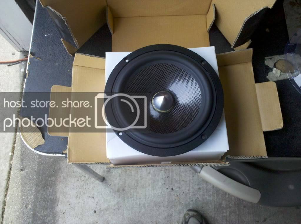

Here's the mids I'm using. Ascendant Audio 7" carbons:

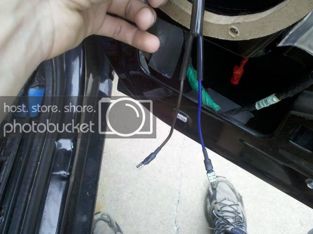

Passenger door wired up:

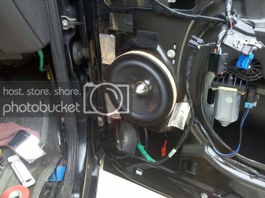

Mid installed:

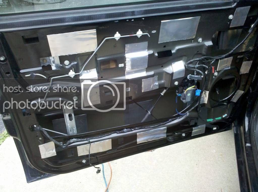

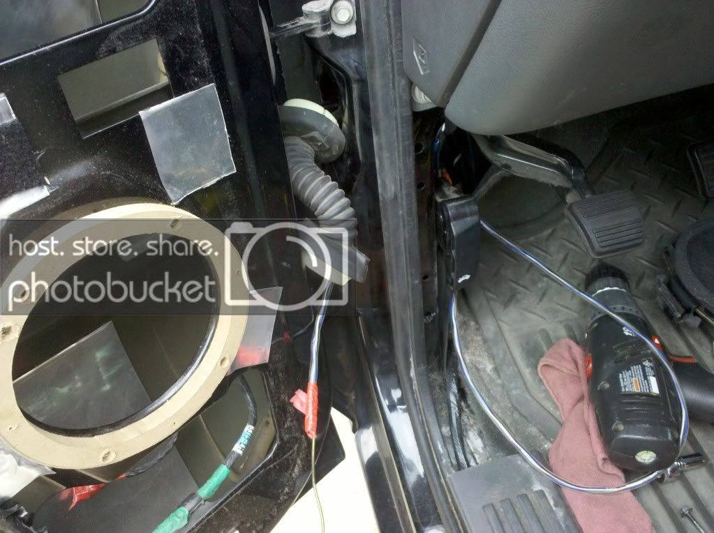

Driver's door covered with CLD tiles:
Fun feeding wire through the stock wire boot.

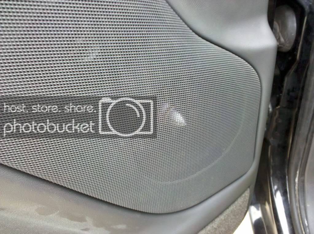

Driver's door cut out a bit and reused the stock grille so everything looks stock:

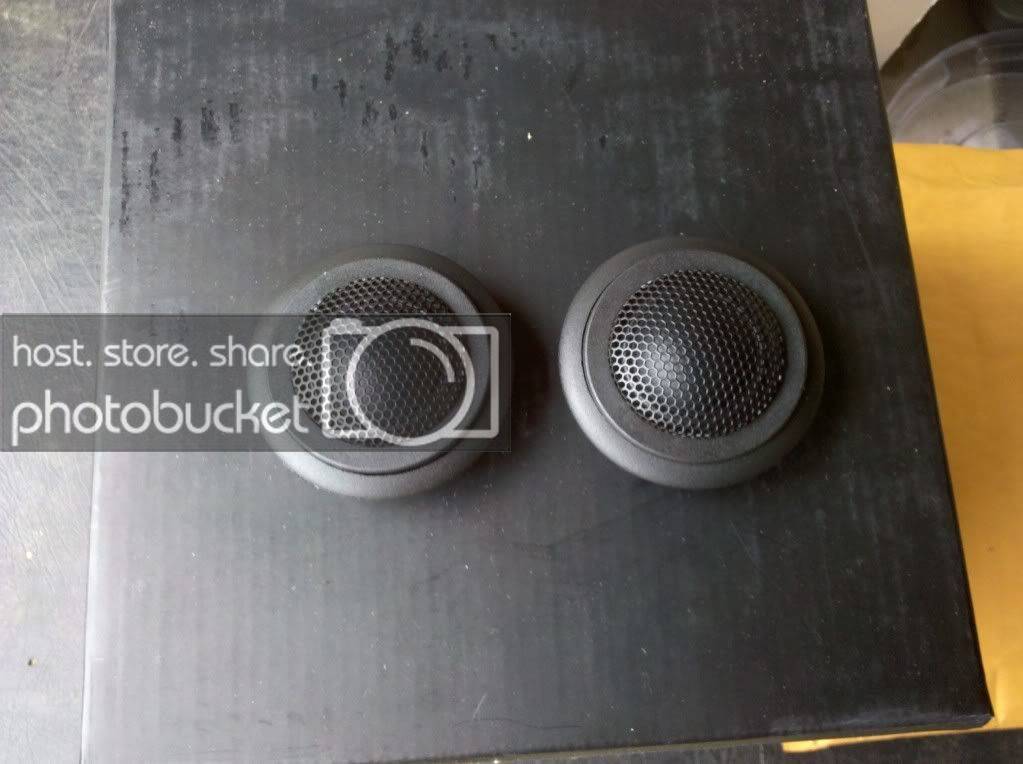

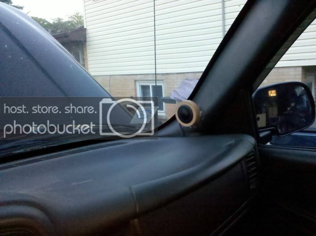

The tweeters I'm using. LPG 25NFA 1" silk domes. Sound AMAZING.

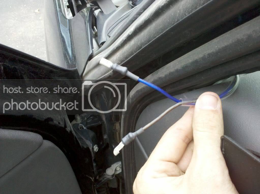

Tweeter wiring:
The temporary mount for the show sunday. I'm still playing with the positioning a bit:
The only bummer of the whole thing....one of my tweeters is bad. //content.invisioncic.com/y282845/emoticons/frown.gif.a3531fa0534503350665a1e957861287.gif And, of course, I find this out a half hour after madisound is closed for the day. FML.
So I'll either be rocking one tweeter for the show sunday or I'll magically be able to get a replacement on saturday. Either way it's nearing completion!

Did you just use hot glue to attach the tweeter rings to the A pillars?? I will be doing a similar build in my truck shortly so watching this one very close. Looks great so far!
Great tweeters. Where did you pick up those mids? I saw some on the forums about a month ago and I was going to snag them up.
I picked up those mids a while back from my good buddy Nick. //content.invisioncic.com/y282845/emoticons/smile.gif.1ebc41e1811405b213edfc4622c41e27.gif
Hot glue actually wouldn't stick to the plastic, probably because I didn't rough it up. I ended up using goop and that held fine.
