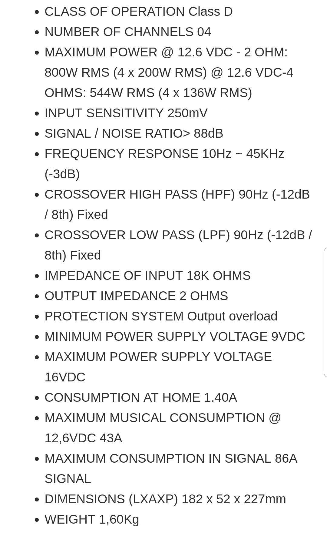

Taramps DS800X4 2 ohm version will give 136 watts X 4 @ 4 ohms. @ 12.6v. Not sure if that works for you.
