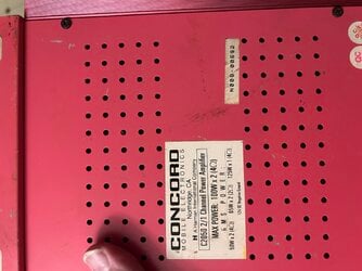

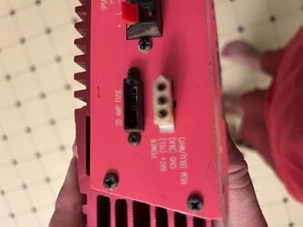

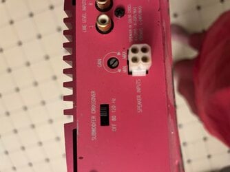

I have a Saturn Vue with a db11 monoblock running a 15" American Bass via LOC but have nothing for the front speakers. I was recently given a Concord c2050 100w amp that's from the 90s and noticed how small the + - rem wire connections are. Looks like there is a female Molex connector on it already but I'm not sure which gauge or size it is. I have been all through google and ChatGPT but can not find any type of information for it at all, yes I know it's old. My hope is that someone here will have some sort of information for it, an original manual would be ideal but I know it would be hard to come by. I'm also curious to know if I can run more than one LOC to power multiple amps.

looks like one of these:
that's just the housing and contacts. you need a crimper and wire to complete it.
up to 18 awg. 100 watt @ 12 volt is 8.3 A, which 18 awg can take no problem. Now, some old amps were very underrated (to help audio competitors stay in low watt limit classes before they started clamping the actual power), doubt this is one of them though. A lot of old amps were also overrated (like many today).
If you want more, I'm sure if you get the crimper for molex and the contacts for the connector you can jam a 16 or 14 awg in there. Probably won't do anything.
The remote wire can be 24 awg or even less. The tiniest connection between rem and gnd should turn it on, talking mA.

The amplifier is 2x50 watts at 4 ohms and 2x65 at 2 ohms. Any decent 16-148 gauge wire should be more than adequate, 16-14 for power if you can squeeze it in.
Something like these:
Find the right one, get creative, and wire up some 12-gauge copper wire for the +/- and use 16-18 for the remote and speakers.
