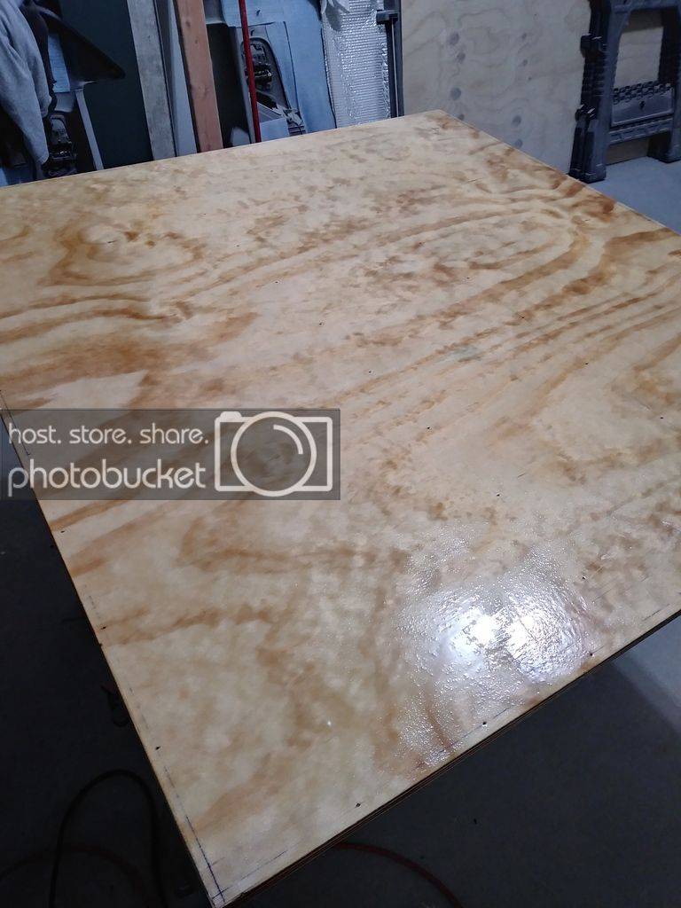

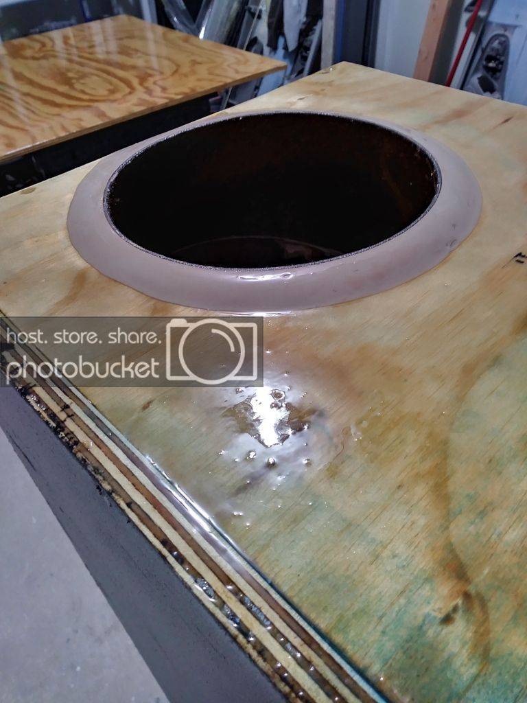

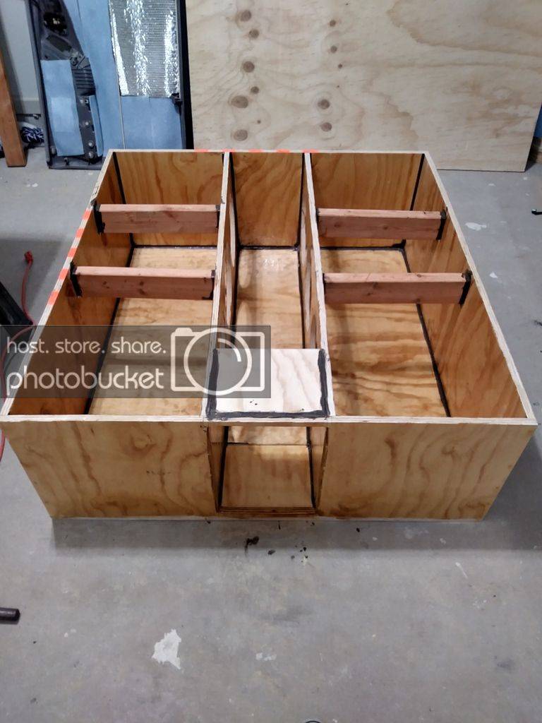

Now time for the fun part BOX building!. Call me Overkill but I like to use for deck screws and I predrill and resin the inside and outside of all my boxes

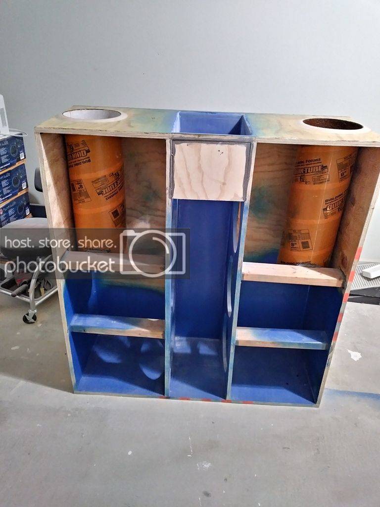

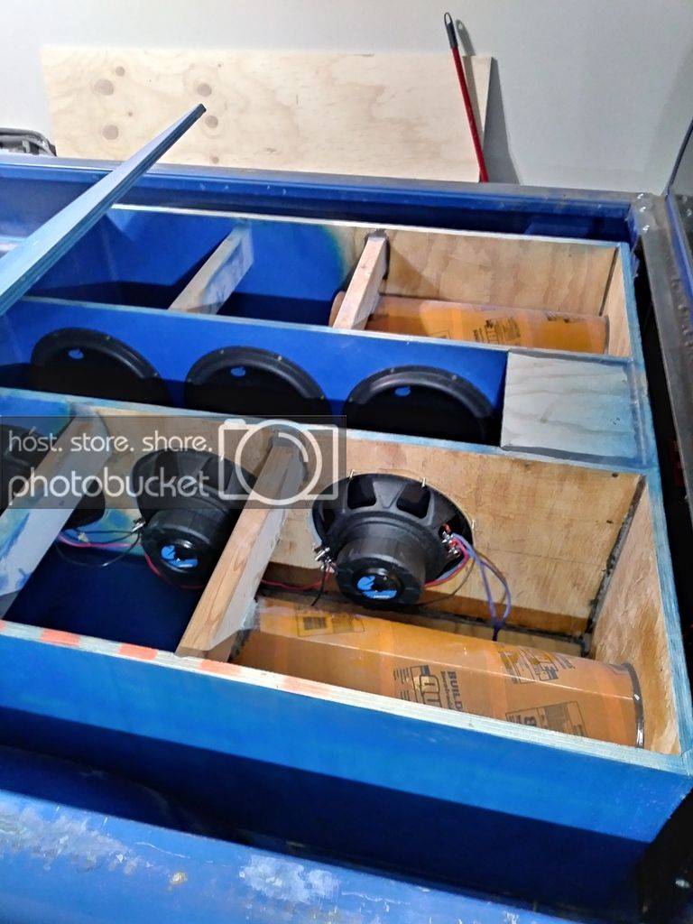

Reverse ratio 6th wont get crazy loud but should be smooth and dig crazy low. Whats the high side tuned to or do you plan to seal the middle with plexi and have a 4th. If your going to do a 4th that is insanely low tuned.

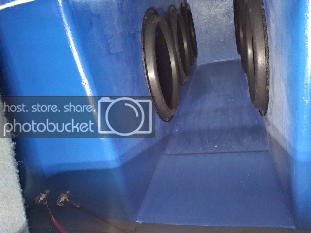

And boom fits just right. Now keep in mind that the subs are only getting about 1.75cu.ft net each in the back side and the hallway for a lack of better words is only I think 3.3cu.ft but if you want to call it a 6th order then I guess you can lol. But off of MAX 1500/1800Wrms what do you guys think this things going to hit?. Start placing your bets because I picked up a SPL-lab mini and after I figure out wtf P1 P2 and P3 are for I will do some sweeps burps and play some decaf on it.

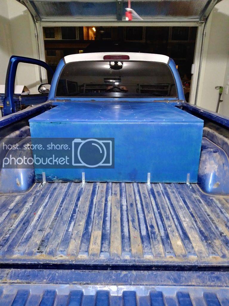

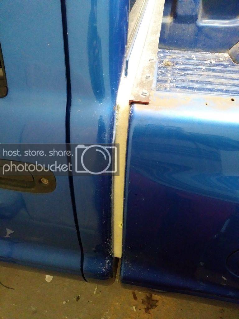

The angle iron was to increase the rigidity of the bed of the truck to make me feel better LOL and to give a nice sleeve for the box to slide into and left about a 3/16 Gap that I can just talk shut as opposed to having to use accordion gasket
Well my theory was even though it is kind of a 6th Order Box if it ***** I can just throw a piece of plexiglass over the center and turn it into a fourth order and hopefully improve the sound kind of like a safety net so I don't have to rebuild the entire box lol ... I think I did the math last week and the center Port if you would call it that is tuned to 72hz lol ...
