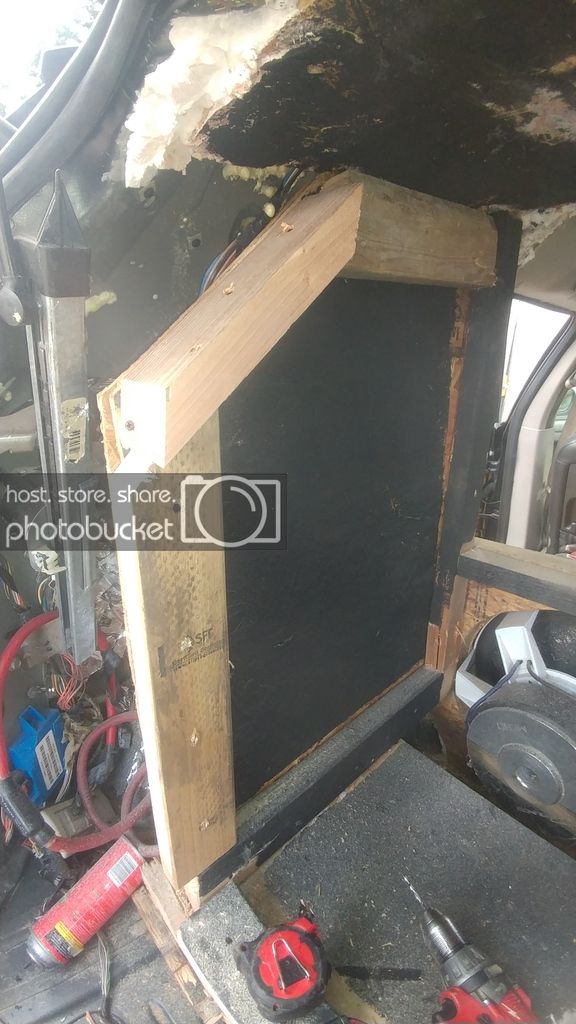

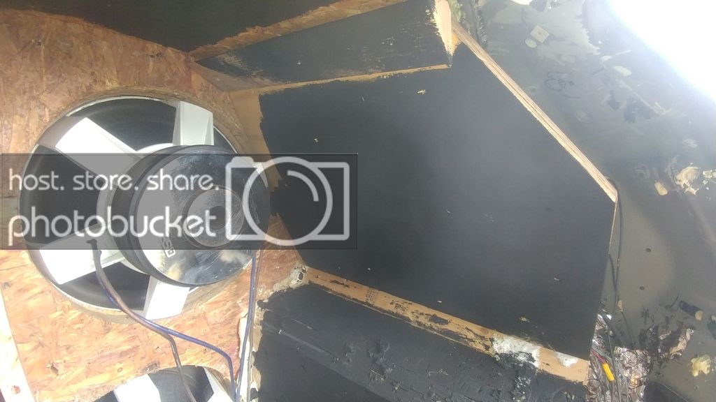

One piece instead of multiple pieces

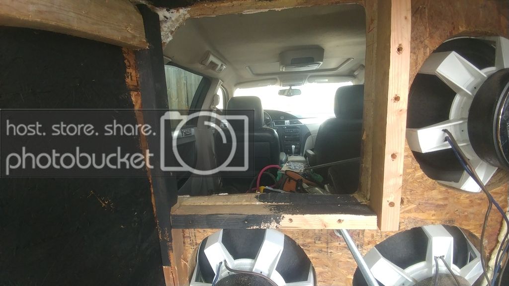

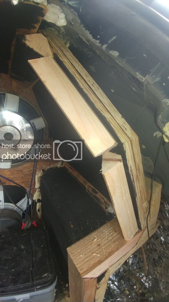

Built a frame around the port for an extra surface area to screw the port walls to it
Used some 45's for more surface area for the back piece and the piece that's angled at the top

Looking much more solid and airtight. Keep it up. Also adding more 2x4's onto the port the way you have was what I meant. You can now easily add or remove sections to adjust tuning and then use ply/MDF to make the port walls smooth and clean looking, or build inserts for various port sizes.

I'd do two layers of ply over the 2X4s you have as port depth now. My port wall is short and still flexed at 2 layers without bracing. Also adding layers will shrink port area AND if you do 45 degree cuts you can somewhat flare the openings which always helps.
Don't start rushing now! Airtight and rock solid EVERYWHERE. Even small leaks or weak spots will destroy your results.

Gotcha hertz mafia! Thank you for pointing that out! I'll add a few more screws to that piece to pull them together. And hispls i dont plan on rushing lol....I'm taking my time for sure! Especially since I'm in the middle of pulling my motor and transmission as i type this. So I'm bouncing back and forth between the two so i don't overthink anything on the wall....and what exactly do you mean flare the end of the port? I cant picture it in my head lol. Im more of a visual person.
