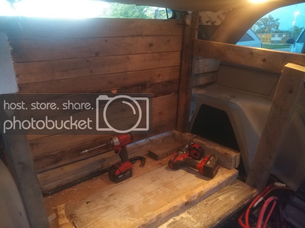

Ok thank you hispls and tymoto.... I needed some guidance as far as what i need to do next...do you think if i used just 2x4's anr filled in the gaps with glue it would be just as strong as two layers of plywood? Because it's really hard to bend a 2x4 as opposed to a sheet of wood. Plastidip is easier to paint on than tinting the windows and its darker because its paint and not film...and no my amp is the 1 ohm version. And i know not to run it under 1 ohm, i made sure i did my research on that lol.... here's what i have done so far.....
I'd have done the back last. 2x4 should have been done the long way for strength, I'd like to see one or two layers of ply on that back. You really underestimate how much pressure you'll be building up in this box IF YOU DO IT RIGHT.
If you have 1 ohm amp why not run your subs at 1 ohm?
Lol i could.....but I always seem to fry the coils when i give my subs more than rated power even if i use a multi meter and my oscope....i dont understand how people can give a 1500 rms sub 3000 watts daily and not fry the coils. How do you get the mounting holes on the baffle to line up on all the layers? I have a jasper jig but my cutting bit is only long enough for one sheet at a time. Ok I'll do two layers on the back, and i can switch the 2x4's and make them vertical. And yes i have no clue how much pressure they'll output ha. But im very eager to find out. Ive sat in a crx with two team rockford 15's and four memphis 2500's and it did 155 legal sealed
As far as the port goes you can make a large slot port and use custom made bolt on ports with wood to change frequencies on the fly.
I forgot who else used 2x4s for an entire she'll then placed 3/4 plywood on the inside and it came out pretty strong with no need for double baffles all around.
