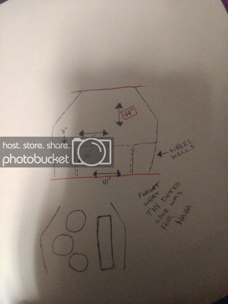

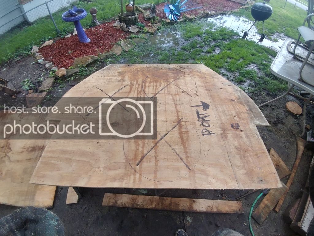

Here's my idea....all input is welcome....the second picture is to show you the actual shape of the inside. And yes I realize the layers are off. I messed up the alignment lol....tell me if this will work or not as far as the construction of it....seal off the front, triple layered bottom, triple layered back, and for the sides since I can't get the wood to mold to the interior just let the interior act as the sides and seal up the back from the inside through the front. And if I need to subtract some cu ft I can use 2x4's and just add X amount of layers until it's right.
Better. What's your plan to adjust tuning or box volume after it's assembled?
Definitely need more baffles and thickness.

if you do like i told you you can save alot of woods and do double baffle. the loudest cars i've seen often did this including me.
it doesn't have to be but 4 or 6 inches deep takes up next to know room and braces the box 10x better than stupldly stacking baffles..
