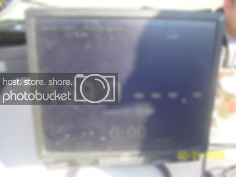

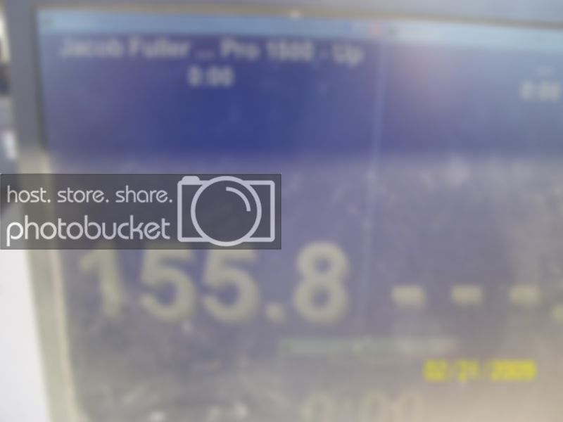

Some testing @ an SPL show with two 15" Nightshade D2 (original stock, short coil version):
* At the windshield, legal dB Drag Style

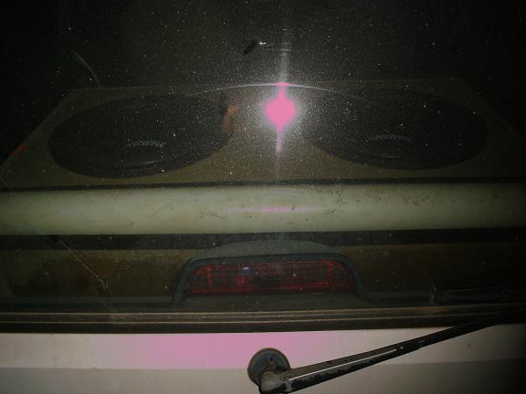

* In the passenger side kick panel with the driver door open "Outlaw" style

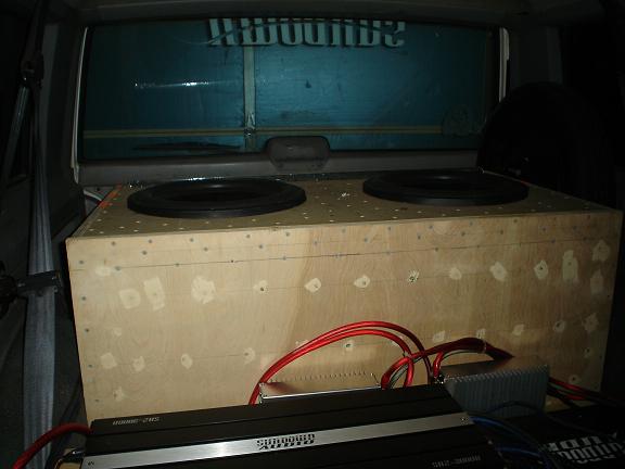

* New box for two 15s
* Another shot
I have four SAZ-3000Ds @ 16v.
If I go down to two SAZ-3000Ds I only lose 0.8dB from the above - I believe I am running into a battery limitation as I only have 6x Powermaster D1000s //content.invisioncic.com/y282845/emoticons/smile.gif.1ebc41e1811405b213edfc4622c41e27.gif

Box is tuned to 36hz 55 square inches of port the rest of the shows he will have the car idling so i don't think low voltage will be an issue and he is replacing the front stock battery with a orbital so that will help a ton also..
