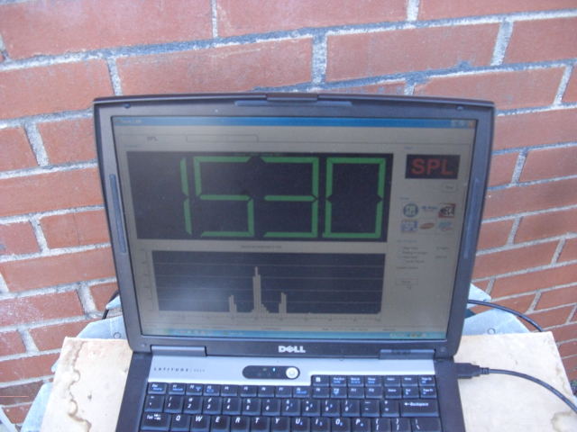

Best we could get with two amps and a charge all night long on the batteries. We hit 154.8 several times the night before but only did this score once with a FULL charge.

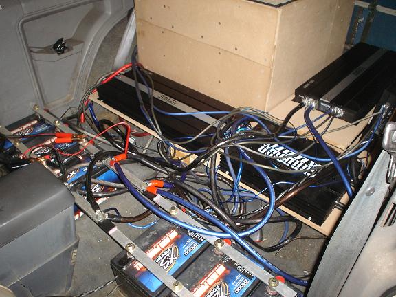

Tried four amps:

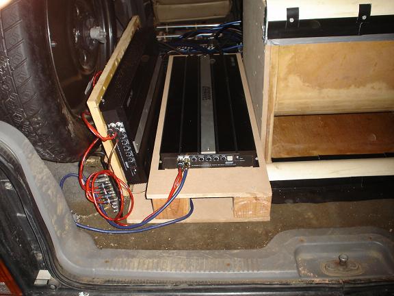

* Three amps back here, one under the other on the rack.
* Wire mess of epic proportions
We did NOT gain from four amps. The amps were at double the impedance of before and I know my battery bank is not enough for all four... BUT I think the sub just completely ran out of excursion, it is MOVING. We did not damage the sub at all with four full volume burps on four amps, though //content.invisioncic.com/y282845/emoticons/smile.gif.1ebc41e1811405b213edfc4622c41e27.gif

Stock 15" D2 Nightshade - Short Coil, Stock Cooling, 3 spiders
Power = 2x SAZ-3000Ds strapped @ 1 ohm (internal strapping)
I matched my best score with the "Monster" design prototype with the stock Nightshade.
This confirms my theory that the Monster design *NEEDED* a ton of power to get loud so we will continue work on the Monster design to increase efficiency AND power handling. Of course... the Monster would take this sort of power continuously and the stock Nightshade for burps only - so it is not quite apples to apples!

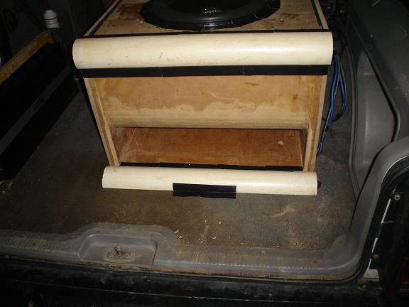

For those that may not be familiar with my box:
* This is before I moved it to the left and went to three batteries on the right, but you can get the idea of the enclosure.
* Another shot

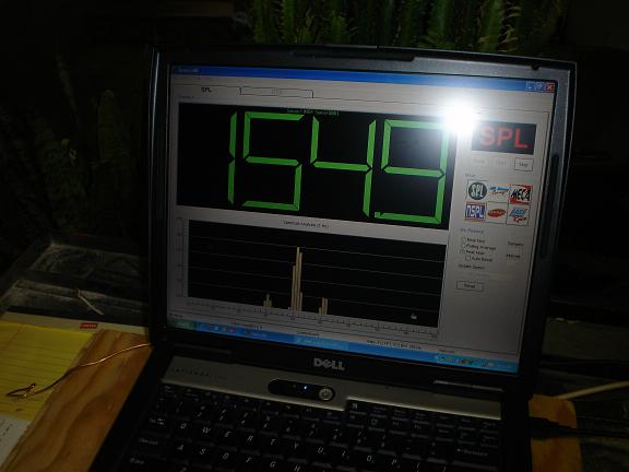

Re-built a Nightshade with a bit different spider setup and a bit different coil setup (a little longer) and made a new high score:
A little bit has changed since before too:
Box is on the other side (not any louder, but made for easy mounting of the amp you see to the left). And I added those PVC pieces.
