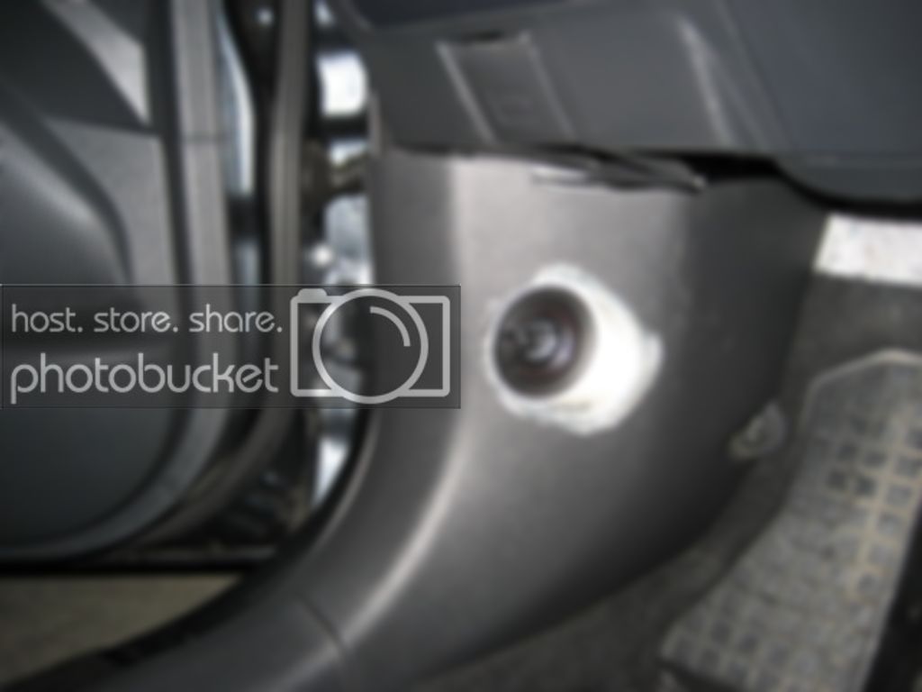

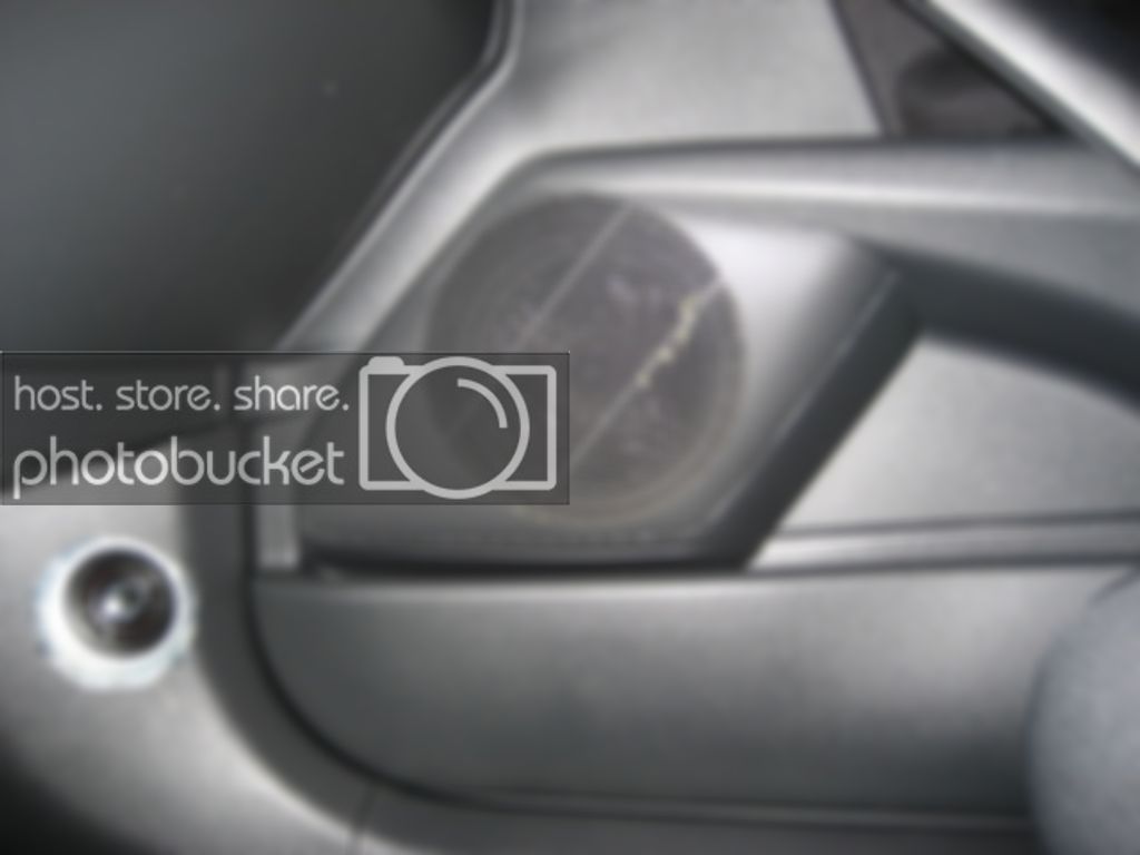

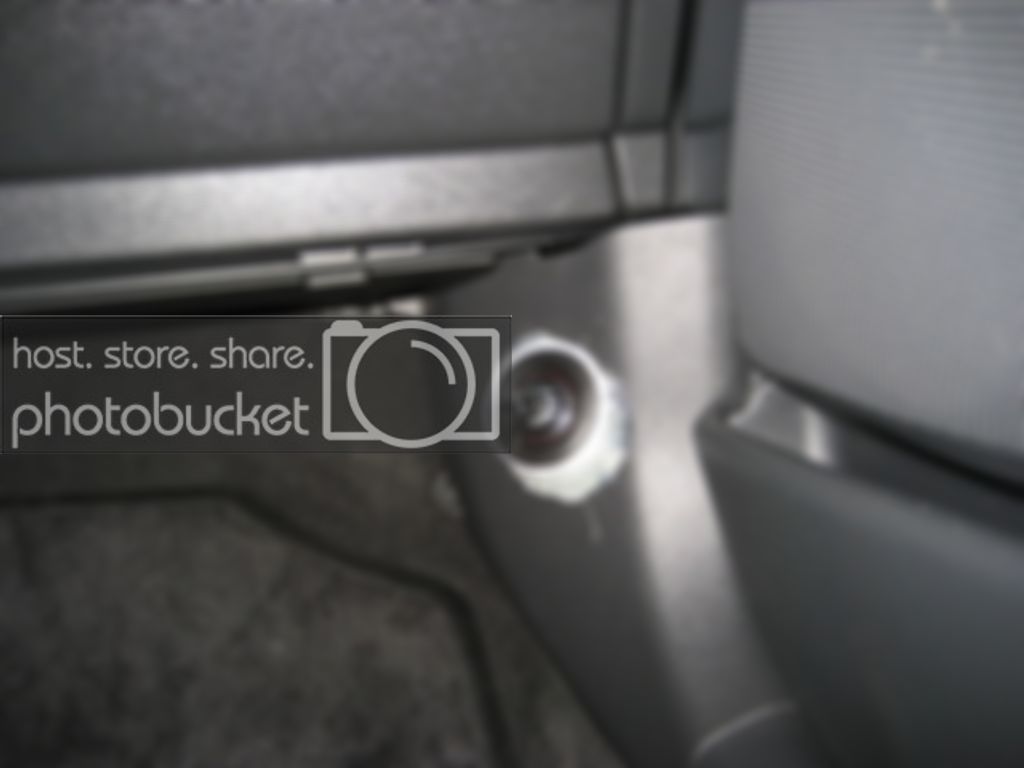

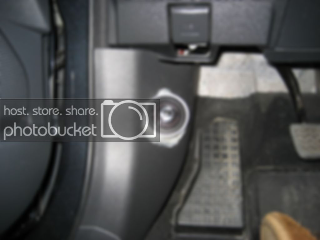

tonight when i got home from work i got them aimed 100% on axis. aimed them at the center of the drivers side headrest at ear level. sounds soooo nice! better than ever. amazing detail without overpowering the mids. sounds really smooth, yet still detailed up top.

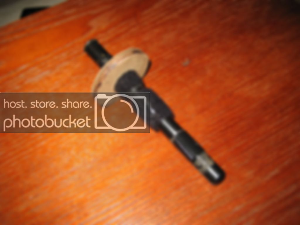

to aim them i got a little creative with a laser pointer and a piece of mdf. i cut out a piece of mdf that would fit into the PVC fitting and then drilled a hole in the center of it and stuck the laser pointer into it. i then aimed them and took out the hot glue gun and went to town. the are rock solid!
just need to get some body filler or putty or something and blend them in, and then paint them up.
a pic of my homemade aiming tool

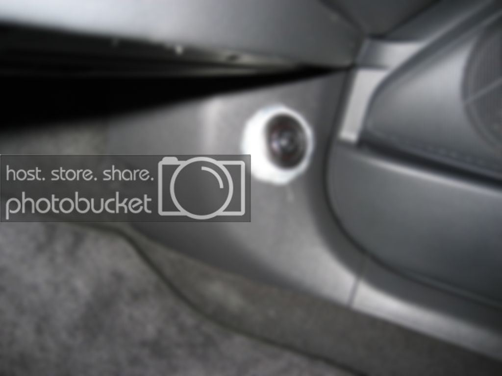

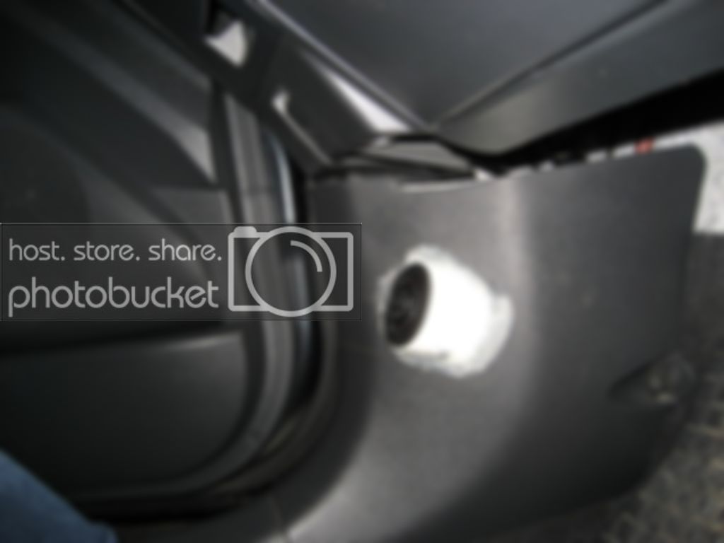

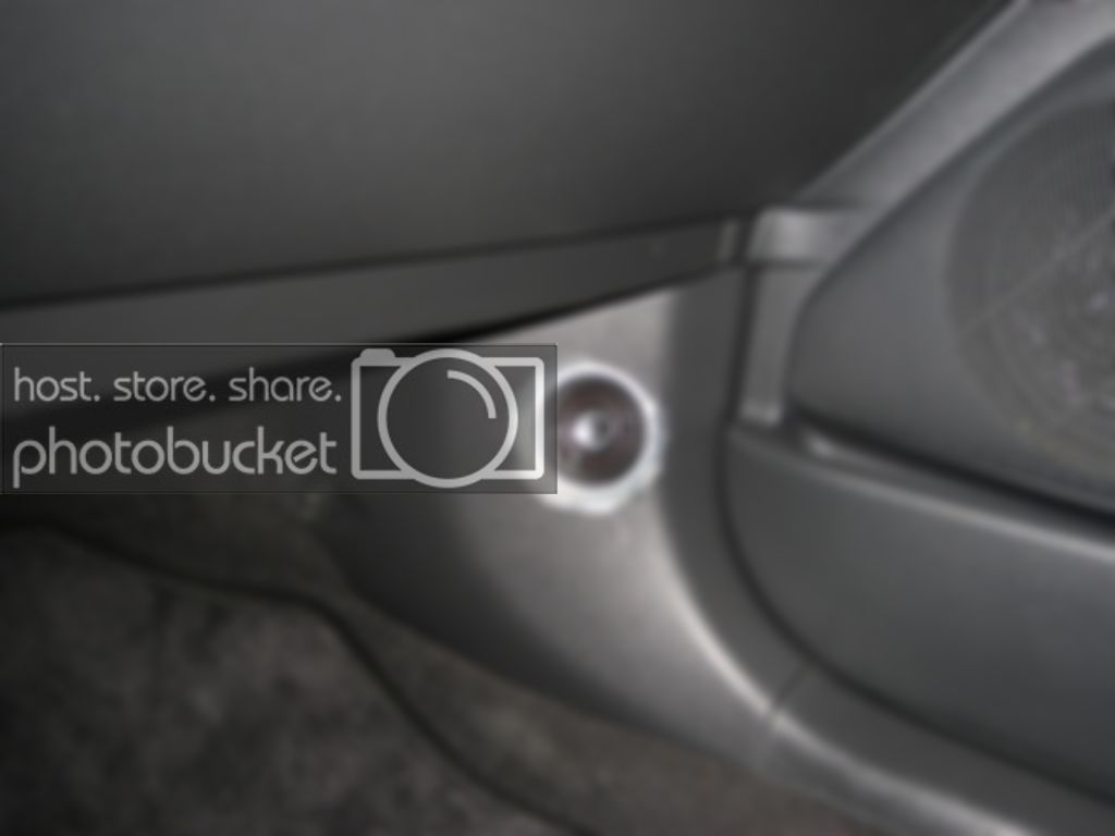

a few pics of them as of now. hopefully this weekend i'll get them lookin nice.

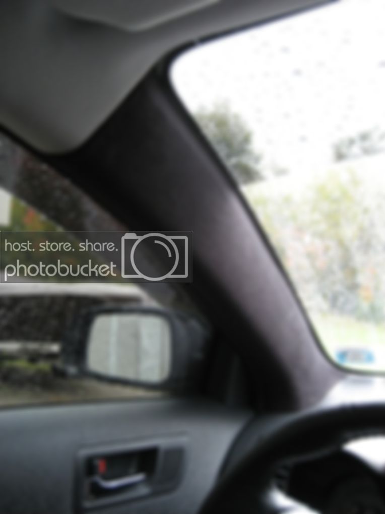

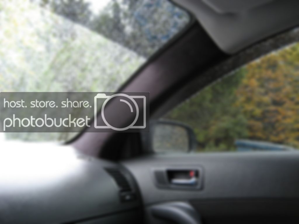

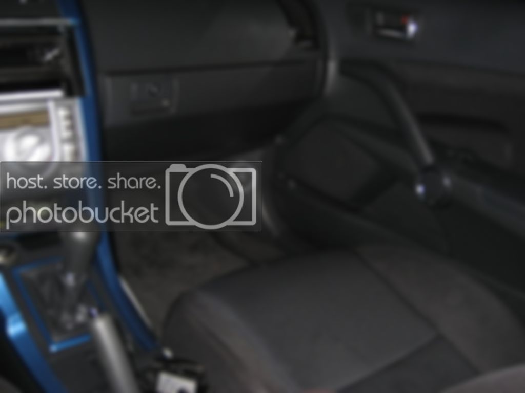

just got done re-sueding the pillars back to stock w/o the fugly pods. //content.invisioncic.com/y282845/emoticons/smile.gif.1ebc41e1811405b213edfc4622c41e27.gif
looks pretty pimp!
Looks good back in black man //content.invisioncic.com/y282845/emoticons/smile.gif.1ebc41e1811405b213edfc4622c41e27.gif
