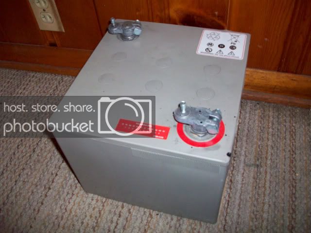

two different batts should work out fine in the back, theyre just feeding off each other. and the sub looks **** beautiful. the amp was a good price, and if you have electric to back it up, its ok.
i will have enough sundowns for the both of us, but he doesnt get any.
Figure the batteries should be fine. Keeping the Kinetik closer to the amp for faster discharge (maybe?).

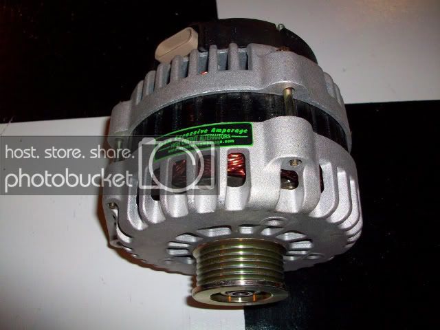

should help with the current hog =)

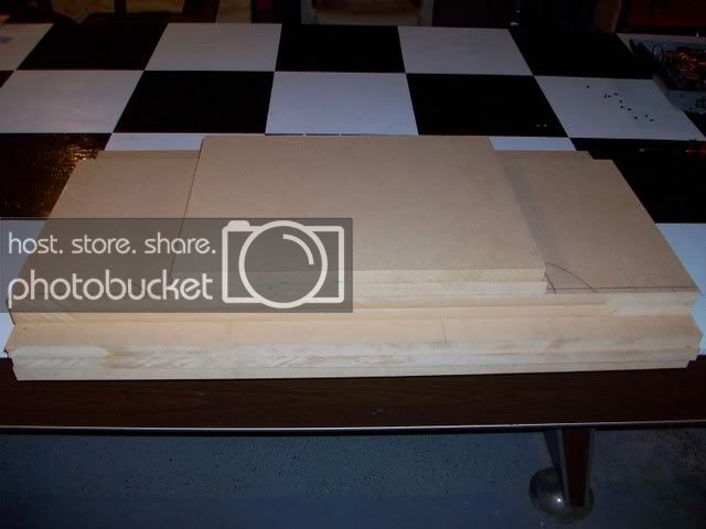

Waiting on the sub to find exact measurement so I can cut the 2nd baffle. Want it to be a real tight fit.

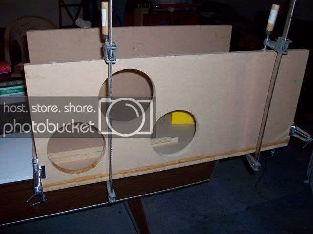

Got the holes in front cut for the 3 four inch aeroports. Don't have exact specs with me on box but along the lines of 4.1 cubes after port/sub/brace displacement. Sub up port back. Double top baffle w/ flush mount. Round-over bit on top and sides of box. 1" Oak doll rods for bracing. Not sure on color yet --gonna wait on the sub to arrive and see what I think.

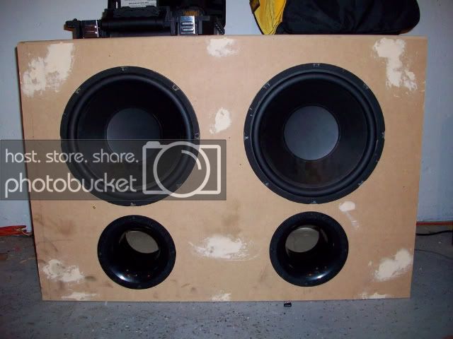

Some progress...
Hoping to finish box tomorrow... if I get lucky and the sub arrives. If not, I plan on wiring up the pioneer dehp860, iPod connecter, and remote gain, and then finishing up the CDT comps.
