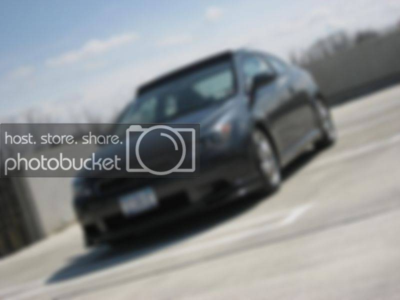

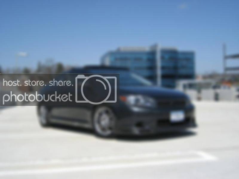

first i will share a couple pictures of the car itself, since i also care about how the exterior looks. :)
